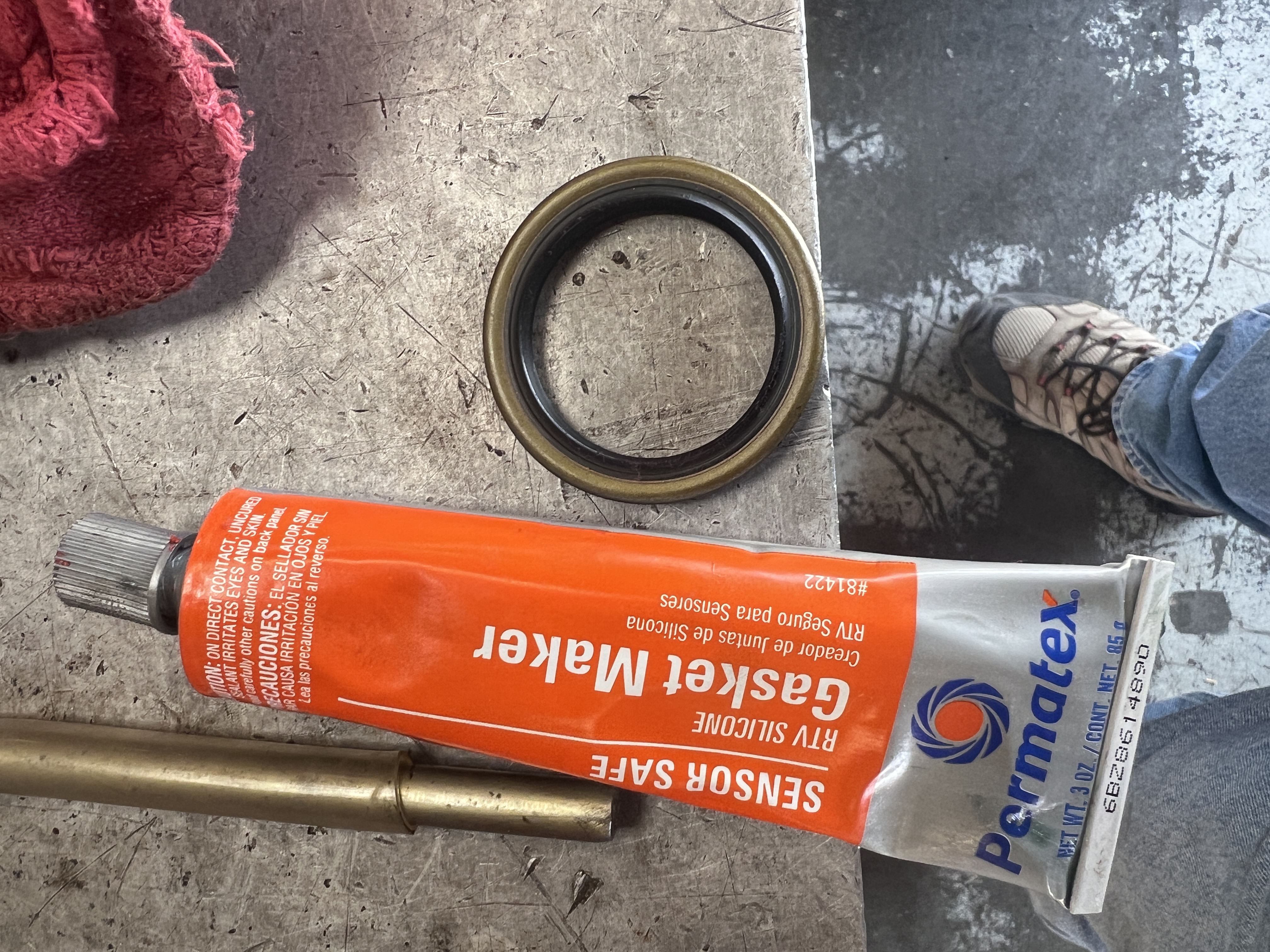

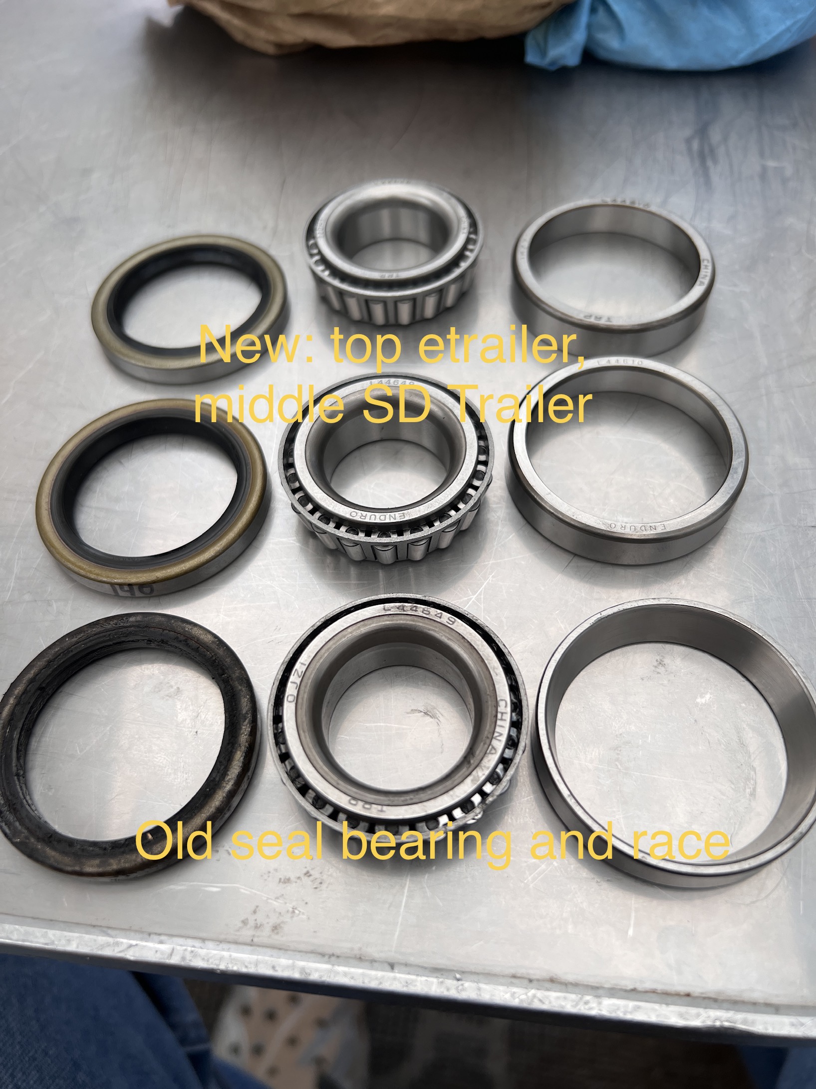

Here is what I ordered from etrailer following Cary's advice and link, and compared seals by size to be sure see pic. The etrailer kit is now my spares.

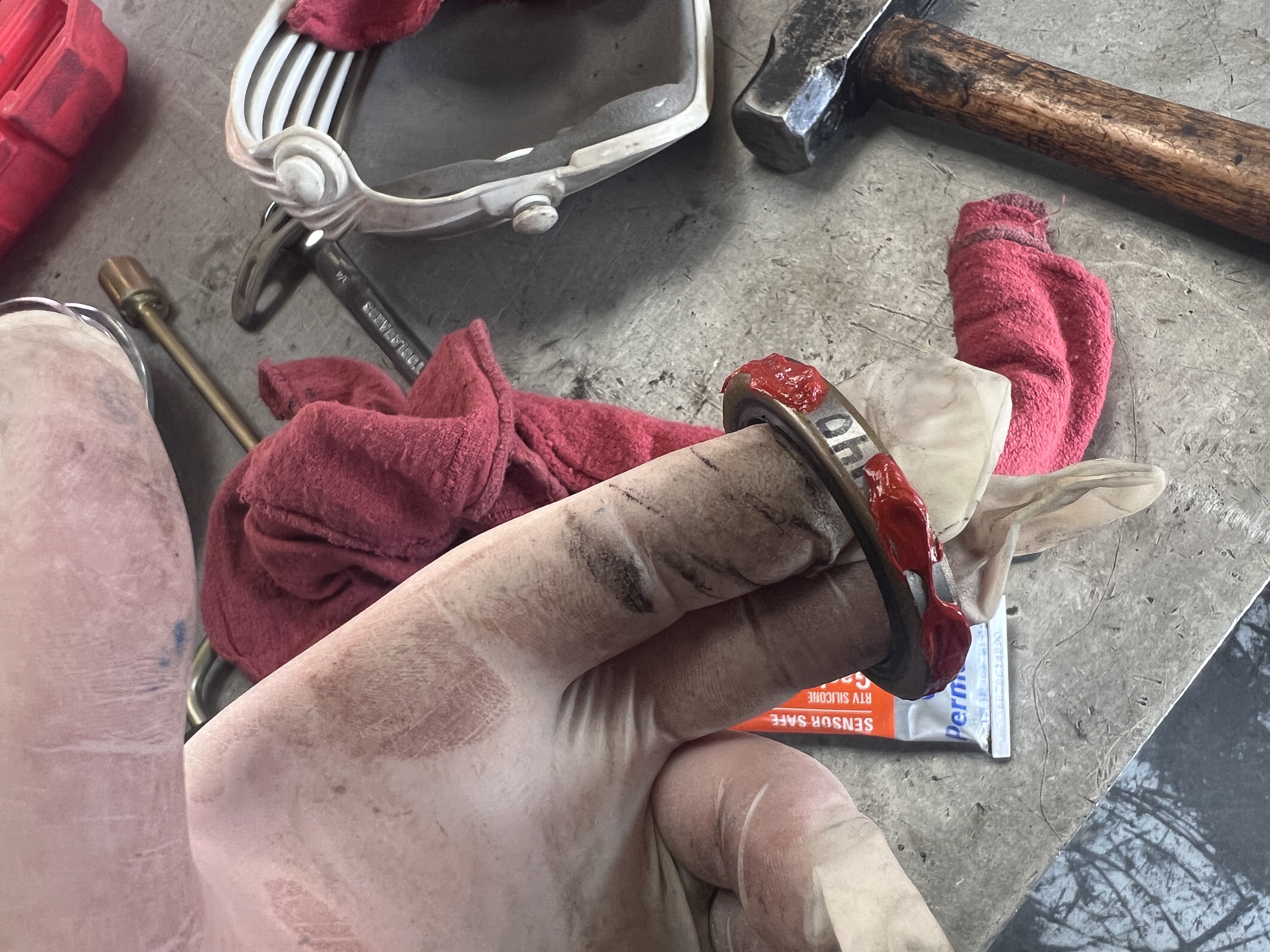

Also, see the "red tip hot sealant" I used as referenced in the Dexter video- what goes on the outer edge of the seal.

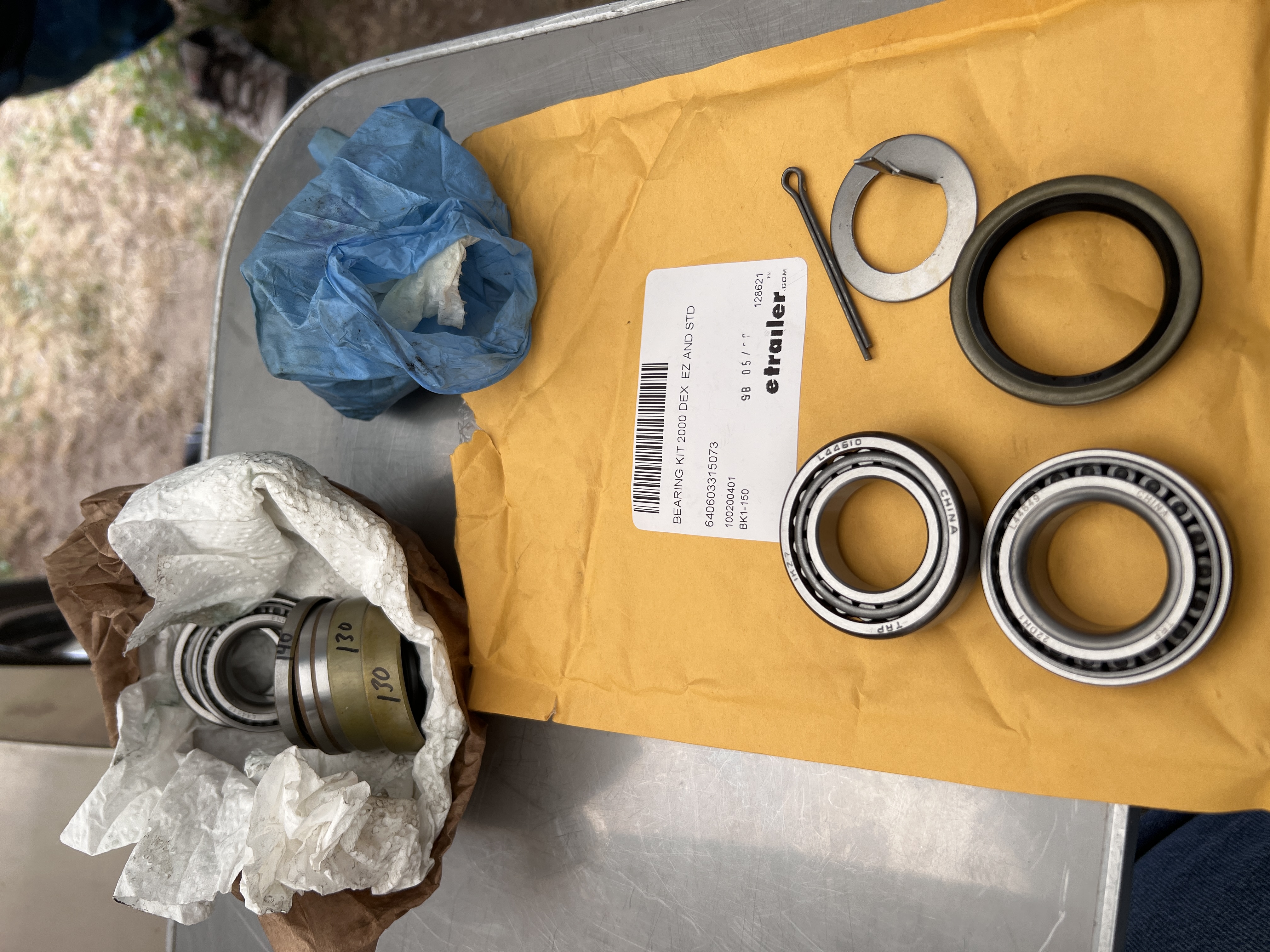

This is a wheel bearing replacement kit I put together in 2019. (first post picture, second post parts list). I carry it in the under floor storage. Thankfully I’ve never had to use it. Let me know if I am missing anything.
Emergency Wheel Bearing Kit

Ironically enough, those are the seals I bought....I have nothing against etrailer, but amazon's shipping was faster. As it turns out, I could have waited...life stopped me from doing any of my plans this weekend!
I assume the seals and the bearings are sized similarly...so should be OK...I hope. I'm looking forward to doing the job, but it probably won't been for another week...I've go tan expedition planned next weekend!
