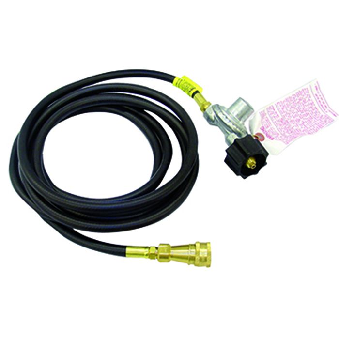

New Big Buddy fall 2023

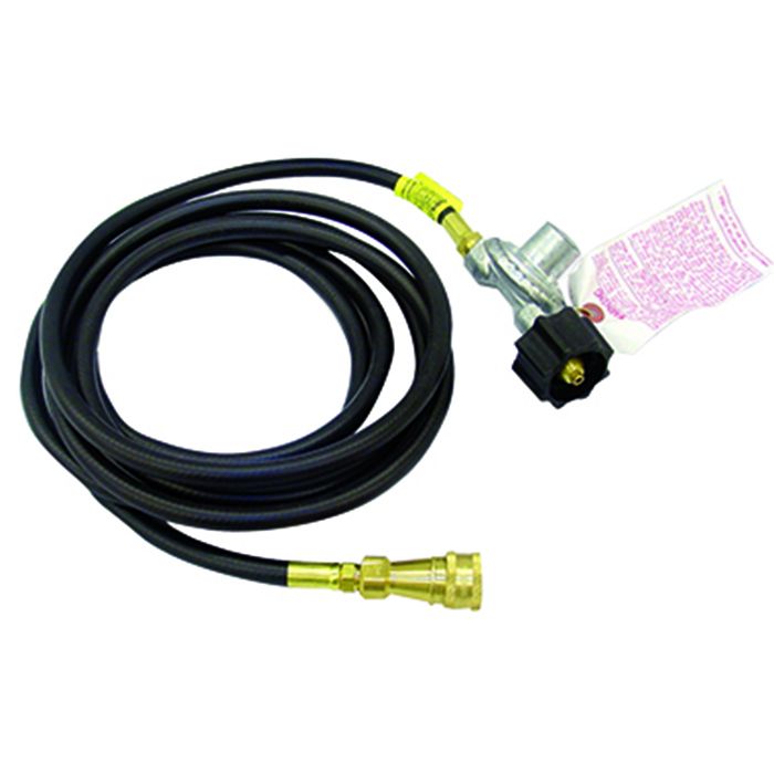

Mr Heater hose and regulator:
... with the tank connection removed and replaced with a male QC that mates with the CI side port, which registers 20 PSI out. This device also works "as purchased", meaning that I could go directly off a tank into the heater QC, as it was designed to do. However... the hose was too short to make it from the CI tank at the front all the way to the back of the trailer where the heat was needed. And I didn't want to buy/bring a second tank, or try to extend the long hose any further. Hence the need to find a way to go off the side port.
Mr Heater hose with filter and without regulator that goes direct from a spare tank to the 1 lb bottle port:
All of these above combinations and permutations work. What definitely doesn't work for me is the CI-supplied short hose from the 20 PSI side port to the 1 lb connection on any version of the Buddies that I've tried. (I've since given away my "middle" Buddy, without the QC, as there was no way for me to get it to work off the side port).
All of my Buddy versions have worked flawlessly with a 1 lb bottle attached. Which, unfortunately, is the configuration we were all trying to avoid.
Heater is a Canadian brick and mortar sale. Hoses are Amazon buys.

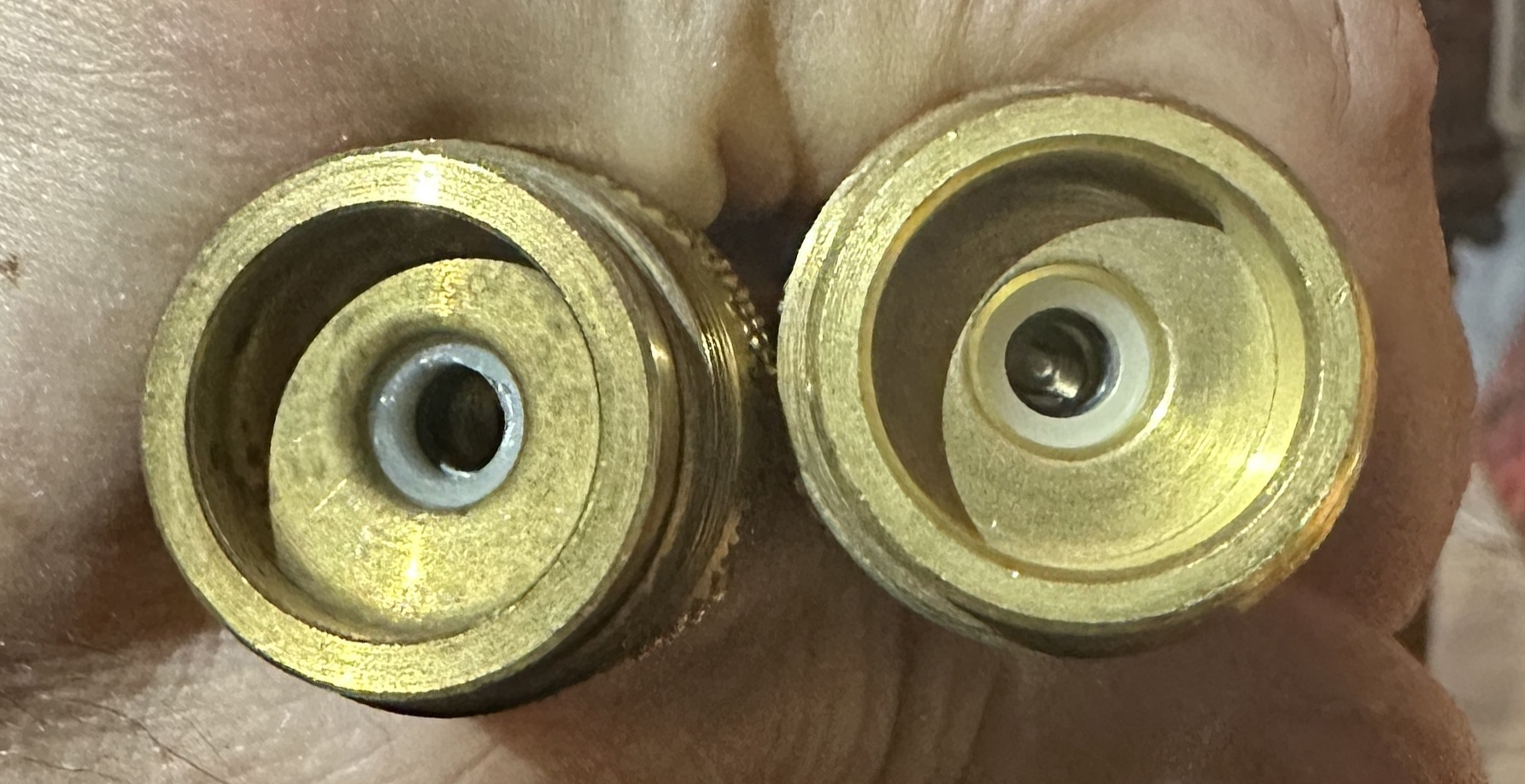

Going for a stretch, does your short CI QD hose have the Schrader valve in the outlet? (Does it have the small pin like a bicycle tube)
Let's not forget Bob's question here by the way. This type of 1lb bottle replacement hoses would normally come with a Schrader valve in them. The gas appliance has a pin in the fitting that pushes in on the pin in the valve to open it up when connected. What we found out years ago is the length of this pin varies from manufacturer to manufacturer and that the connection hoses don't always work consistently when it has the Schrader valve in place. So, for many years we have been removing the Schrader valve from the ends of the hoses we provide with the Camp-Inn. If you have a hose that has a Schrader valve in though it may cause inconsistency issues and I would recommend removing it. Take a peek into the end of the 1lb bottle end of the hose to see if has a valve or a open hole. The O-ring and the plastic ring holding the O-ring in place should be there but the valve should be absent.
Cary
Curiouser and curiouser...

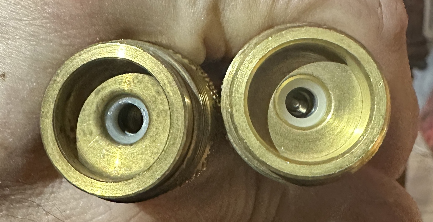

Indeed the pin is gone on the CI hose (left side) but present on the Mr Heater version:
Unfortunately, my MH hose is crimped at the other end (with a tank connection) and I have no way of spinning on a male QC to connnect to the side port to see if the presence of a pin (combined with a 20 psi regulator) can be a functional combination.
Maybe somebody has these odds and sods to give it a whirl?
Excellent picture showing the Schrader valve in position vs the valve being absent. Removing the valve requires a Schrader valve removal tool, it is a cheap common little tool.
We have also wondered if that valve (when it is properly opening all the way) is still maybe a flow restriction for larger gas appliances. Probably depends on the pressure.
I would be sure to do the Buddy testing with the Camp-Inn hose with no Schrader valve and not with a hose that has a valve in it. Just to remove another possible variable.
