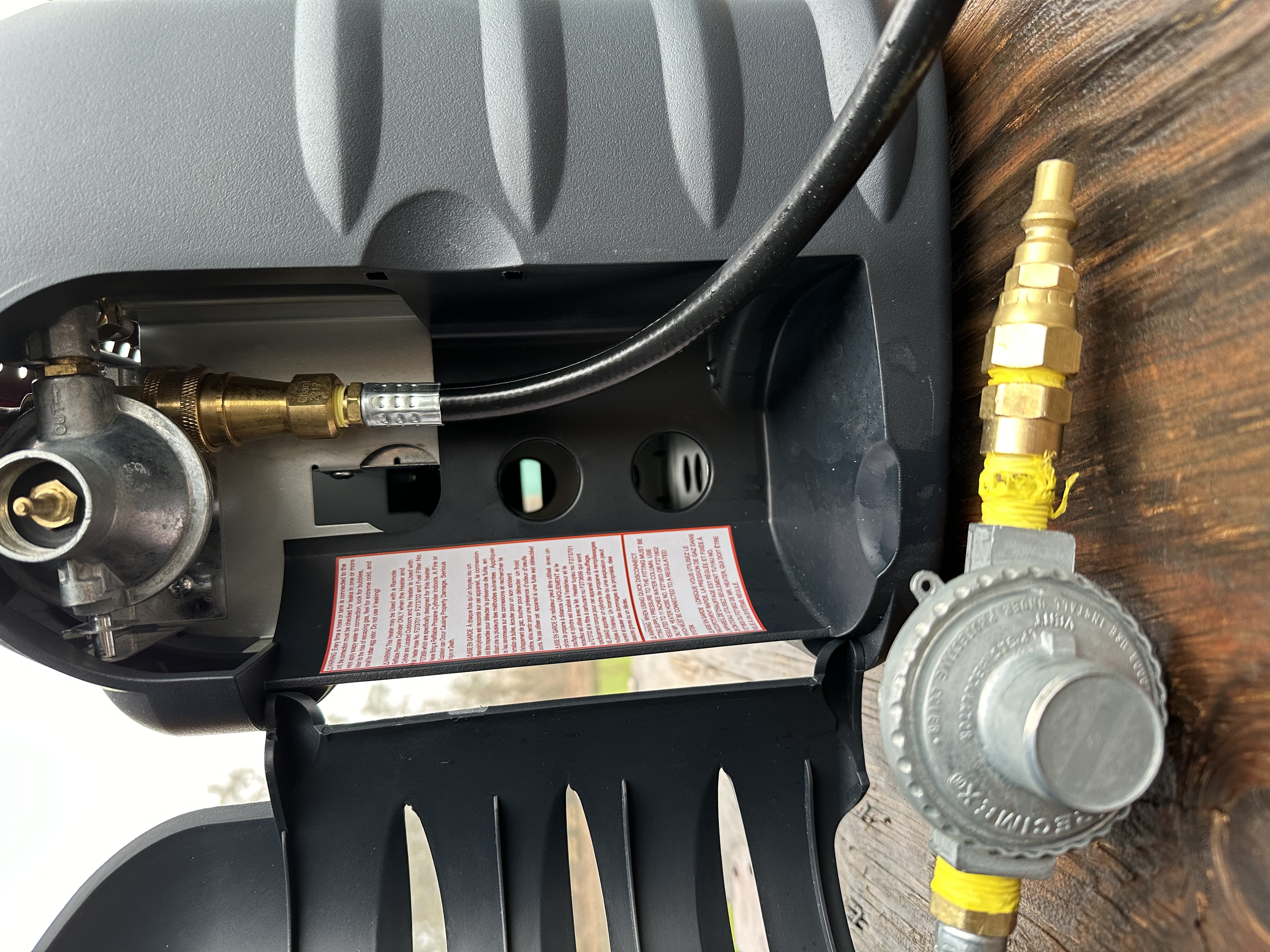

My experiment today confirmed Seth's experiment re the pressure relief at the Big Buddy. I connected the Big Buddy to the side port using this configuration of hose and fittings after I had taken the regulator out of the system.
I turned it on at the tank and got a huge blow-by at the pressure relief valve inside the Big Buddy.
A check of the specs for the Mr Heater hose regulator confirm that, despite its appearances, the "Precimex MOD 5000" (the round silver thing in the photo) delivers only 11" WC to the unregulated QC inside the Big Buddy, which is only 1/50th of the flow that is available at the side port, even when using the 20 lb CI regulator on the tank. No wonder both of us were getting blow-by.
I have yet to to fully reassemble everything, with the Mister Heater regulator in line. When I do, this is what it will look like:
It's just missing a male-to-male union to connect the flared adaptor to the regulator.
I removed some extraneous parts from the regulator (so that it is just a regulator with 2 female ends) and somewhat simplified Seth's setup. I expect it to work like Seth's did when I get the union. Christmas Eve isn't exactly the time to go shopping for stuff like this.
My parts are slightly different from Seth's because I started with a Female QC, whereas he had a Male QC. So you could simplify my set-up even further, eliminate the flare and reduce the number of parts yet again.

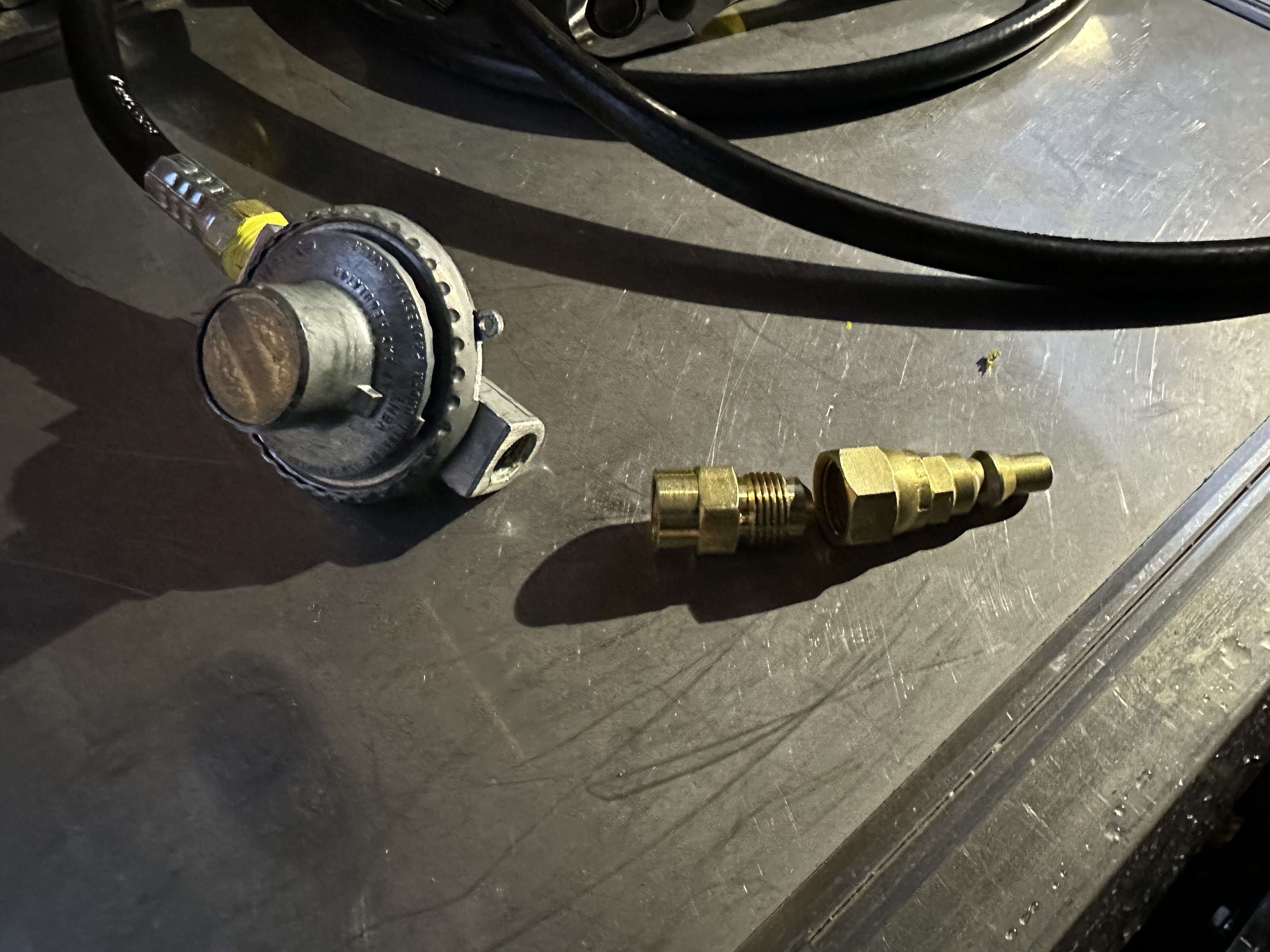

Here is my final (?) version, per Steve’s post above:
full
This is for connecting the CI gas outlet to a Big Buddy’s quick disconnect inlet. Doesn’t work with the Portable Buddy.

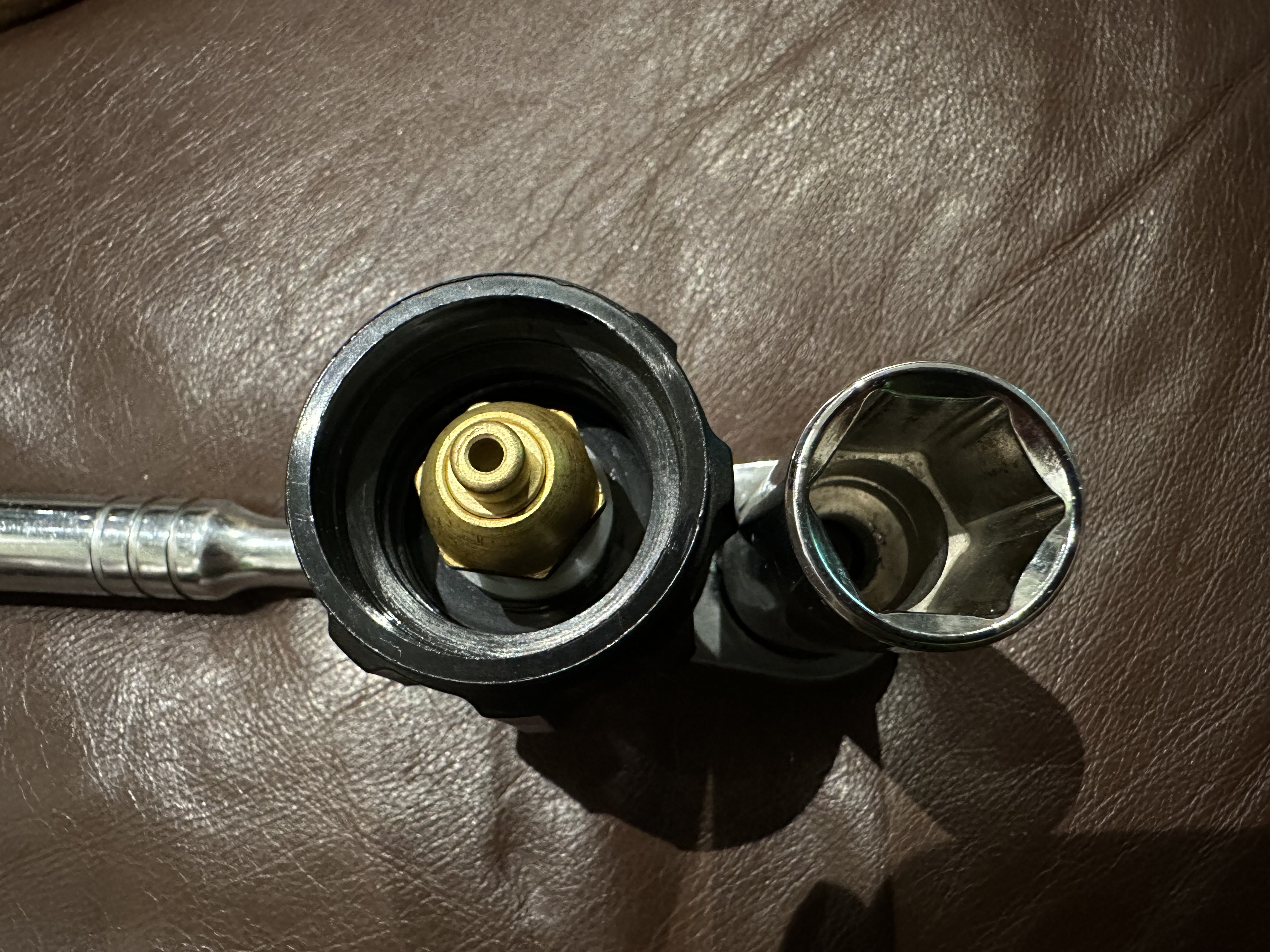

In the photo we are looking at Mr. Heater’s F271803 12’ Big Buddy Hose with regulator (link) with its pol/qcc1 connector removed, and replaced with the Sturgis Quick-Disconnect Propane Adapter Fitting Model 250 (link) that Cary linked to earlier in this thread.
It turned out to need the 1/2” drive long breaker bar with 11/16” deep socket and a padded bench vise to pull off that pol connector, and lots of cleaning to get the “dope” sealer out of the threads so I could replace it with yellow teflon tape. You don’t want any schmutz in your gas line!

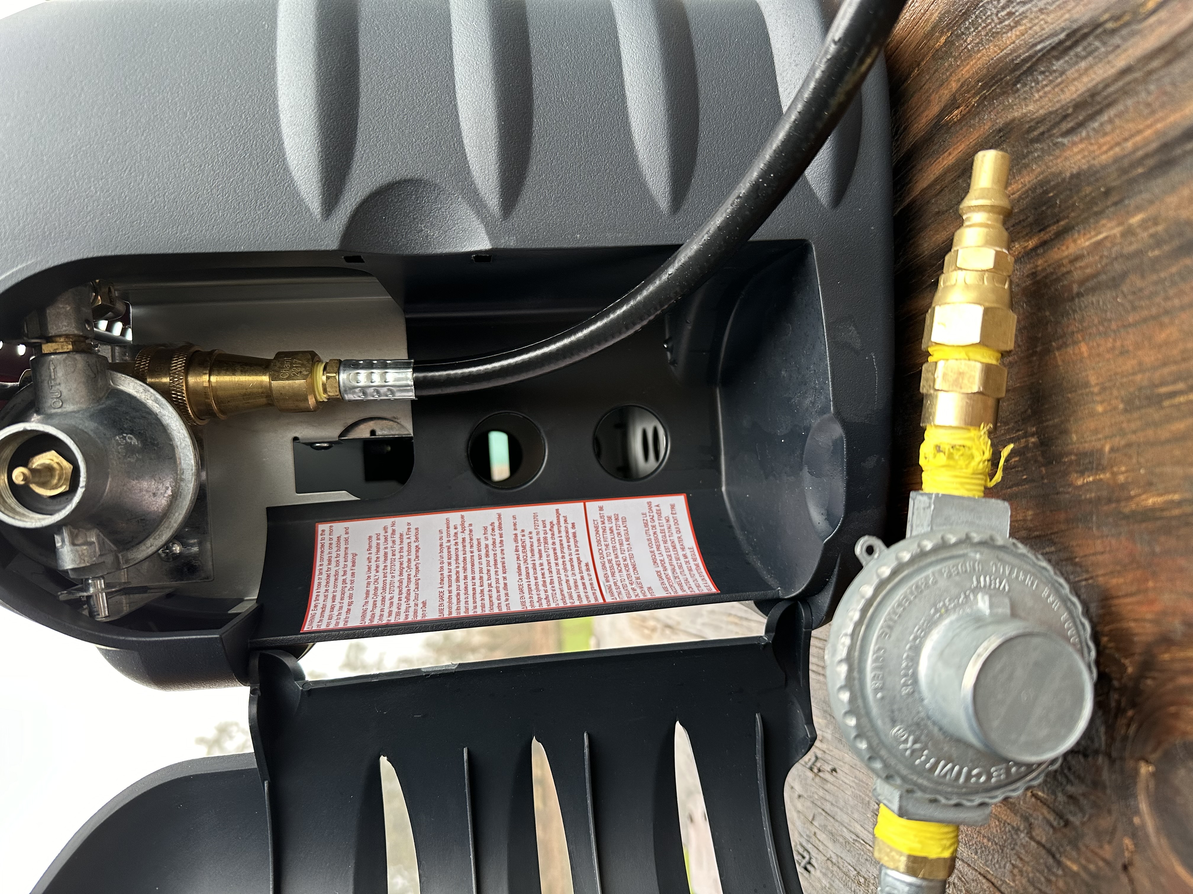

This is the only configuration that works for me (and Seth) off the side port:
i.e. 20 psi CI regulator on the tank, combined with the in-line 11" WC Mr Heater regulator.
The Mr Heater hose came with the regulator and the proper female QC for the male QC on the Big Buddy. (Smaller or alternate versions in the "Buddy" line don't have this male QC.) All we had to do was add a male QC for the side port.
My lay interpretation of your set-up, and your success, would be that your CI regulator has possibly failed completely or partially, or it is allowing much greater than 20 PSI to flow to the trailer, and ultimately to the 1lb connector. Given how my internal regulators on two units behaved at high pressure (success) and low pressure (failure), I suspect that you are delivering a higher pressure directly to the heater than either Seth or I were doing out of the side port. I would test your Buddy directly off the tank, both with and without the CI regulator. If you are getting the same lighting and performance success under both scenarios I would think that's a pretty strong indication that your CI regulator is possibly not doing its job any longer. Which could have implications for the rest of the LP system in the trailer. Maybe Cary can chime in on this.
