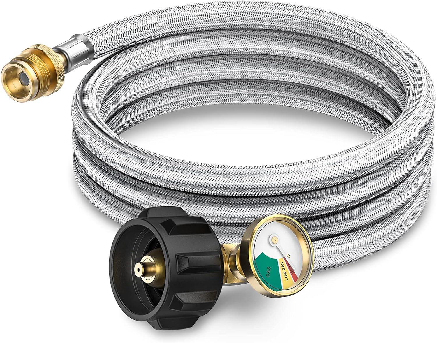

Bob had the answer. I wasn't able to test his theory until I got this delivered today:
I spun off the tank connection and spun on the QC for the side port:
This particular hose has a brass 3-way connection that allowed the QC conversion. Most hoses without the gauge don't allow you to mix and match like I did as all of the connections are crimped; all three on this one were threaded. This particular gauge is high pressure, for the tank, pre-regulator. So it is useless at this point in the system. I will be replacing it with another 0-30 psi gauge that I have from my absolutely ridiculous pile of new spare parts and brass fittings.
For some reason the CI QC hose with the pin removed works with my Coleman BBQ but not with the Mr Heater heaters.

What does the inside of the heater end connector of your shiny new hose look like?
Shiny one is just like the one on the right. Identical. The left side is the CI-supplied hose (with the pin removed) that I couldn't get to work on any MH Heater under any circumstances:

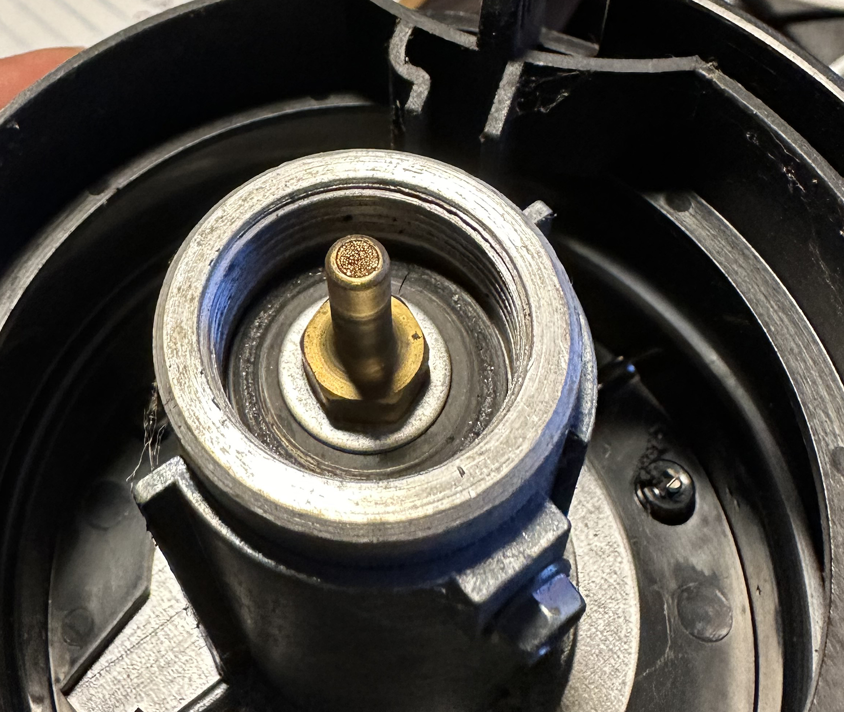

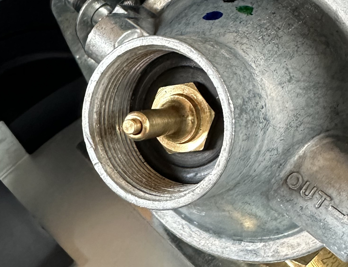

So, here is a question for those who have a Buddy heater. Does the 1lb propane connection fitting have some sort of Schrader valve in it? Are they somehow having two Schrader valves push against each other? Normally a gas appliance has a pin with a small hole in the end that pushes on the Schrader valve in the bottle or the substitute hose to open it and allow flow. The length of the pin in the appliance fitting is what causes conflicts if it is unable to properly push open the valve in the hose. If it is relying on the pin in the bottle Schrader valve to open up some sort of valve in the appliance fitting then that would explain what is happening.
Could someone take a good look at the inside of that bottle fitting on their Buddy heater? Picture maybe?
Hmmm... pics not attaching but there is a pin 0.67" long with a mini compression pin that looks like it needs to be depressed in order for gas to pass.
Without the opposing "pin" in the hose section to compress it, nothing will get by, I imagine.
Will keep trying to attach.

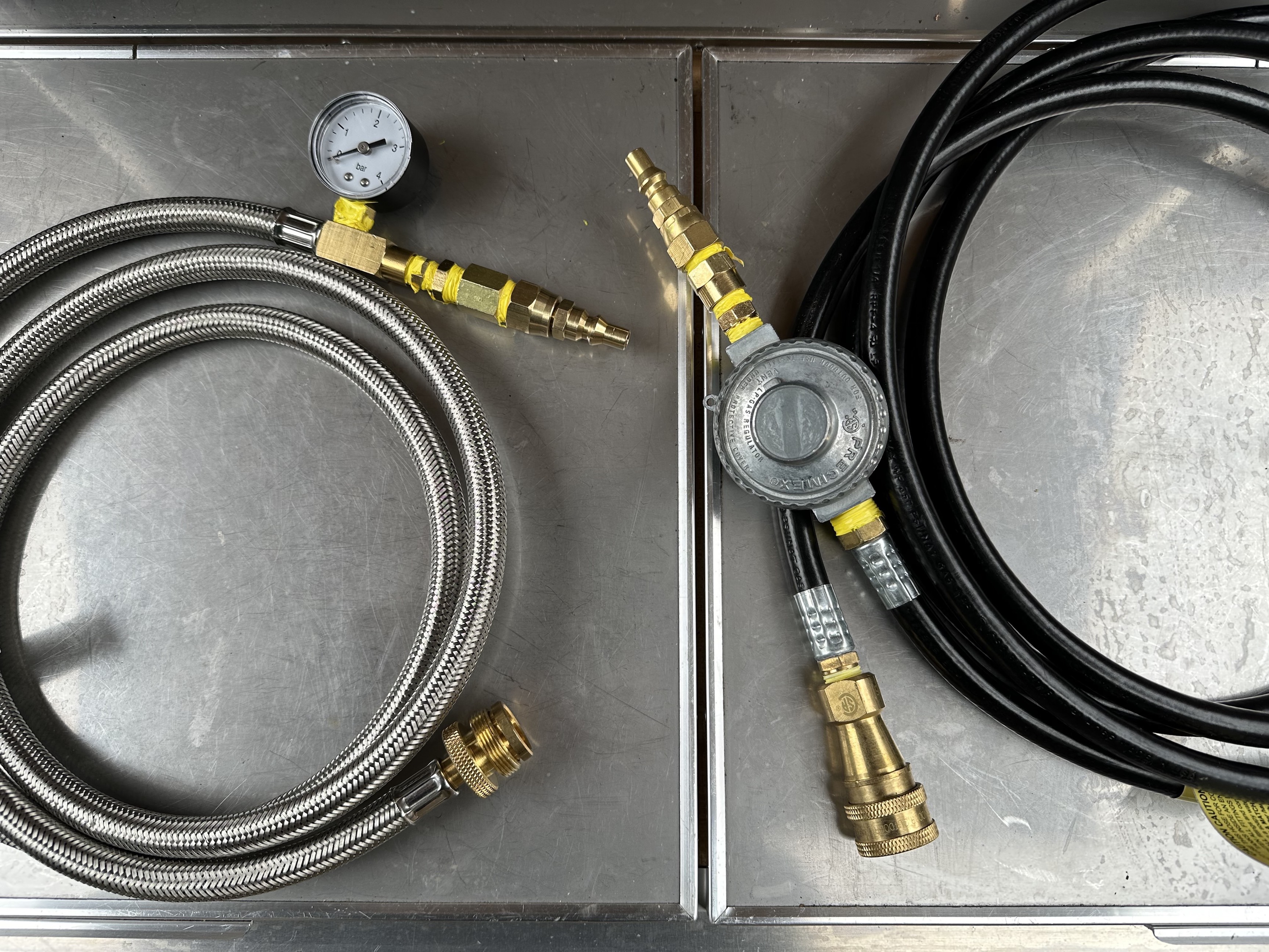

As a recap, these are my successful gas accessory versions:
I replaced the CI regulator with an adjustable one, that goes up tp 30 PSI. I have it set at 20.
These are my two (working) hose combinations for the side port:
They have been modified to adapt to the side port with the Quick Connect. The one on the right is a Mr Heater hose with the 11" WC regulator retained but the tank connection removed.

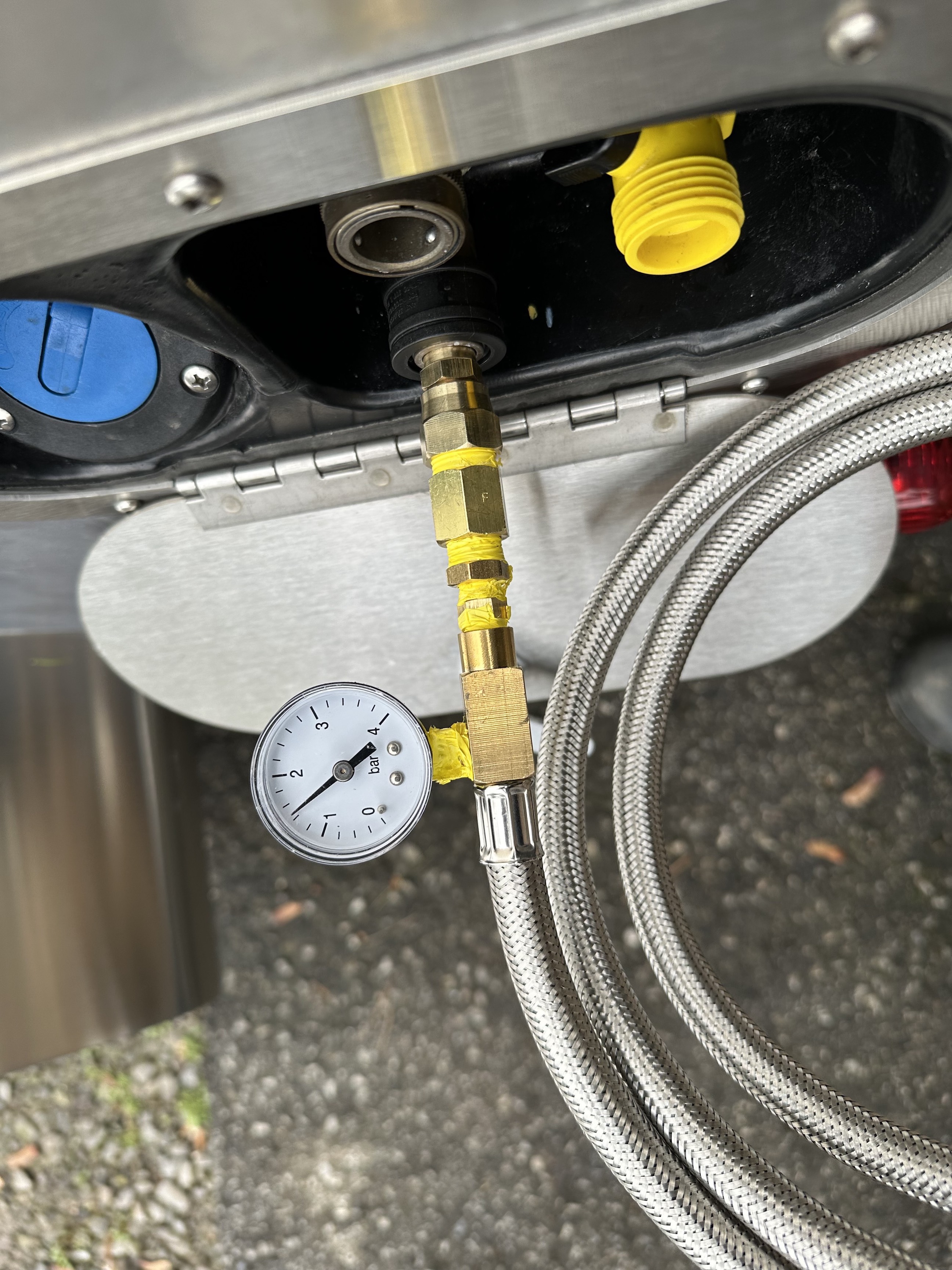

The 4 Bar gauge is showing 20 PSI equivalent (1.4 Bar) at the side port:
The only other piece of kit not shown is the Mr Heater filter that goes on the silver hose right at the heater.
I hope that helps someone visualize what my solution(s) were.
Aha!!! This solves it. Mr Heater has a one way valve of some sort on the fitting. Never seen anything like this before. That explains why the Camp-Inn provided hose is not working then. Because we pull the Schrader valve out of the hoses to make sure they will work with a broad range of gas appliances. But, now Mr Heater just complicated this by adding this feature.
Two solutions. First solution would be to do like Steve did and source a different hose for this. Or have a Schrader valve threaded in to the end of the Camp-Inn hose. That solves the answer for me how I will do it when I get my heater. I will simply spin a Schrader valve into one of our hoses and it will be good to go. I would probably dedicate that hose to the heater because with the valve in, there is a high chance it may not work with other appliances.

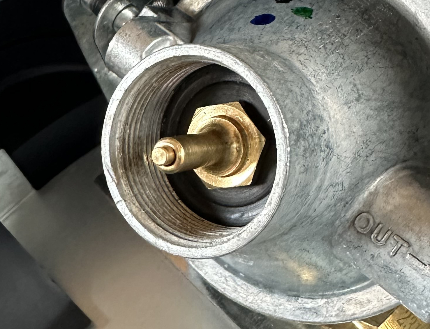

This is the connection for my Coleman propane lantern:
and the MH connection:
A quick glance (previously) and I assumed them to be one and the same.
Ya, not the same. The Coleman one is just a hole with what looks like a bronze screen in it. That is more the normal fitting. The MH fitting actually has a valve that needs to be pushed in on to open up to let gas flow into it. This completely explains it then. Sweeney did mention his hose has a Schrader valve (there are some that made it out the door with valves) so is why his is working. Interesting idea that two spring valves have to push against each other to make gas flow through both halves of the fittings.
