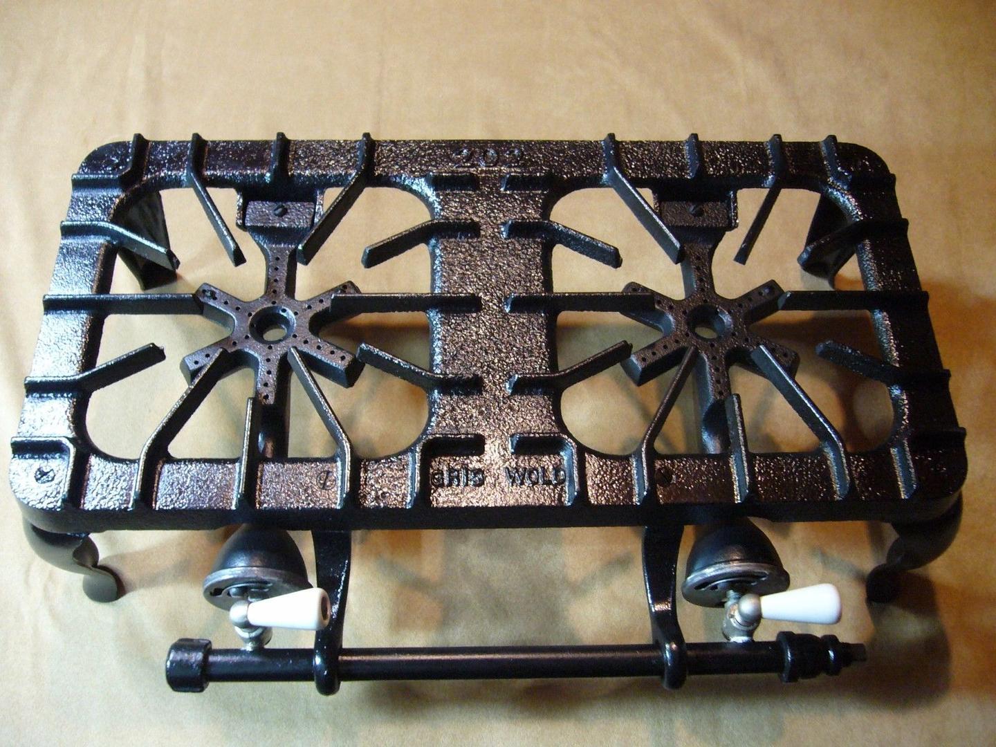

I managed to track down in Ontario a Griswold 202. They were made in Erie PA (just across the lake from us) until 1957. It is fully functional and similar in appearance to this refurbed one:
Mine will still need some clean-up work and a paint job to getting it looking like this. Dimensions are close to the CI, and I think I might be able to securely fix it to the existing slide without a lot of surgery. This vintage one would be worth the effort of a high-temp baked-on ceramic coating, like the Ceracote or the Jet-Hot. The orifice may need to be changed for a truly "accurate" burn on LP. And when finished, the BTUs might end up being somewhat less than the CI version, but we have rarely needed full heat from them anyway. Winter project.

Update: I put the vintage Griswold 202 (identical to the one pictured in the post above) through its paces.
It is slightly undersized, compared to the Camp-Inn OEM. But that is not the issue with trying to substitute it out, to get some vintage mojo into the galley: even with using a highly variable regulator off a spare tank, and a #72 LP orifice, and playing with the variable air intake at the orifice, I can't get it close to putting out a nice pinpoint blue flame at a low setting, like we are used to with the OEM. I can eliminate the yellow flame entirely, which means that it is combusting properly. But I can't get a better flame than the OEM.
This, however, isn't to say the Griswold is useless; it would be great for doing a pot of corn or other large batch outdoor canning, where copious heat output would trump flame control. I'm abandoning the idea of using it in the galley and putting that project (complete refurb and paint job) aside for now.
