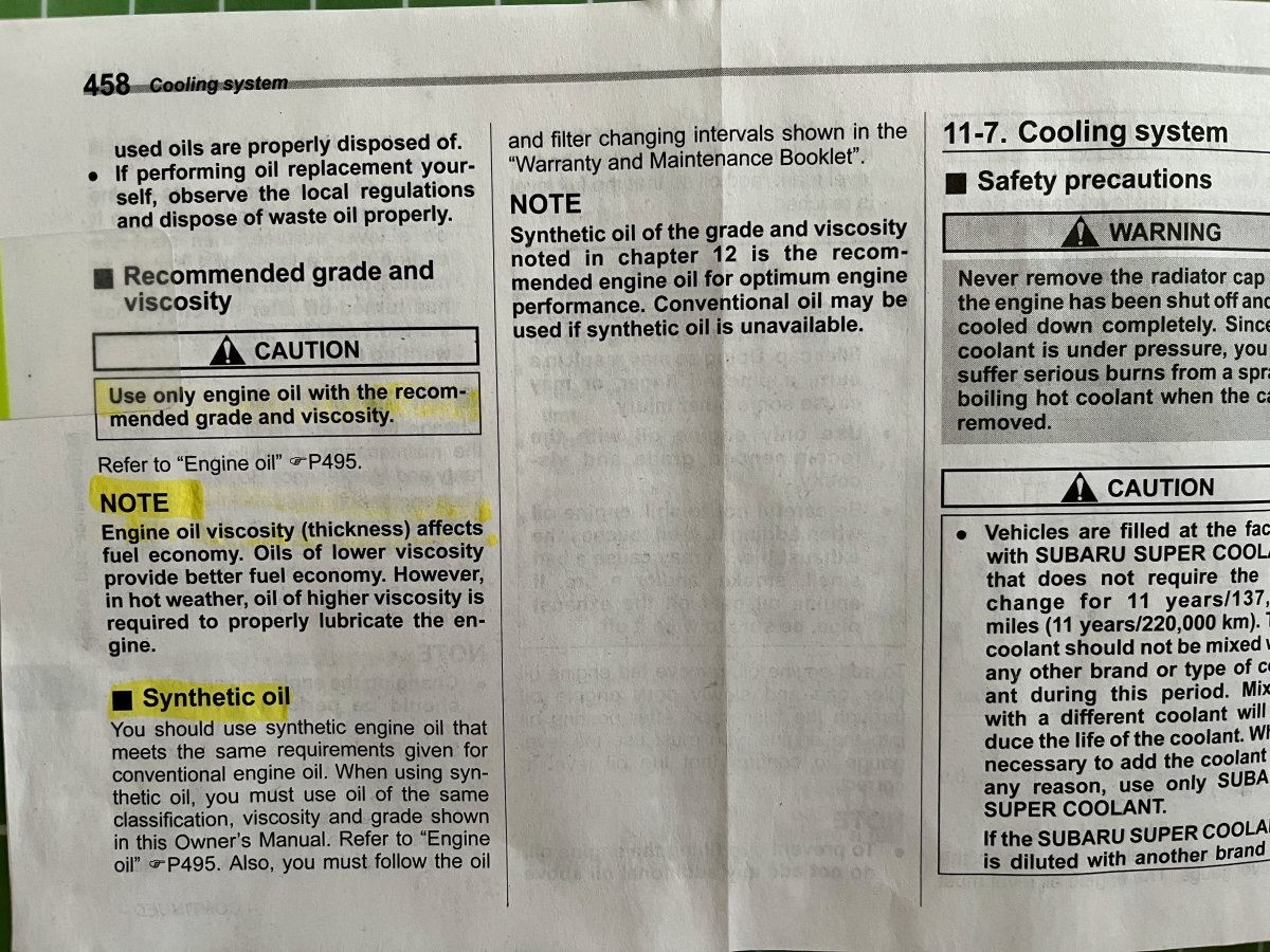

EDIT: Online Subaru's Owners Manual ( 2023 ) Example: PAGE #458 Cooling System.
NOTE:
Engine Oil Viscosity ( Thickness ) affects fuel economy. Oils of a lower viscosity provides better fuel economy. However, in hot weather, oil of a higher viscosity is required to properly lubricate the engine.
Subaru Forester Wilderness (2023) manual​

2. Follow the ' OWNERS MANUAL RECOMMENDATIONS' to the letter.
EXAMPLE: 2023 SUBARU's OWNERS MANUAL: Page # 458
QUOTE: ".... HOWEVER, IN HOT WEATHER, OIL OF A HIGHER VISCOSITY IS REQUIRED TO PROPERLY LUBRICATE THE ENGINE '.. :oops:

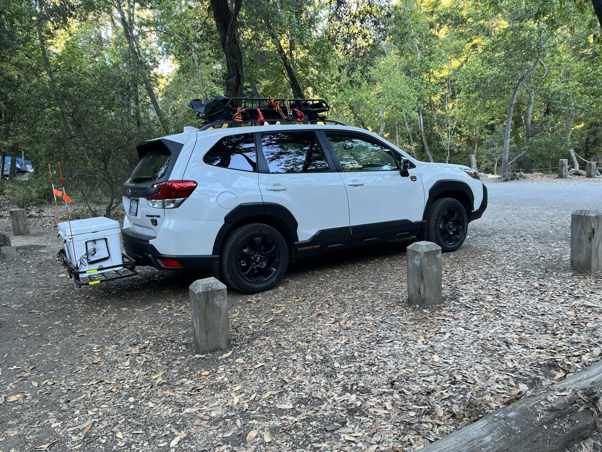

I've also tried to explain to the wifey.. We no longer have the extra room or Horsepower the ' GMC YUKON ' had.. o_O
I'll be traveling with a much lighter load, using the ' Subaru '.

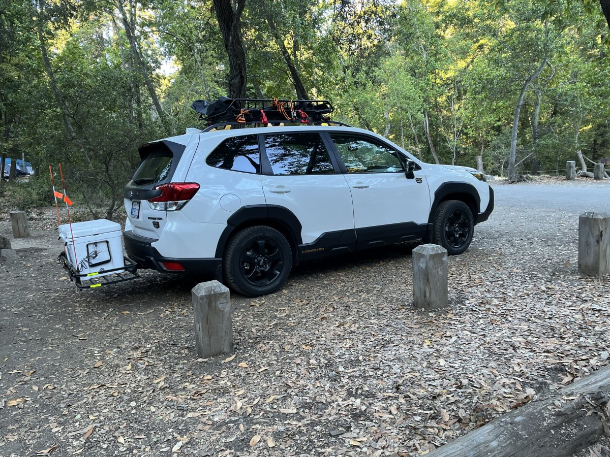

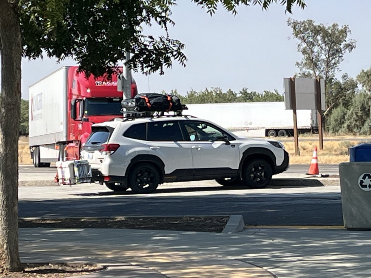

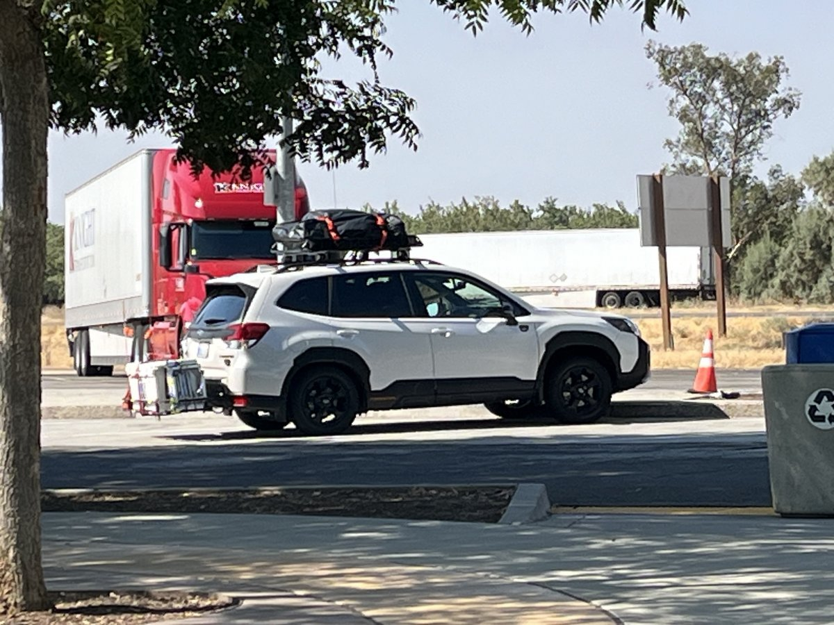

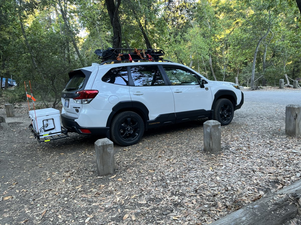

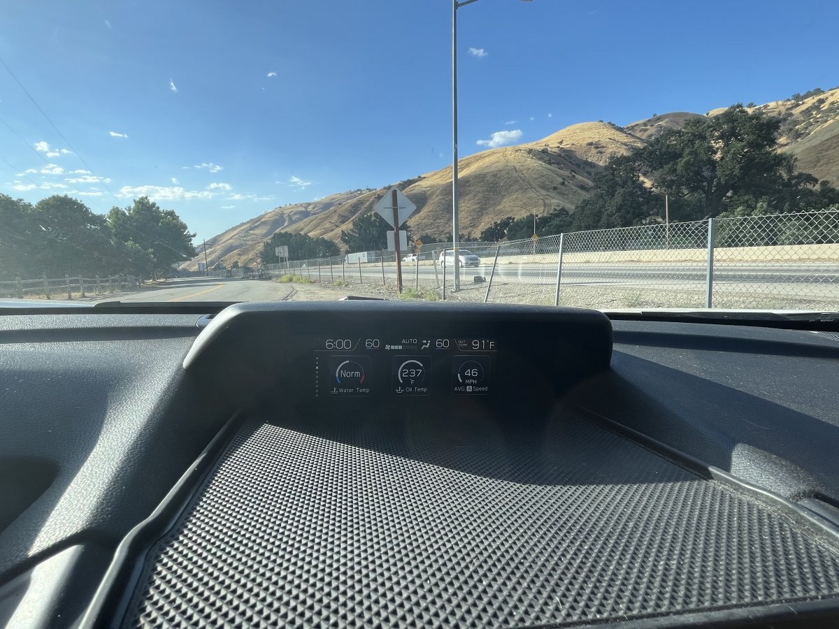

My Subaru started to overheat on a recent trip ( 5W-40 Oil ) traveling over the ' CA TEJON PASS '.
Fully Loaded for a Tent Camping Trip.
Jul - 2024
Wifey & I decided on a "4-day Camping Trip " ( 6 hr one way Drive ).

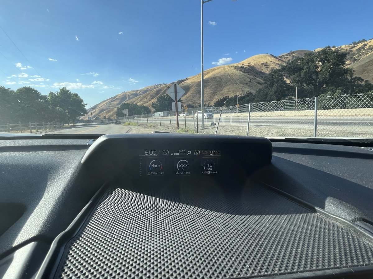

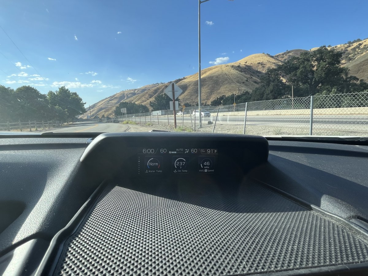

On the way home, mid-day Summer heat ( Ambient 91+ degrees ).
The Oil Temp were @ 240 + Degrees ( 5W-40 Oil ).
I immediately switched into the " Slow Lane " & decided to pull over @ the next offramp exit, which was the " FORT TEJON STATE PARK " entrance.
