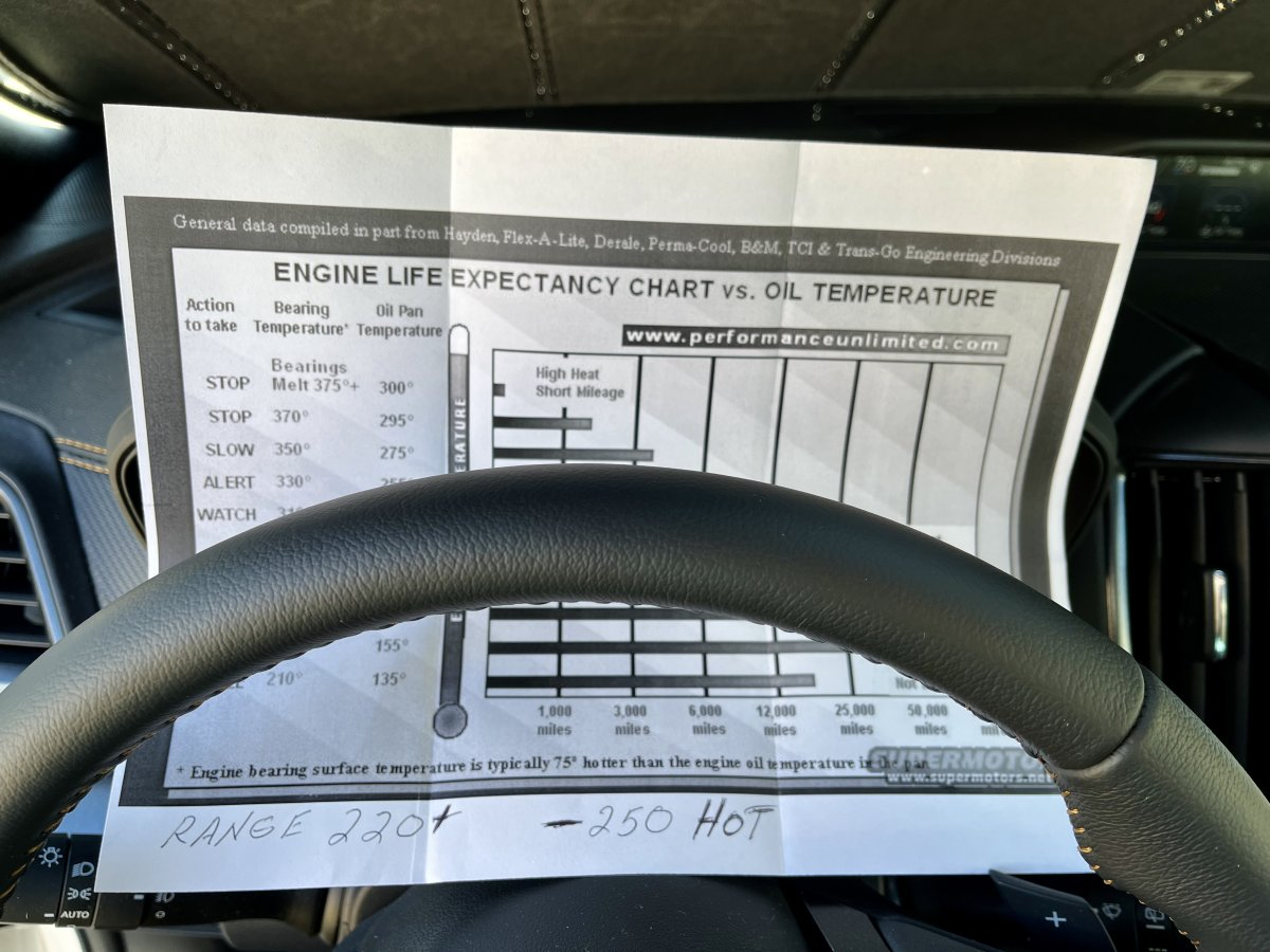

ENGINE LIFE EXPECTANCY CHART vs OIL TEMPERATURE
BASELINE- Approx Temps: 230 + / 250 + HOT
I will use the above info & average a baseline based on my " Personal Past Experiences - ( 30 + yrs ) TOWING ": Boat / U-Hail Type Trailers / & Teardrop Campers.

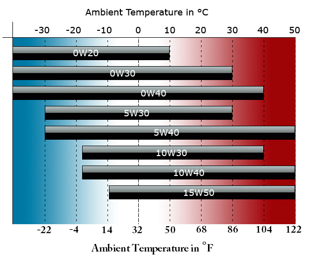

I'm also going to use some printed " DOCUMENTED DATA ", to use as a Guideline.
Just an ' FYI ".
