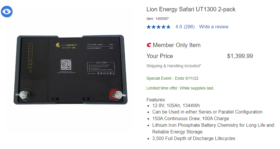

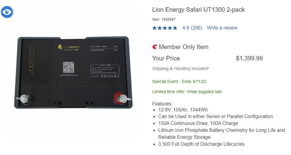

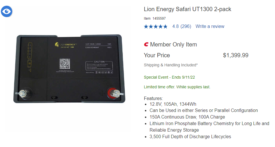

Came across this today in a Costco email. LiFePO4 batteries on sale(?). 105Ah for $700 doesn't seem particularly cheap, but the thing that caught my eye is that it is a group 24 battery. I don't think I have seen a group 24 at 100Ah before. Don't know anything about Lion Energy, but Costco usually doesn't sell complete junk.
It sounds like it would fit, and if all that was needed was the battery, while expensive, it might be worth considering, but the LiFePO4 batteries require a different charger as well, and don't particularly like cold storage or for sure cold charging. So, while I was interested in the LiFePo4 batteries at first glance, after doing some deeper research, I decided that for our type of use anyway, at this point, they were maybe more trouble than they are worth, in a cold climate anyway. Things are always changing though, and this will probably be something that does too.

I wonder if the 2 pack of batteries is required for 100ah. Are you getting 200ah or 50Ah x 2 --- battle born, the leader in this space, only offers 50 ah...
As for the batteries themselves, there is probably some use for them, but I don't see how they benefit a weekend warrior. Maybe my perspective is off because I simply do not have dispersed camping available to me. Not to mention I live in a place where air conditioning is a necessity. Humidity and heat in the midwest would make any kind of camping a miserable experience. I know, I've done it. In a teardrop you can't stack enough batteries together to run big appliances like ACs where as on a big rig you can.
Then there's the cost difference...35h to 50ah for about $500 difference in price. Even if the LIFEPO4 lasts for 7 years...my lead acid lasts 2 or 3 --- it is a break even dollar amount.
Then you factor in the fiddly nature of these advanced batteries is my objection, then there's price. Fiddly because you can't charge below freezing (I know self heating is coming technology), they don't like to be left floating at 100%, so storing your camper you can't just plug it in and forget it.
Lastly there is the angry pixies issue...I've seen a battery like this go nuclear before. I want to be FAR away when that happens.
I'm not sure what I am missing here --- seems to be a lot of excitement over not a lot of benefit, at least at the teardrop level. In my house, I'd love to get a bank of 500ah 48 volt batteries that will be charged and discharged (partially) daily...this makes far more sense to me.
I dunno --- maybe I'm missing something here.
Each battery is 100Ah.
I tend to agree with you on the second point. While I really wish the battery capacity were larger, the current available options just don't seem very cost/labor justified for the gain in capacity. Given the cost of the AGM batteries and their lifespan I really wouldn't get too worried about having it drop below 50% now and then. It doesn't destroy the battery, it only shortens it's life. If a $200 battery was going to last you 6 years and now only lasts you 3 years you're paying $33 for the privilege/convenience of extending the usable capacity of your battery. $33 won't fill your gas tank.

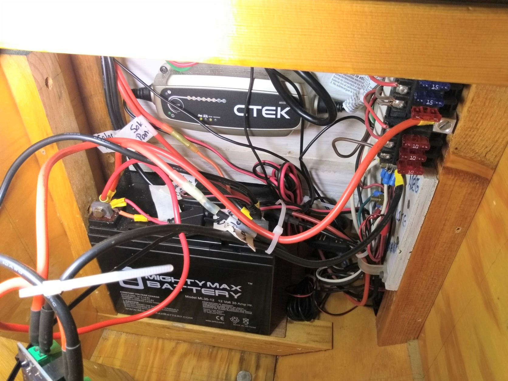

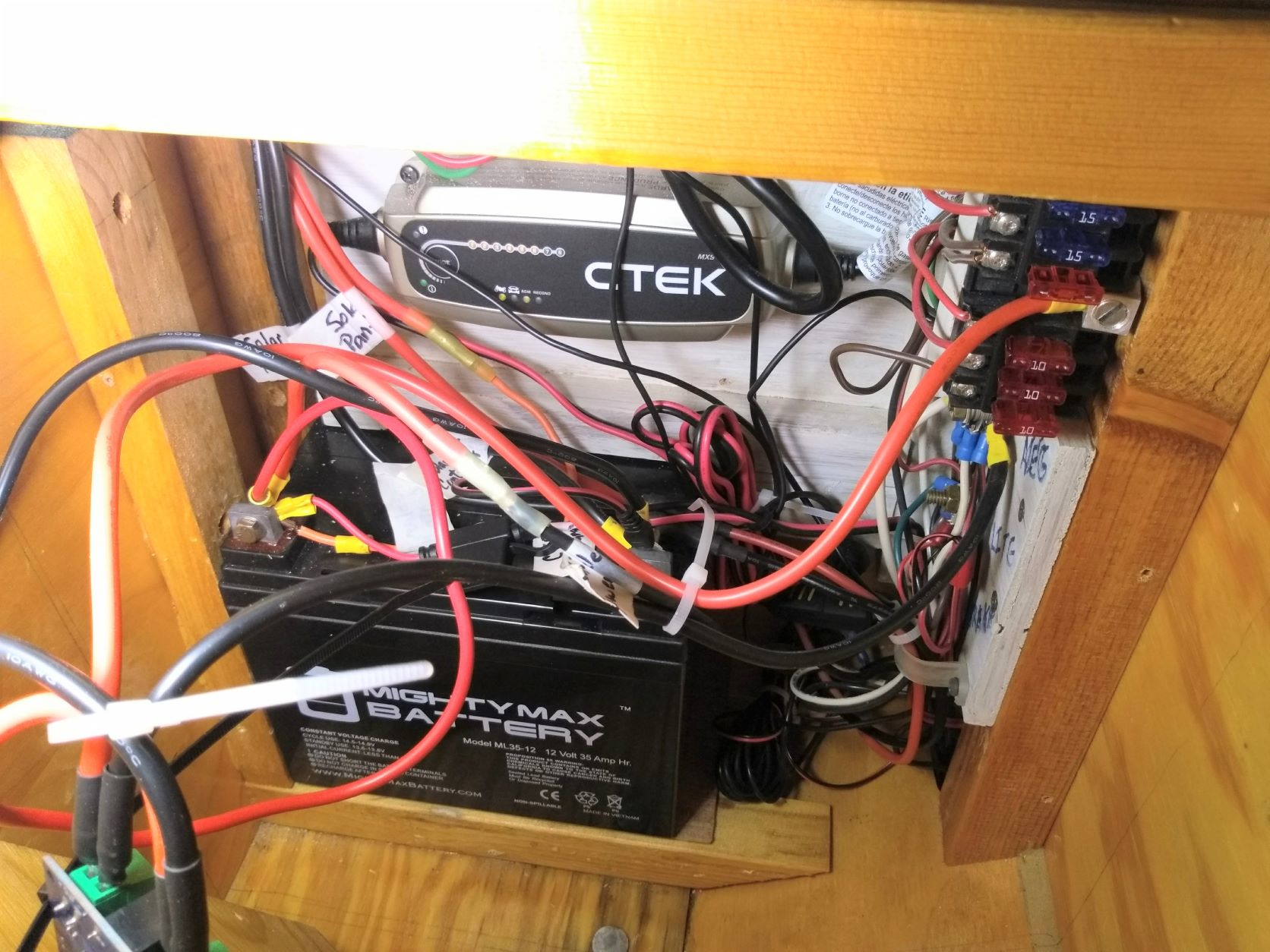

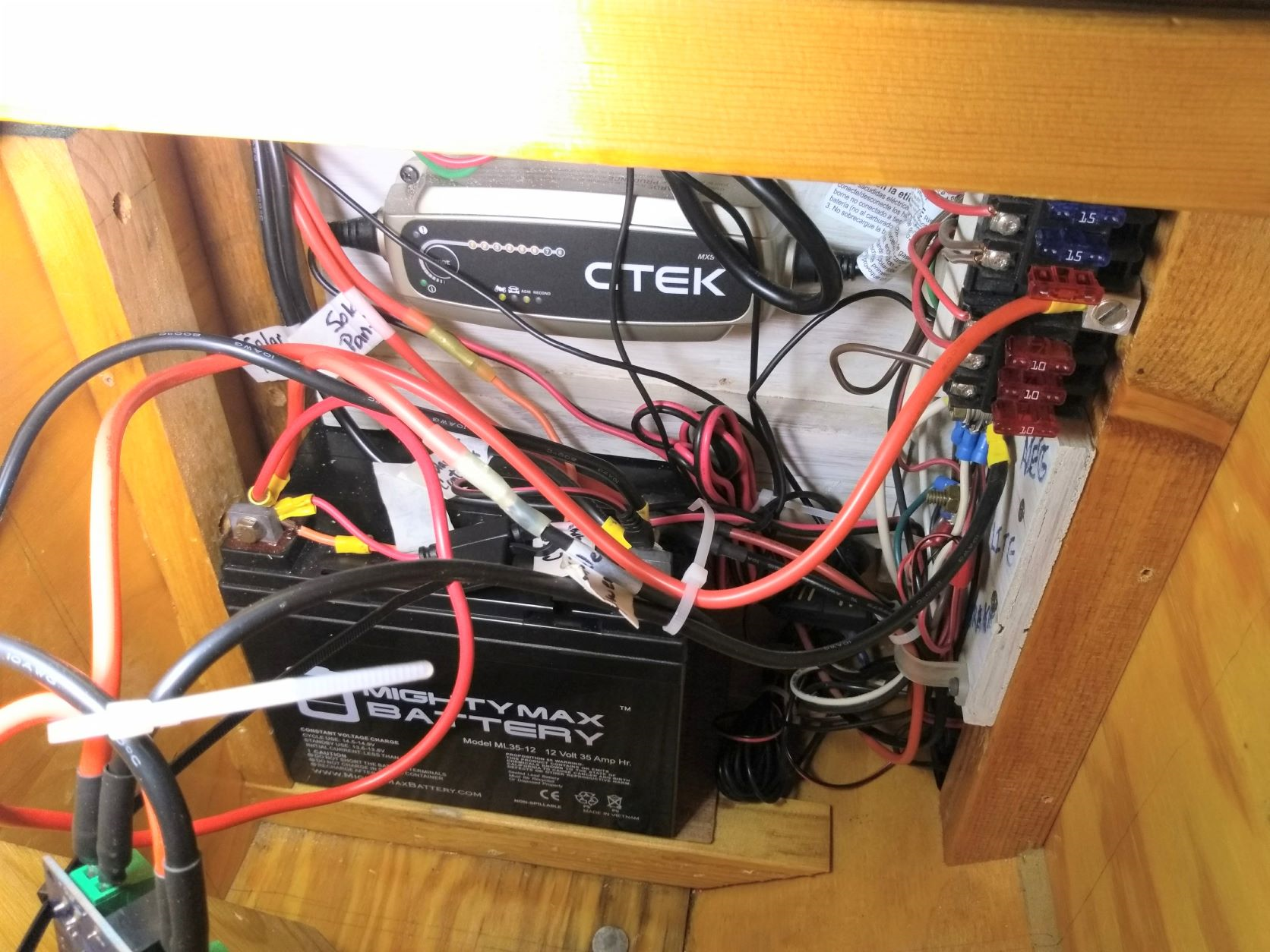

Our battery compartment looks much like your second picture. Love the 100ah Victron AGM!
It looks like you have a CTEK AC110v/DC charger above it?
CI users have gotten used to the term “the CTEK” to refer to their excellent 12v/12v alternator/solar charger, but CTEK also makes an excellent line of conventional chargers.
I’ve installed a Victron AC/DC charger in the bin area, I think it’s 17a, and a “the CTEK” 12v/12v DC charger in the battery compartment. Pretty full in there with 100ah batt.
Yes, I've had a couple of the CTEK chargers for other vehicles, so installed the CTEK 110/12 V AC charger when my OEM 110/12 V AC Battery Tender charger bit the dust after about 12 years of use. Before it died, the Battery Tender had served us well, so we'll try the CTEK 110/12V for now, and see if we find whether adding a 12/12V DC charger would be something worth the additional expense for our use.

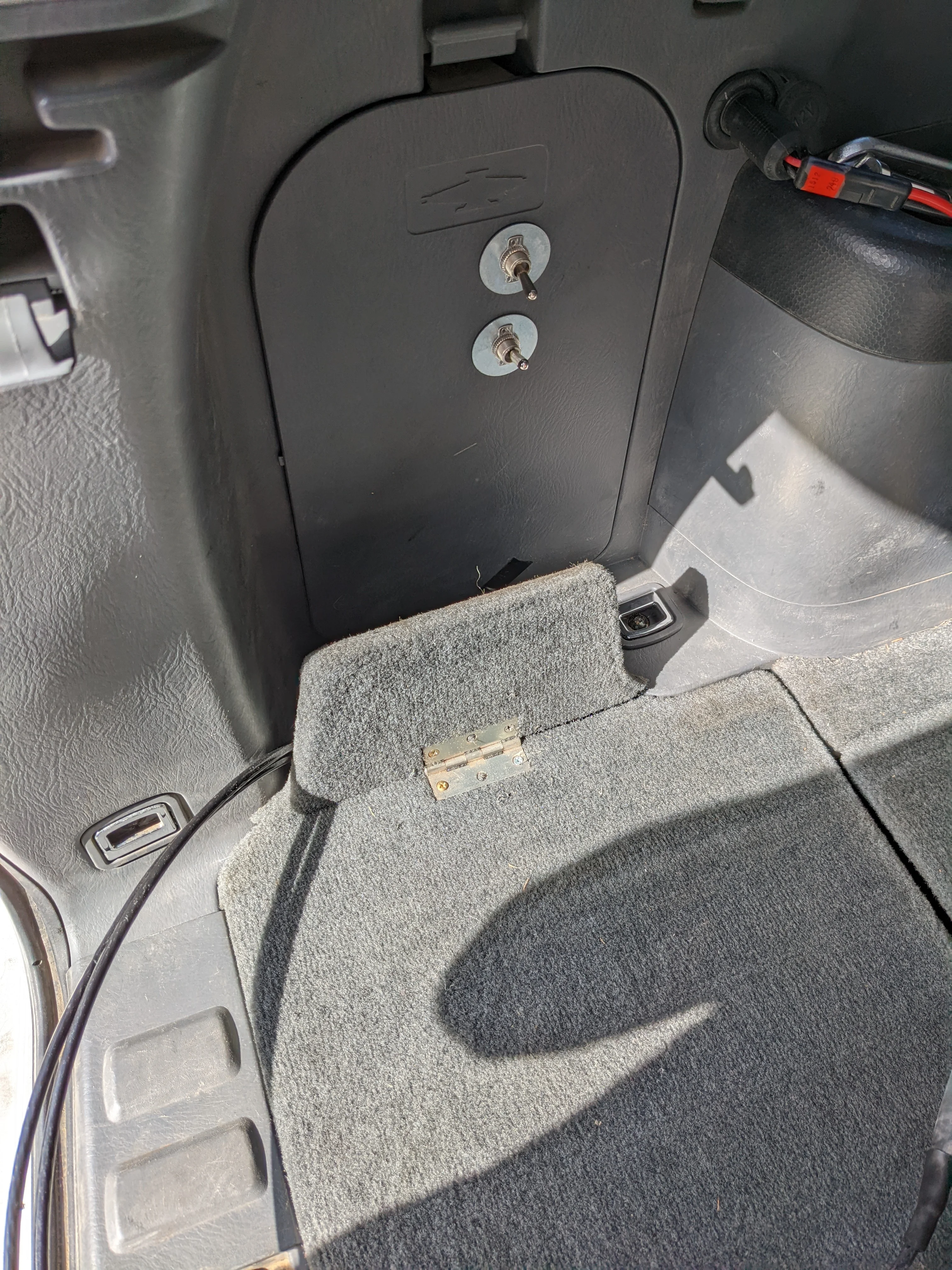

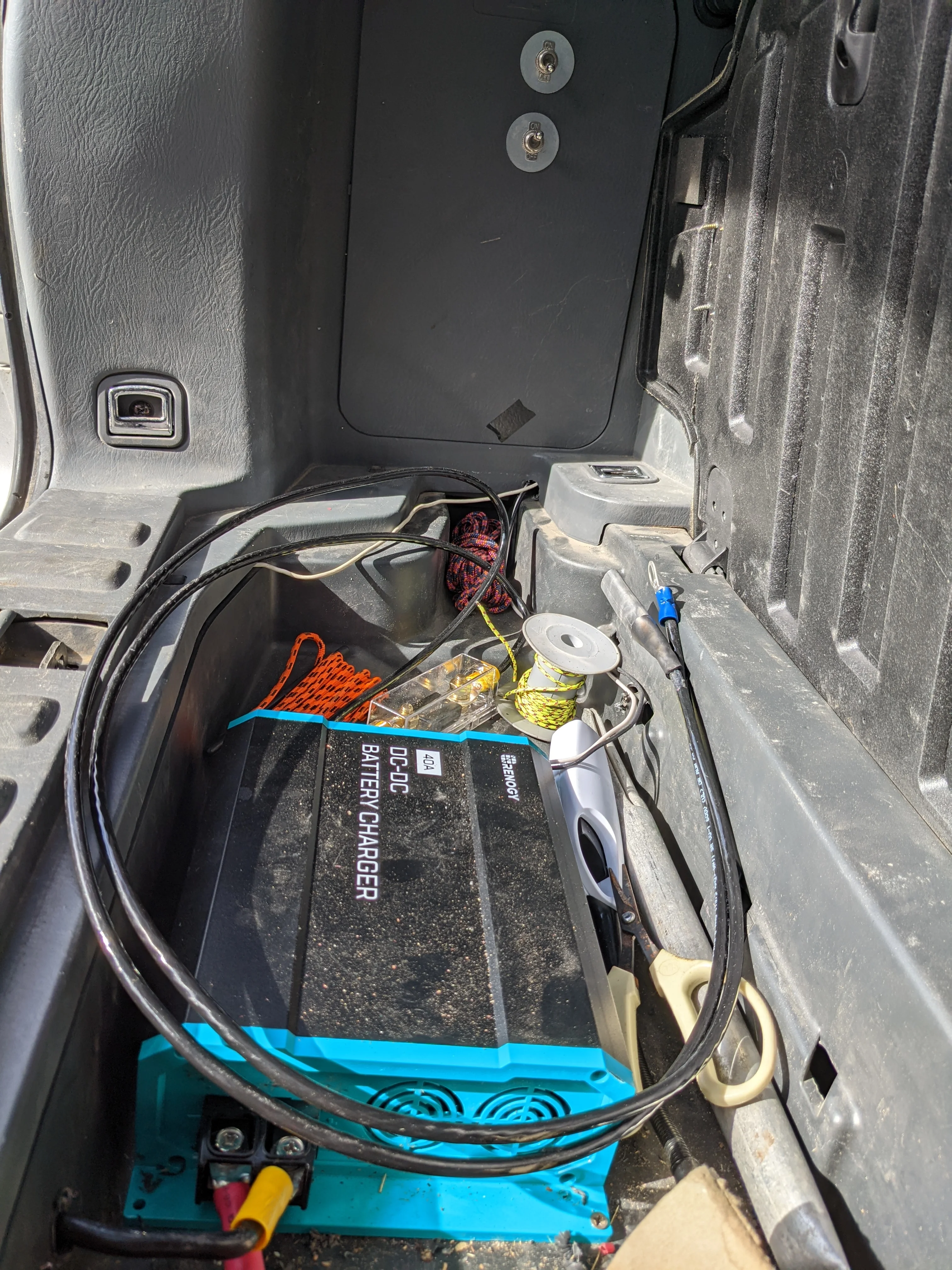

I think I have finally (knock on wood) solved my battery woes. Since I have a fridge and rarely use plug-in campsites, I've gone through a few batteries. I added a Ctek but would still tend to wear out batteries too fast.
Here is the way I do it now. I purchased the Renogy smart Li battery (when on sale, yeah!) and their 40 A DC-DC charger which I mounted in the back compartment of my older Honda Pilot. After replacing my umpteenth AGM battery in the trailer with another, I now use the fridge exclusively with the LiPo battery which I love. I have it in a portable battery case and it's so light that it is no problem to bring it along also in the vehicle. If not staying for an extended time in one place, I leave the battery and fridge in the back of the Pilot and leave it hooked up to the charger as well so that it is restored if I go anywhere with or without the trailer. No more fridge shutoff from low voltage when the compressor kicks in and rapid recharging when necessary along with a longer work life between charges. My new trailer battery never came anywhere near running down on a week long trip I just took. I should add that I am also using solar when parked for more than one night.
Back on topic a little more...

Is your Renogy DC to DC charger serving as an isolator from Honda starter battery when ignition is off?
Does your trailer battery also charge by alternator when hooked up to your Honda?

Yes, the charger input and output are isolated so there is no effect from the starter battery. I think I attached a D+ wire on the charger to the 12 V socket in the rear of the car so that it is only activated when the ignition is on. The trailer battery is charged normally from the car alternator also when towing.
The 2 switches shown in a photo mounted in the car are for power to the charger and a charge limiter that keeps the charger output amperage below 20. I guess this is to avoid overloading the alternator? I've been generally leaving it on since it still charges up pretty quickly with the limiter functioning.

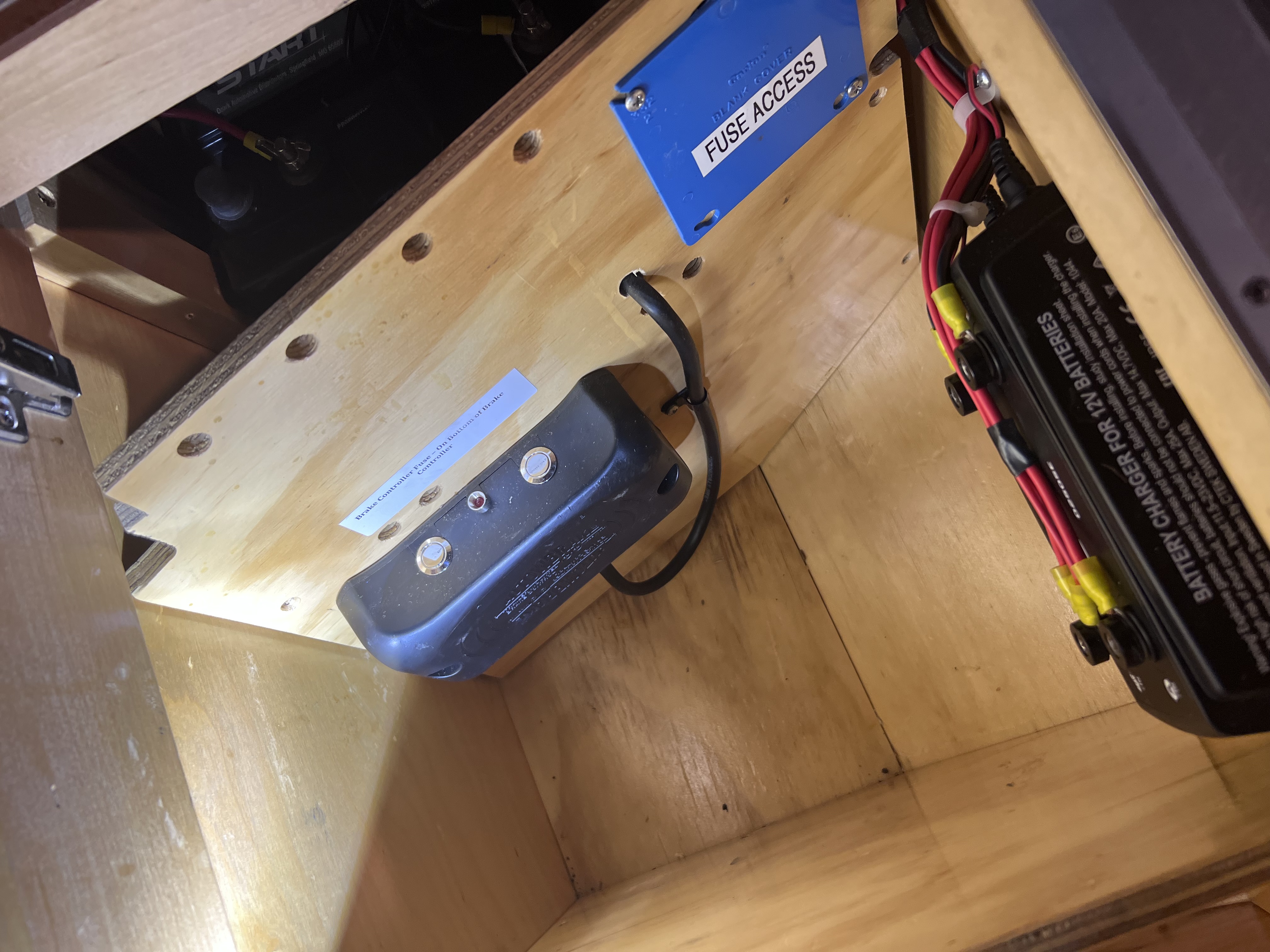

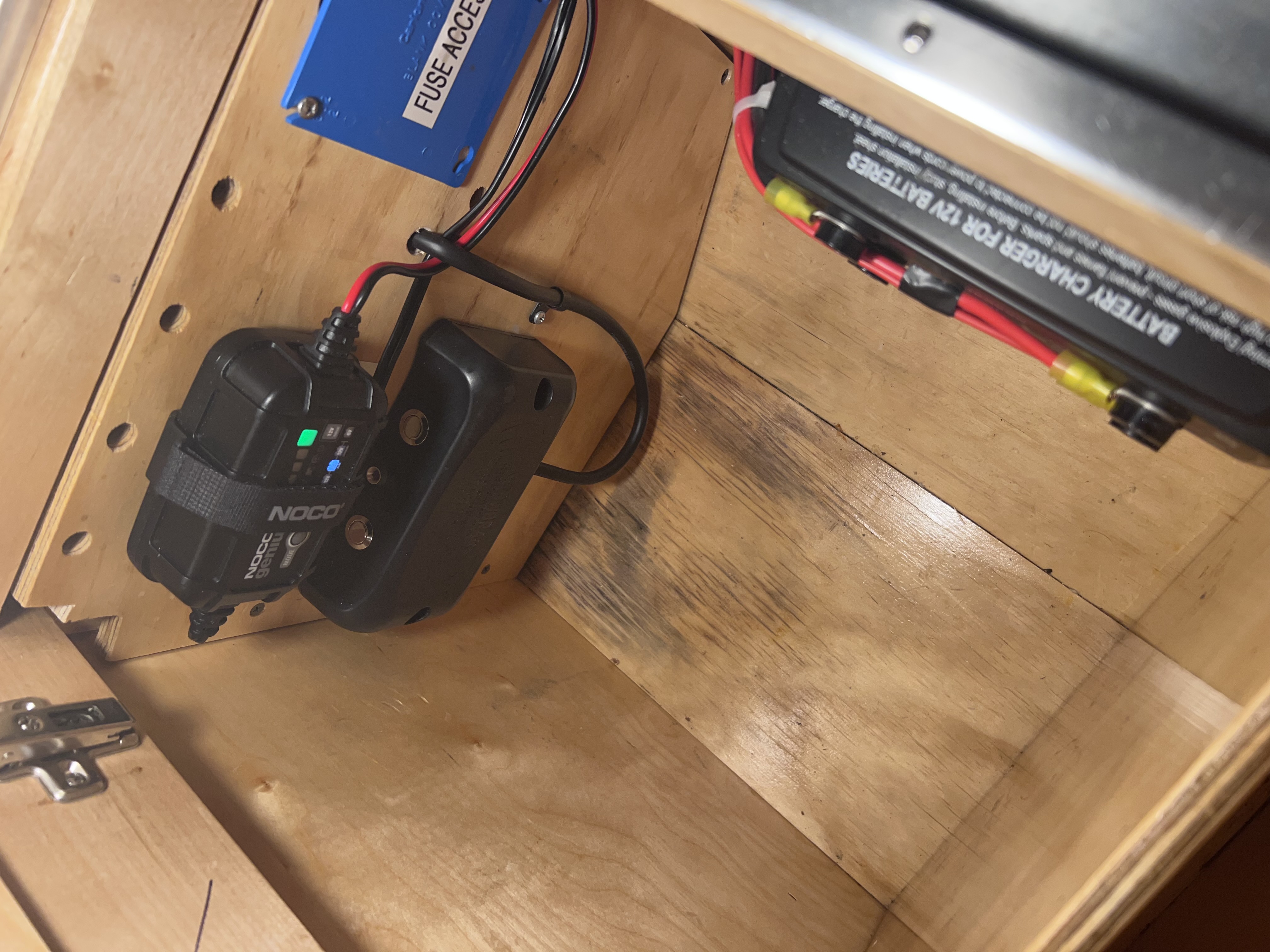

Sweeney, re: buying and installing your own battery- its not that hard if its same size as original.
Call Cary.
Battery upgrade-My understanding is you can get the exact same heated Lithium battery they get wholesale sourced via retail channel. (Edit- already covered above)
Charger upgrade- I'd use the Noco10 - its small enough and easily squeezed in someplace in your galley bay.
Here's a pic of my NOCO5, also good for Lithium which I installed as replacement for failed shore battery charger originally located underneath between water tanks.
