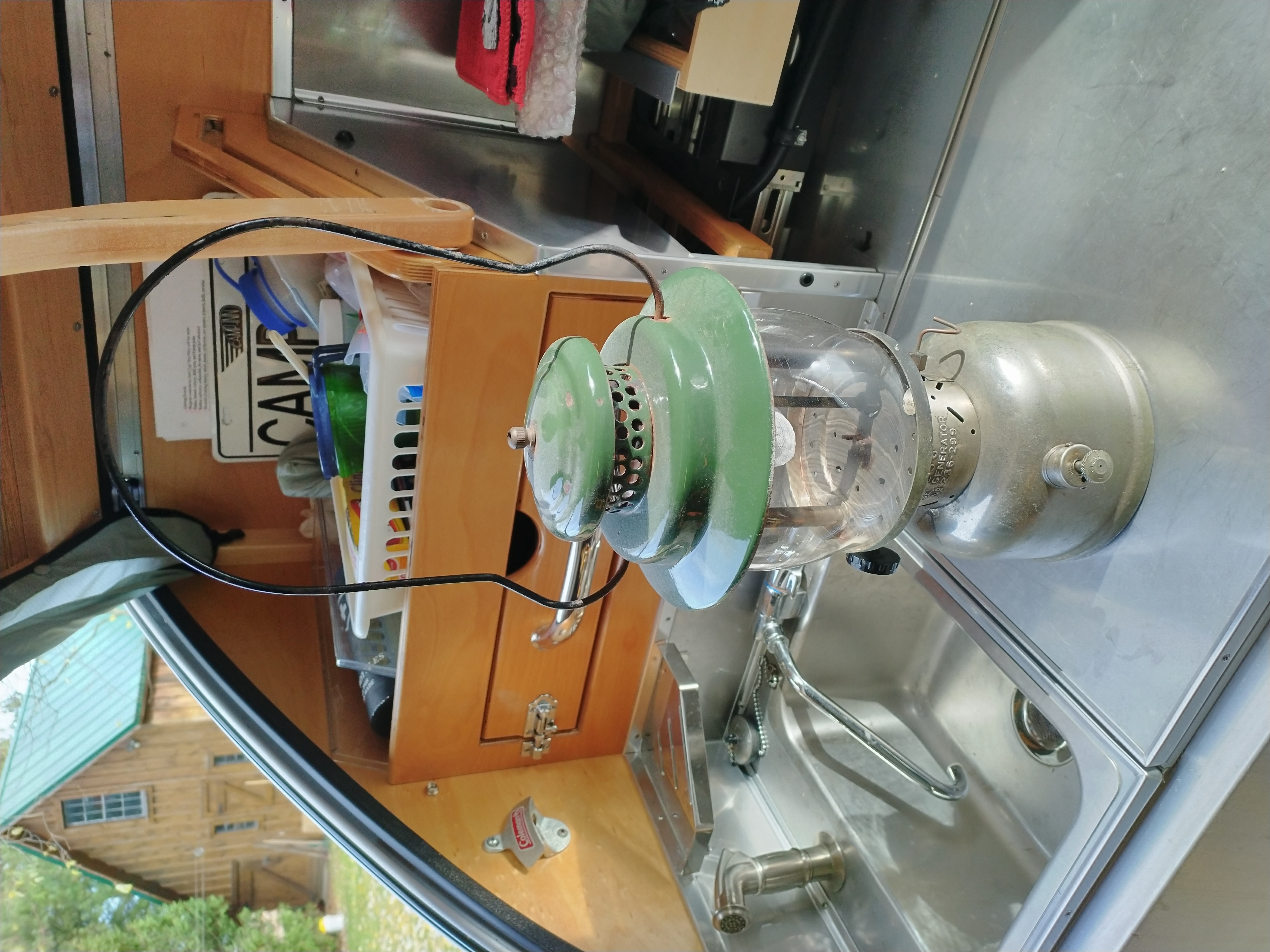

Since I was actively looking at getting a vintage piece of cast iron cooktop ready to use and replace the CI version, I thought I should compliment it with a new-to-me '53 #236 Coleman:
I will strip it down and do a full once over and cleanup (pics to follow). But it is functioning and demo'd to me. So I didn't have to do a dry test in front my seller. The dry test is well-described in this YT vid:
