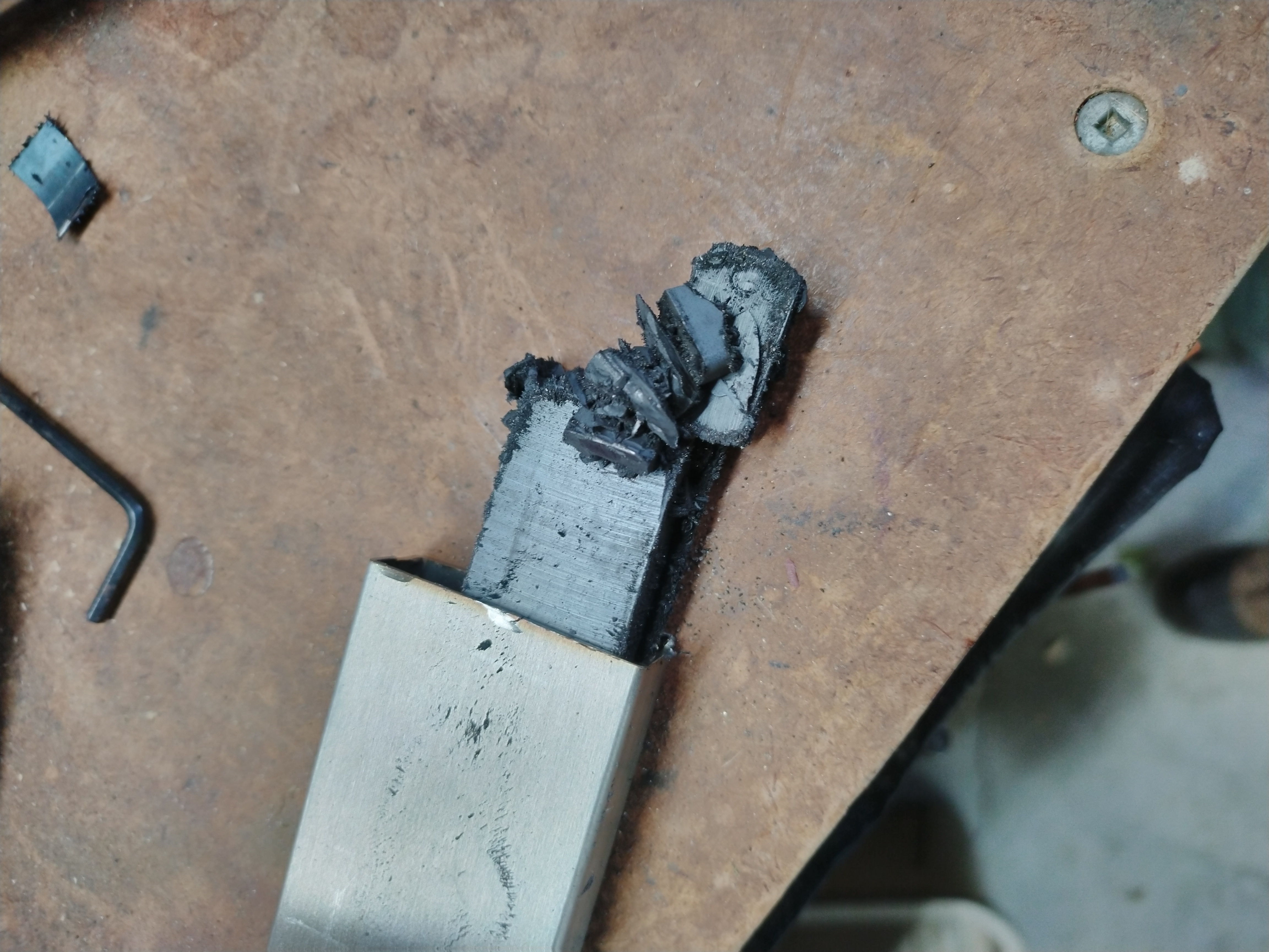

    Ultimately I was encouraged to go with Karen's simpler suggestion. It involves a 16" stainless magnetic bar https://www.amazon.ca/dp/B0C391DBLJ?psc=1&ref=ppx_yo2ov_dt_b_product_details that I cut in half with my mini cut-off tool:
    The magnetic bar (I discovered) is loose inside the SS square tube. The stainless cut was only slightly scorched, but cleaned up OK on the disc sander and with a metal file on the corners.
    I cut the magnet slightly shorter than the tube, stuffed it back in, and packed the side voids and end with JB Weld 2-part putty:

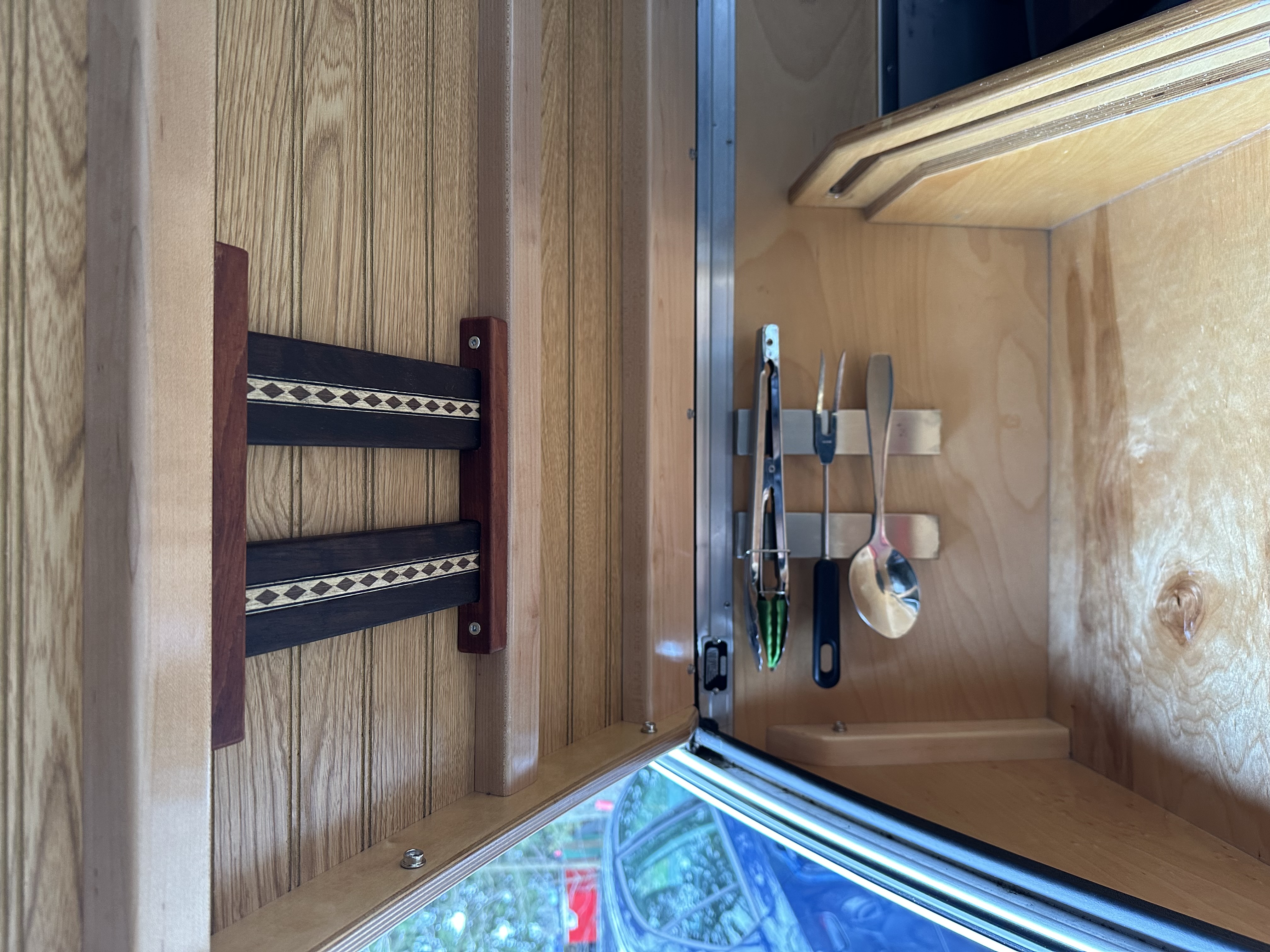

  2. Here's the hatch-mounted version, but decided to do an all-wood instead:
    These are the unfinished components:
    The woods are Peruvian Walnut, Jatoba and an inlay I had laying around that matched fairly well. The rare earth magnets are 1 1/4" dia. It's a little tight drilling and screwing into the hatch ribs. The arch of the hatch was negligible and didn't have to be taken into account.
    There's other ways to inlay magnets of different shapes; I happened to have a bunch of these so that's what I went with. They're certainly strong enough; I let the point of the Forstner just penetrate the dado for the inlay and stopped. That left enough meat, but it was thin enough to not reduce the pull of the magnets.
