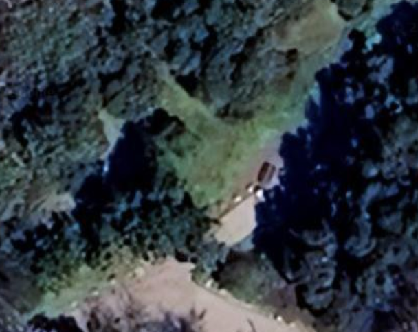

I was surprised that it worked where I was. It was just a relatively small opening in the trees. I've also tried it at my house because I also purchased it for internet backup if the cable or power goes out. I have tree cover to the west, and my house is to the north of where I had it, and it worked well. Here's the campsite where I used it. I had it on the picnic table that you can see.View attachment upload_2024-11-7_12-30-26.png
I was surprised that it worked where I was. It was just a relatively small opening in the trees. I've also tried it at my house because I also purchased it for internet backup if the cable or power goes out. I have tree cover to the west, and my house is to the north of where I had it, and it worked well. Here's the campsite where I used it. I had it on the picnic table that you can see.View attachment 11165

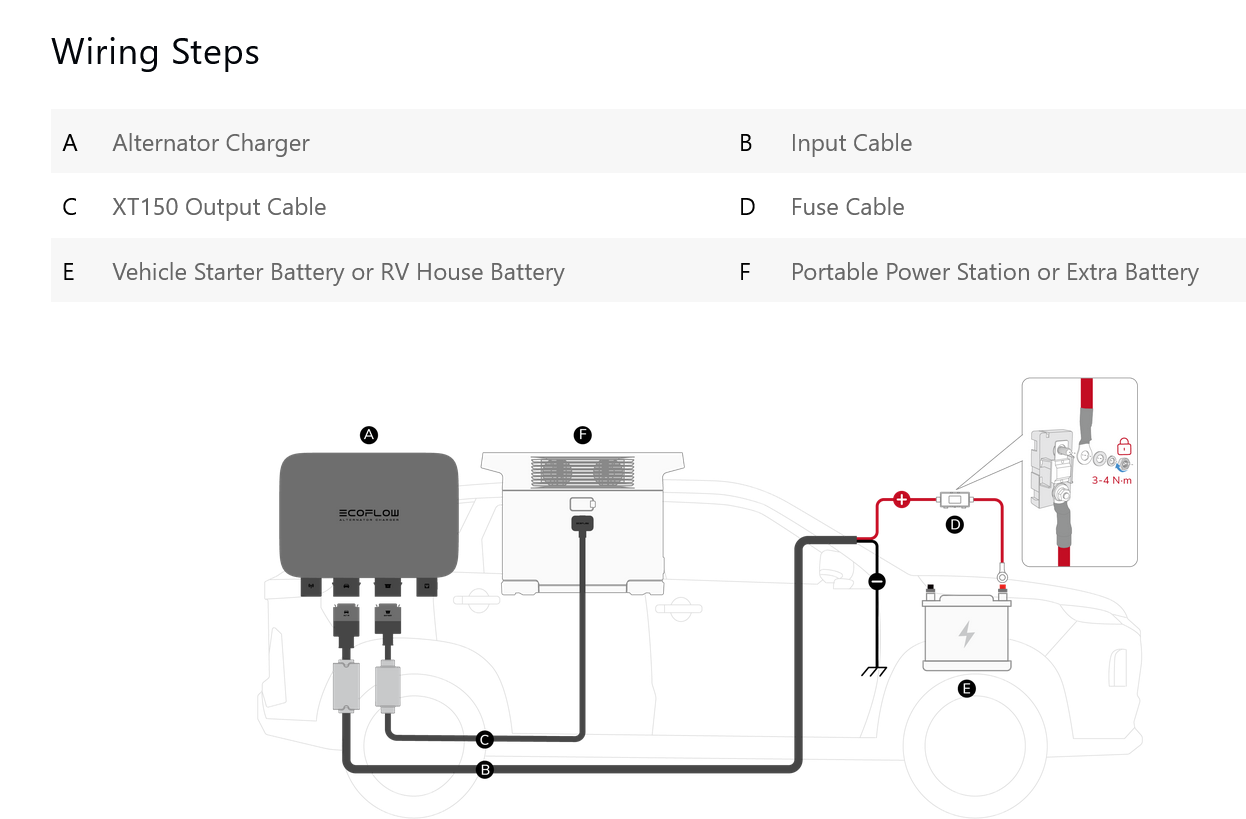

Dustin, can you tell me what kind of connectors are included with the Ecoflow 800W alternator charger? Does it come with alligator clips to attach to the TV 12V battery? I'd really only be interested in attaching it in a non permanent way.
I'm considering upgrading my largest sogen to the new Ecoflow Delta 3 Plus. The alternator charger is currently only $200 more in the bundle.
Thanks!
Thanks!
It doesn't have an alligator clip. It has eyelet connections meant to be permanently attached to the vehicles battery & ground. They could maybe be replaced with alligator clips as long as you had a good connection. I leave mine permanently attached to the battery & ground,(which took about 5 minutes) but leave the cable that attaches to the charger coiled up under the hood, then when I charge the sogen, I get the charger from the trunk, attach it to the cable, and then the sogen to the charger. If you wanted to change TV's it would be about another 5 minute job to take it out, and put it in another TV. This is a pretty simple installation, but the downside of using it that way is that you can only use it when stationary. If you want to use it while driving / traveling, you would need to have the cable installed so it goes into the TV's interior where there is room for the sogen to be stored while traveling.
I'll attach the schematic from the install manual, and a link to the entire manual here: https://manuals.ecoflow.com/us/product/alternator-charger-800w?lang=en_US

OK, thanks. My battery is actually in the rear of the car (RAV4 hybrid) under the panel with the spare tire. I guess I should check to see if there would be enough room to store the cable there if I attached it permanently. I'd still have to get to it every time I wanted to use it but a permanent battery connection would at least simplify part of the process.
FYI, The Delta 2 is on super sale as I type this...$459. Very tempting but I really like the features of the Delta 3 Plus.
Nice price on either one, and it sounds like having your battery in the rear would make the permanent/temporary installation of the alternator charger and use while driving a pretty likely possibility without being too hard to remove for installation into a different TV. I was just looking at a youtube video of accessing your battery
, and that little alcove/cubby on the right side might be a good place to coil up the cable. You would probably need to make a hole in the plastic for the cable to leave the battery compartment into the cubby, and could maybe find or make a grommet to fill it when the cable is removed.
Mine is actually a 2017 and the battery is in a bit tighter space. I looked at it today and there’s probably enough space for the additional cable although the positive terminal has some fuses attached and some kind of plastic cover over it that would require some work around required.
If I do buy an upgrade sogen I’ll probably spring for the extra $200 for the DC/DC converter. At that price it seems a bit hard to pass up.
