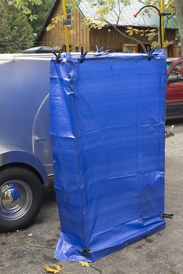

    Anywho... when we got home I got to thinking again about a decent shower tent. At 6' 4" most stand-alone pre-made enclosures are a non-starter for me, and my previous attempts at a homemade tripod enclosure didn't get off the ground.
    I decided to combine two things: we already take collapsible 8' MSR poles for the tarp that covers the galley. I simply added two additional 36"sections of PVC to the existing side tent frame and placed it on the roof. I used two 4-way PVC connectors: https://www.amazon.ca/CIRCOPACK-Fit...+PVC+connectors&qid=1603057240&s=books&sr=1-1 , that are used for making PVC furniture, to make the joint at the poles. (See attached photos at the end before you go any further to see what I'm talking about). A bit of foam tape kept them from slipping down the pole.
    The photos also show the existing side tent frame superimposed on my new extension, on top of the trailer, just so you see how both line up.
    I used a 6' X 8' tarp for the shower curtain and clamped it. However a 6' X 10' would be better and give you complete coverage, if using 36" extensions. We already take a tarp for things like transporting firewood, so this wouldn't be anything additional. For a "cleaner look" (intentional pun) I have these nifty things coming to attach the tarp on to the PVC, instead of the hand clamps... https://www.amazon.ca/Snap-Clamp-Inch-Inches-White/dp/B0050B0N06. They're meant for making PVC greenhouse frames.
    The door can swing open to provide you with a discreet entry and exit, and 6' is a high enough coverage otherwise. I did 36" out from the trailer but you could make it even bigger. Especially if you use a wheelchair.
    The CampInn side tent poles will work with 1/2" PVC fittings but they are a little sloppy and would need to be filled in a bit. Be forewarned PVC and CPVC have different OD's. And as far as I know, the 4-ways are only available in PVC.
