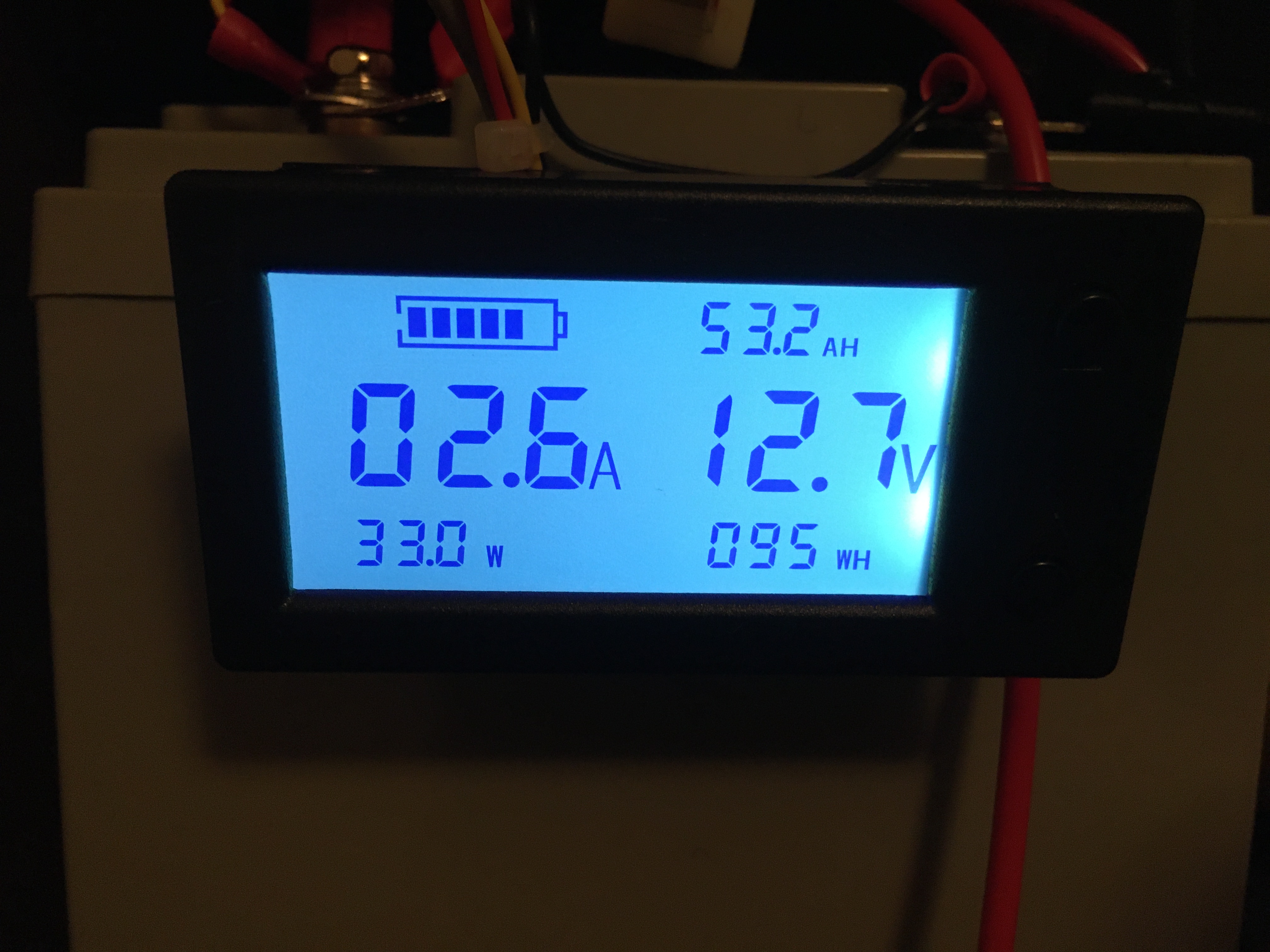

    I recently installed a $29 DROK power meter (link) on the CPAP pony battery. This is different than measuring state of charge (SoC) by voltmeter, as a power meter keeps track of power out and power in over time. This is also what the optional C-I Bogart Trimetric meter does.
    It’s a great feeling to know for certain what is going on with my pony battery! I’ve run it a couple nights at home with two different CPAPs, and learned that my older CPAP (described in previous post) draws about 3.1 amp-hours in 7.75 hours, which would give me 9 nights before dropping below 50% SoC.
    My newer APAP draws a little more power - 8 nights.
    Install of the power meter required stripping and crimping. Rotus8 installed the previous version of this meter on a pony battery, and described it here (link). Rotus also installed the previous version for his trailer battery (link).
    I was unable to find that version, which uses a shunt and is a bit less expensive. Mine uses a hall-effect sensor - you run the positive load & charge wires through a little ring, I guess it works by induction somehow. Then you need power to the meter itself. The slightly hard to follow instructions are here (link).
    I like it so much I ordered one for the trailer batt, and will update this thread (link) when I install.
    As someone who depends on CPAP therapy for their daily health and well-being, this has been a most rewarding project. Data, I now have real data! Incidentally, the headboard cabinet where I could place a CPAP was the initial feature that had me consider C-I! I knew I needed that, and only a couple manufacturers offered it. I’m glad I found C-I.
    Pictures below. This is a $29 meter - the .1 amp disagreement between it and my charger monitoring app is certainly close enough! Counter-intuitive to me, the meter shows positive flow when discharging, and negative when charging. The best feature is the Amp-Hour reading (ah) upper right.
    My pony is a 60ah battery, that I only want to take it below 30ah occasionally if at all. A standard AGM or lead-acid should never be taken below 50% SoC, the Victron batts have a slightly different chemistry. I think this is starting to show up from other manufacturers.

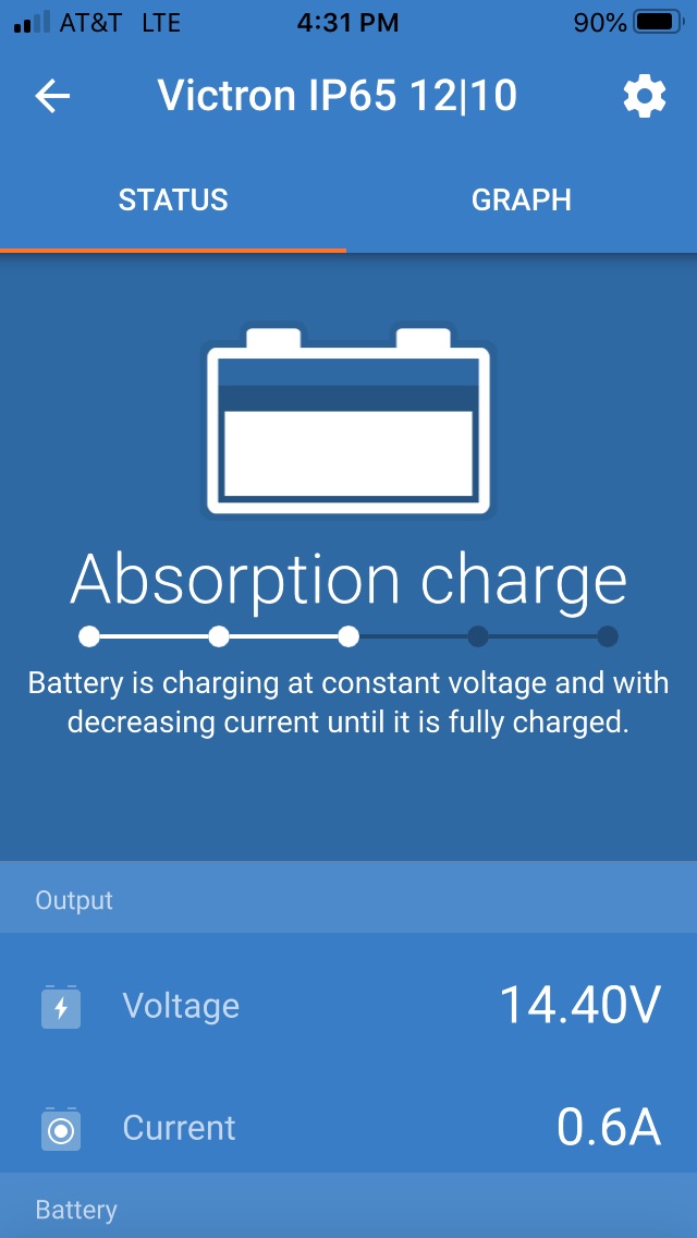

    The $29 DROK power meter on the pony battery turns out to be somewhat unreliable. A couple of times it has returned a disaster-like reading - wait a minute, that was only 2 nights, why does it read a 30% SOC? Other reviewers have also reported this. On the one hand, it does that. On the other hand, it’s 1/10th-ish the cost of a Trimetric. For a third consideration, it really did help me zero in on my actual power consumption with CPAP, which was well worth 30 bucks! And, a quick disconnect from the battery resets the meter (so far).
    I’ve not yet installed the 2nd power meter. It may just sit on the shelf a while more - not sure if it will be a backup for the pony batt, or will go on the trailer battery. Maybe there’s something more reliable out there.
    The Victron battery chargers have provided the saving grace to easily weather the unreliable power meter reporting. Victron’s bluetooth app has updated the charger firmware a couple times since installation, and, *when plugged in to AC* retrospectively provides the confidence reporting that assures I’ve not toasted a battery.
