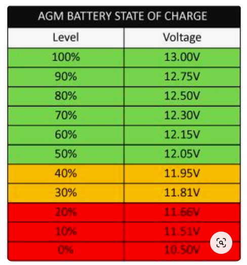

    For those of us who have an AGM battery, I found a chart that gives the approximate charge by voltage present.
    I made a copy and keep it with my TD.
    Kevin S, LisaNKevin and Ken & Peggy like this.
