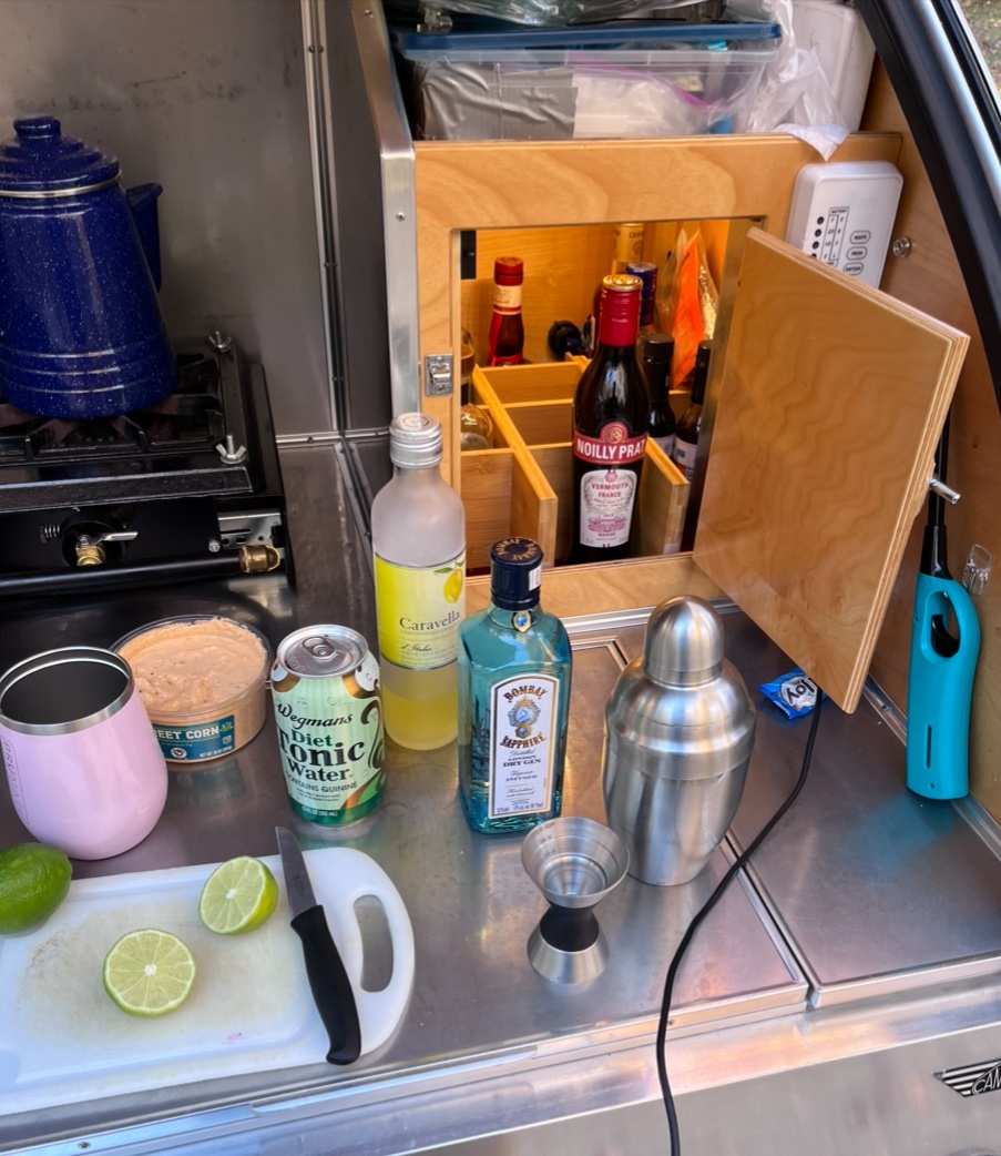

This mod I’m particularly proud of. It started when we just got the trailer and transferred two milk crates of our tent camping gear to the kitchen. Stuff went on top of the cabinets, and pots pans etc in one of the deep bins. Dry foods on the other side. That silverware drawer holds so much, it is still one the best changes since tent camping! When all was put away, the little cabinet on the right, with the door, was unused. Now what to do with that? And then it struck me: it’s the perfect size for a liquor cabinet! It’s almost like it was designed for it.
Camping is not the same anymore! We park the trailer and we mix up something. Our favorite is a rosemary limoncello gin tonic. But I can mix up a jalapeño gold margarita, cosmo, black russian etc. Whatever we’re in the mood for. You can buy every brand liquor in these cute 375 ml bottles that I refill at home.
The mod is: power tapped with a T-connector from the 12V line in the back of the cabinet. It has a manual switch, a door switch and short LED strip of 6 lights. Adhesive wire clips secure the wire. Double layer of felt at the bottom.
Initially I cut some dividers out of a foam sheet to try it out. I was going to make my own wooden drawer dividers but getting those cut to fit perfectly and install them in the cabinet is not simple. I found springloaded drawer dividers on Amazon. One of the few taller than 2”: Vriccc 4.4" High Drawer Dividers. https://www.amazon.com/dp/B09LV2YNDJ?ref=ppx_pop_mob_ap_share. They clamp in, so I can remove it if necessary. It did take a lot of back and forth making small cuts and filing to make them fit just right. That spring inside them means you have to cut carefully or you ruin your saw. It was much fun to build, mostly due to the anticipation of using it. We’re into our 2nd season with it and have been to Colorado and Maine and many short trips in between. Never comes loose, never a broken bottle and much enjoyment.
