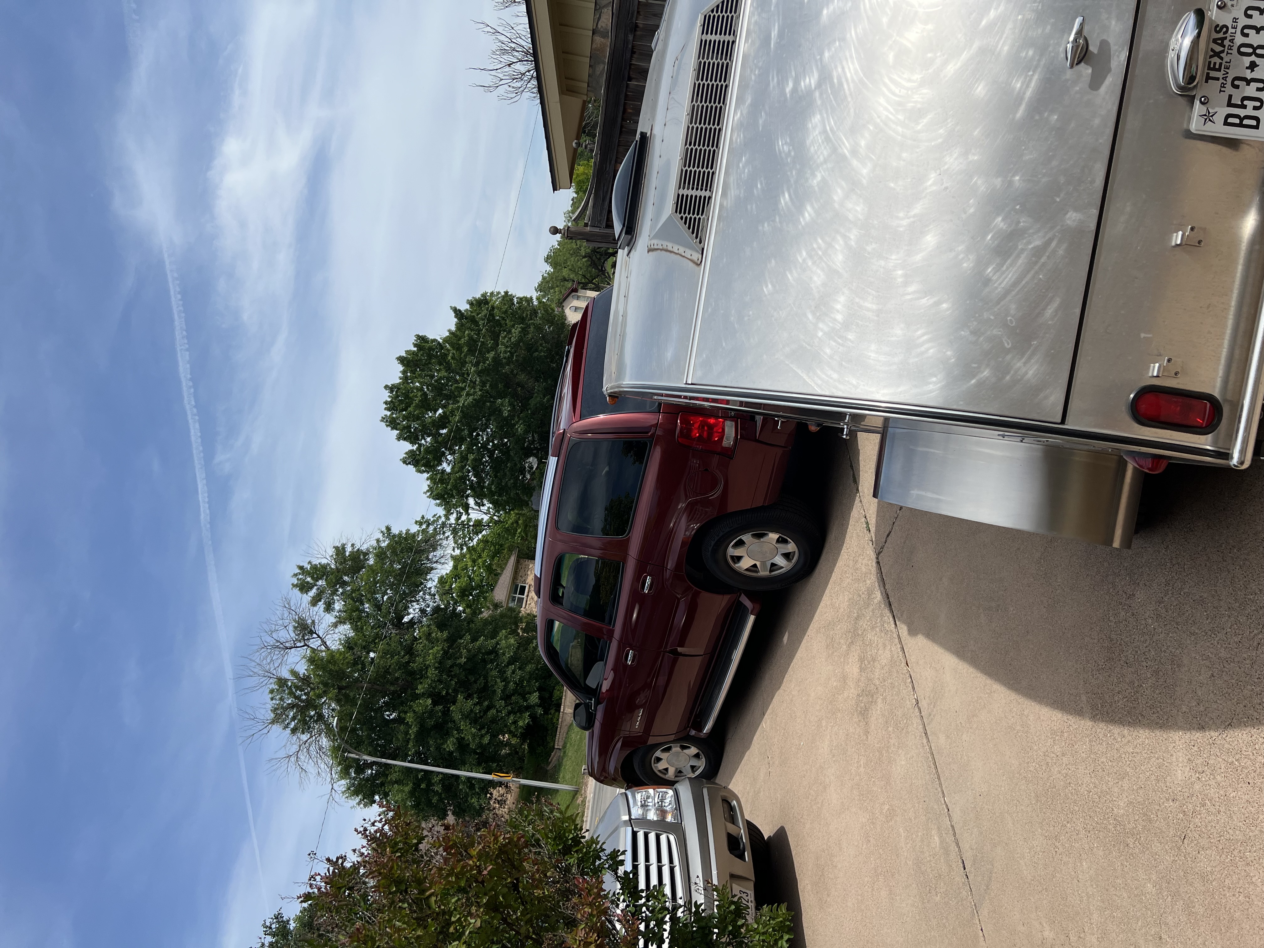

We are currently on the road in our 2009 has water on the edges of the bed around the door- on both sides
Windows were closed tight
Ideas as what we need to repair to fix :) thanks

It is one of two things. Either water is getting driven into the condensate vents on the bottom of the windows by water spray from the tires. This is amplified on older campers with Fantastic fans because they can create suction inside (not so much on the 560 though). Try taping off the condensate drains on the window bottoms (black plastic pieces on the window frame) with electrical tape when driving in the rain.
The other thing it could be is water getting in around the door strike. This can happen on pre-2012 models, it is kind of random but possibly what you are seeing. This is solved by getting the door seal upgrade kit from our online store and installing on your camper.
One thing that helps to know is what is the tow vehicle being used? What kind of tires are on it?

Looks like it’s coming in up underneath the door?? The doors were closed tight…
If it looks like it is coming in under the door that could be the door strike concern then. Water getting in around the latch on the older door seal arrangement. It will follow the seal down along the door and come out at the bottom of the door. Door seal upgrade when you get home may be in order. This can be tested by running water down the wall above the door with a hose to see if water is getting around the door latch strike.

Ruth, Yes, the Escalade is for sure spraying water at the doors. I would start with taping off those lower plastic condensate drains on the window frames.
If it is water getting in at the strike not much you can do without changing it, but that would not likely cause water at both doors.
The other thing to do is to seal off the roof vent from the inside with tape and plastic. It is possible that you are getting suction in at the roof vent that is sucking water in at the windows. If you break that suction it will drastically reduce any water at the door.
