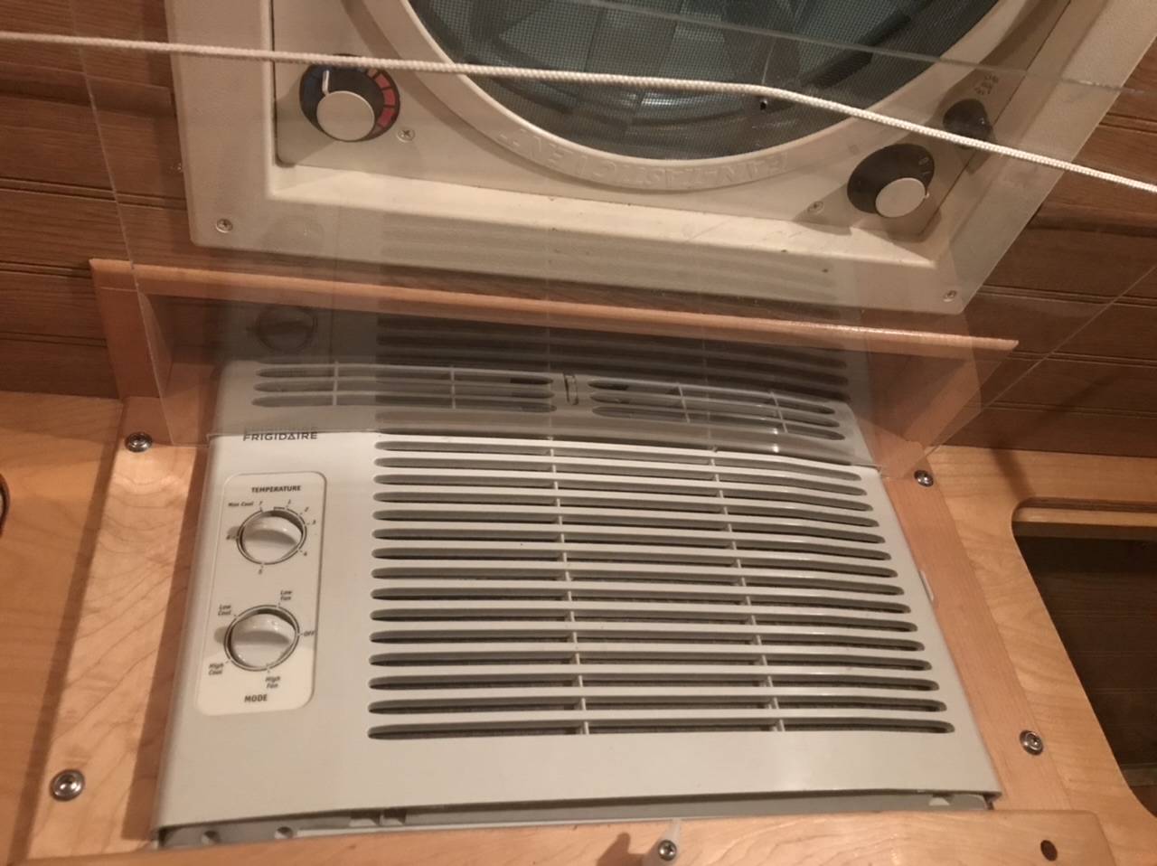

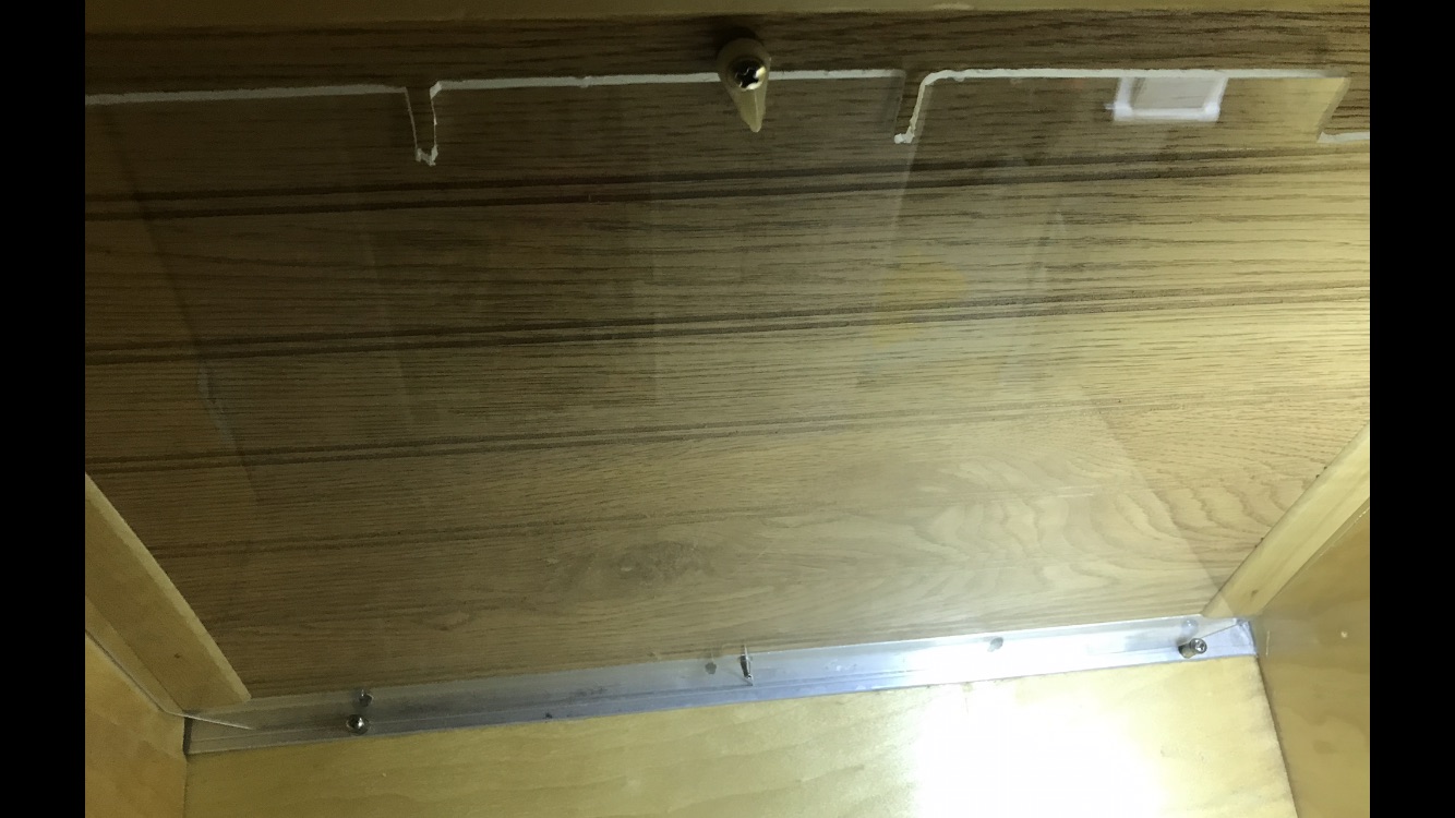

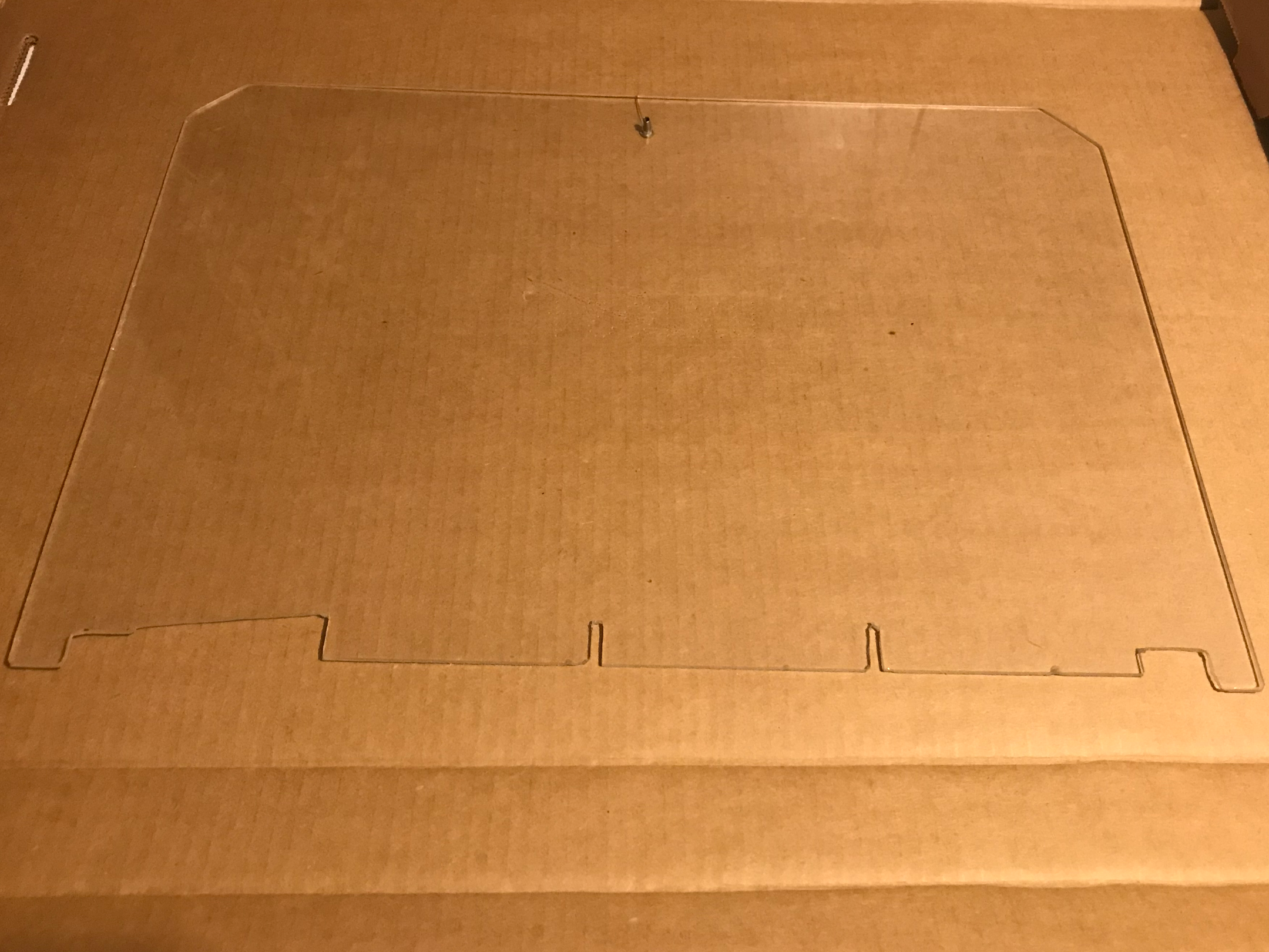

I made a nice diffuser/air divider which is invisible, with no holes in the ceiling. Yes invisible-see pictures.
It measures 12” x 17”+, and separates the cold air for a full foot before it comes tumbling down onto our heads.
It’s held in place by our tight clothesline and a single long pop rivet in the plexiglass.
It stows away in the ceiling of our upper cubby of our 550, so it doesn’t break. I had to use longer screws and drilled 22 shells in the back and a screw + nylon turn button in front to secure it for travel.
I’m even pretty sure it works better than the factory diffuser.

Nice Job and I am sure it will work as the intent is the same. We elected to get the wood one from the factory and have it attached so I don't have to deal with it.
Thanks Bill… I thought I should share. It took less than an hour. Didn’t know quite where it was going when I started.
It was a few years ago and it works great when we use the AC.
Easy to drive off and forget about it up there, since it’s invisible. Still, it stayed in place until I caught it later and stowed it away.
