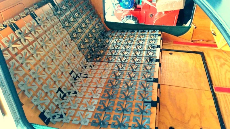

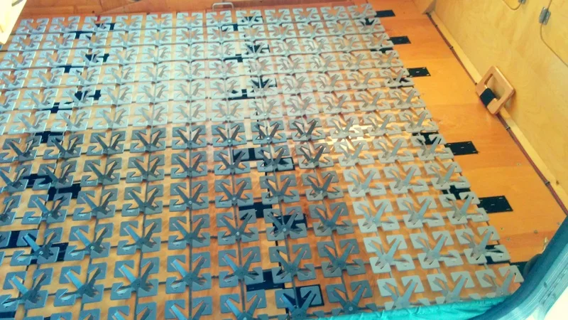

After reading the posts from others, I became interested in the Froli system, and contacted them this past January. I corresponded with Elke Nickle of Nickle Atlantic, the US Distributor, and she told me of an alternative Froli system to what is available on their website, that is geared toward the OEM market. It comes as a 13" square mat consisting of nine Froli springs connected together in three rows of three. They come in two firmness's regular, and firm, and each square costs $6.90. I ended up ordering 24, with a mixture of firm for my side except for the shoulder area, and regular for Kris's side and the rest. Elke told me the mats were comparable in firmness to the Froli Travel system. I ended up cutting some of the squares into smaller sections of 1,2,3, or 6 springs to fill smaller than full square spaces. I've attached the Froli Mat brochure as well as a couple pics below of it partially installed in our Camp-Inn. It was only about 25 degrees where I was working on it, but I did lay on it when I was done, and it definitely felt nicer for the little while I laid there, but I'll have to do an update when we have a chance to actually spend a few full nights on it. If it proves to be as comfortable as hoped, it will provide a significant savings over the Star or Travel systems currently offered on the website.

I'll have to do a follow up update on that too. I made joints in the mats to line up with joints in the sofa sections, and it doesn't seem to interfere with pulling it up into position, at least with the mattress off.
It has always been a little bit of a struggle pulling it up into the sofa position with the mattress on however, especially for one person to do, but I don't think it will make it much if any more difficult.....at least that's my hope. For that reason we don't use the sofa a lot, but it has come in handy a few times, like when we had three consecutive days of almost steady wind & rain in Bayfield, WI after leaving CICO '16. It was nice to be able to sit up and watch movies, read, etc.

The total cost on mine was about $175 including shipping, but I left about the last six inches of the foot area uncovered to provide extra toe room so you could add about $14-21 to that for total coverage. The Froli Star and Travel systems will both give you a bit more range of adjust-ability with their spacing options, and addable bands for increasing/decreasing firmness, so there are trade offs for the lower price, and easier installation of the mat system. With my custom sofa bed option getting to the under-bed storage requires getting the bed into sofa mode to gain access, but otherwise like Randy said, the mats could be cut to fit the covers for the regular camper without a sofa bed.
