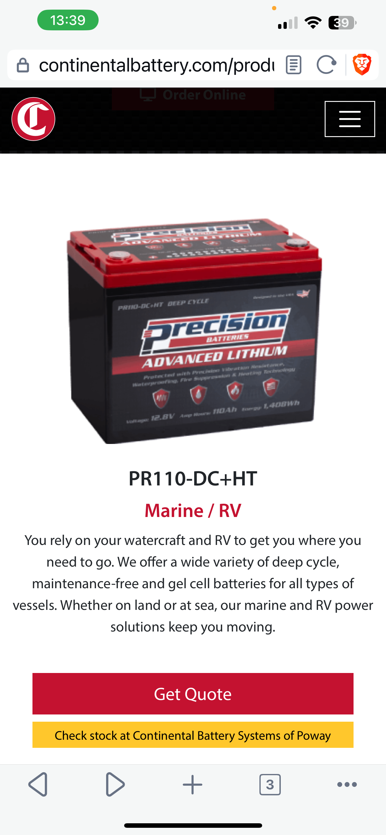

Might be a good time to get the info on local distributor we can get the same LiOn as CI puts in...
