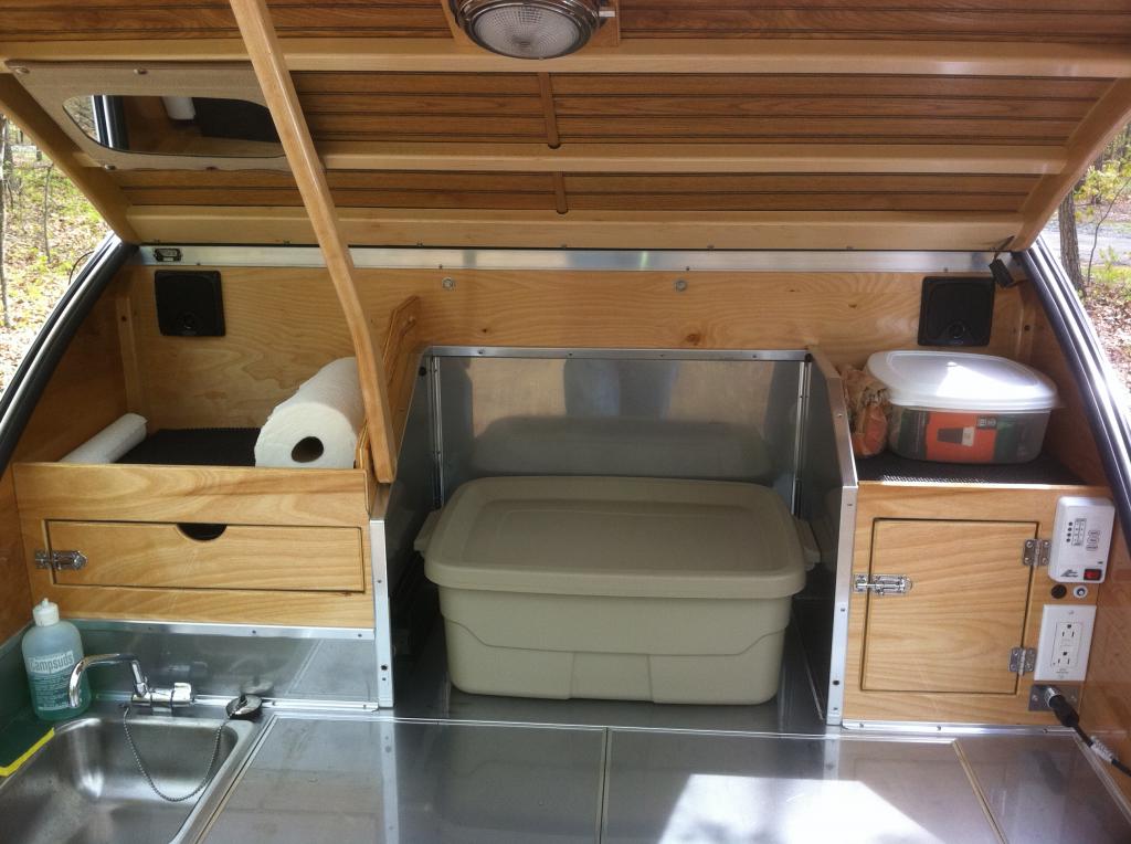

I buried the antenna Inside and it doesnt work well. The speakers in my kitchen are flush mount and backs protrude into upper cabinet completely outta the way. I would really like to share pictures with you because it may be perfect for you. However I do everything with my IPhone and it seems impossible.

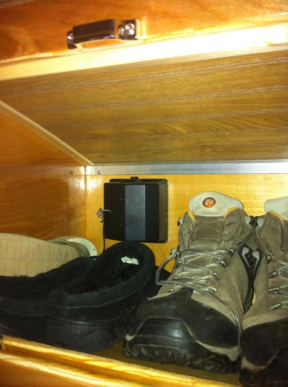

Here are Matt's photos. (Very slick install by the way - nice and simple). Matt - feel free to jump in and explain what we are looking at...
I plan to flush mount the speakers just like Matt did.

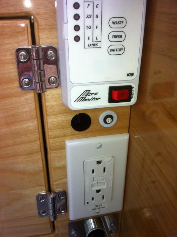

Thanks Evan for posting the pics! The headunit you picked is the same one I have. I used a powered antenna inside camper hidden behind cabinet. It doesn't work great, but does get the weather channels, but FM is weak. That is the only thing I am going to address in the future. The headunit is in a flush mount kit that crutchfield will give you for free, with purchase of headunit. Otherwise it works flawlessly with minimal power drain. The IR sensor is below pump switch. There is a spare remote in utensil drawer, it does all functions thru the IR repeater. Camp inn installed an extra cut off switch under tv cut off in cabin. They also installed speakers and terminated it all in the cabinet I installed headunit in. I like to just set I phone in there and it stays charged off the Jensen. I am not sure about a PA function but it may, you could host campground karaoke!

I use the fader a lot. I have kitchen on back and cabin on front. If I am out at kitchen I just fade to back, so if someone is in cabin watching tv, they are undisturbed. You could add another amp and power your PA from that?
