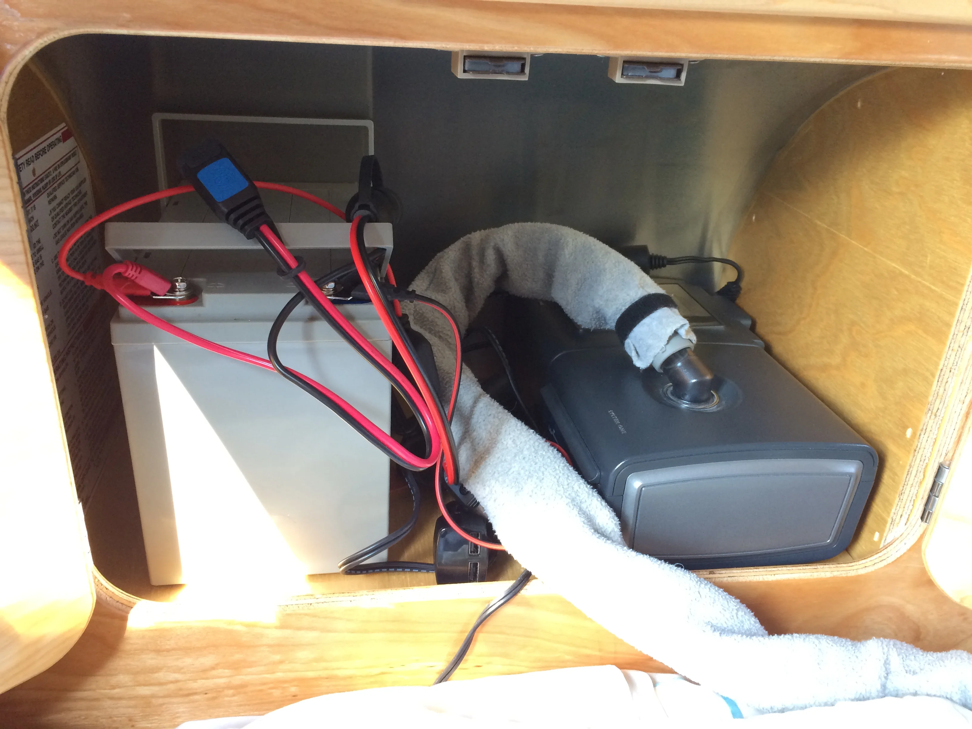

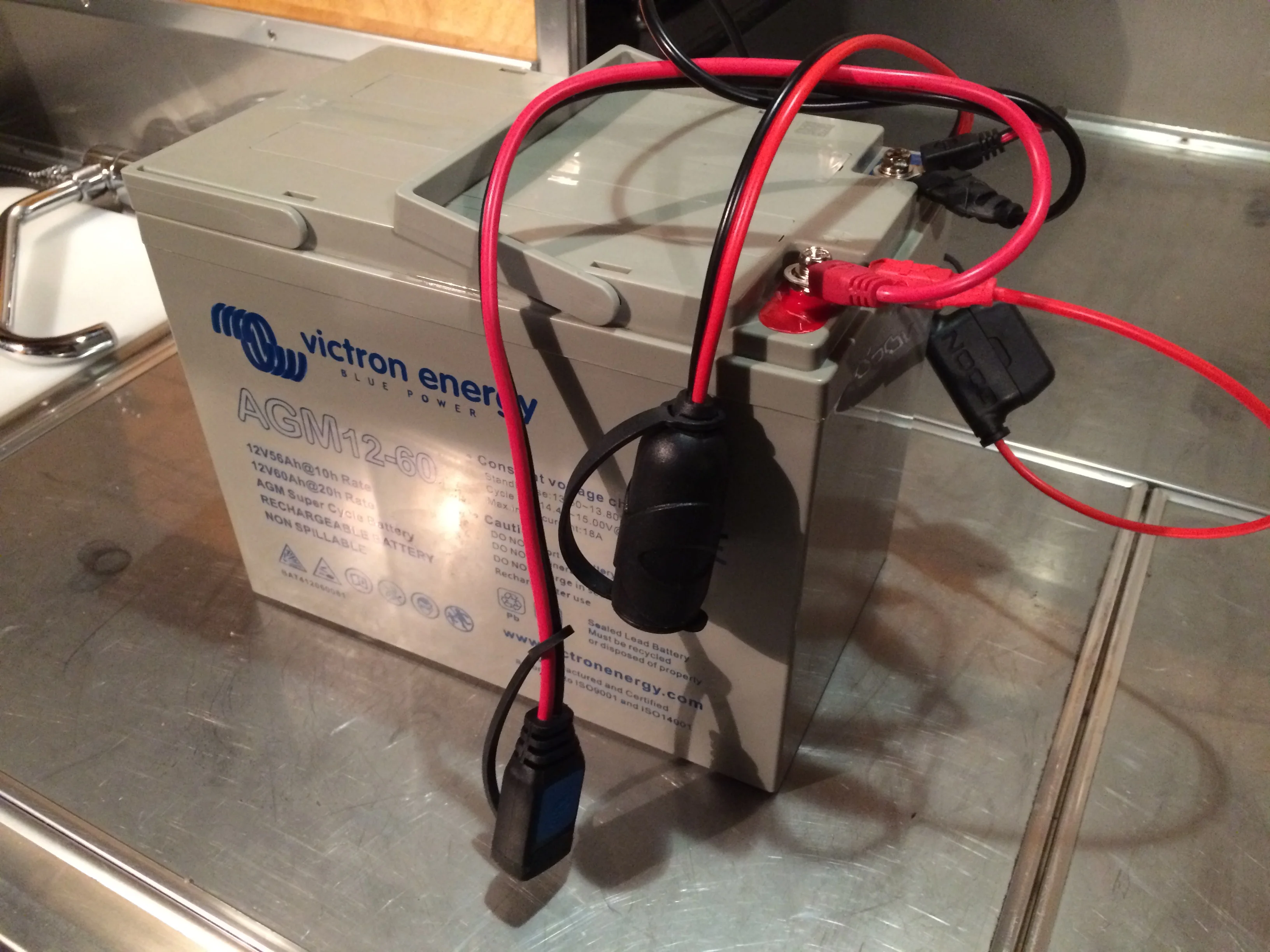

The new batt is small enough for the headboard cabinet in a 550, along with -either- its charger or the CPAP. It’s a 60ah Victron Super Cycle AGM, of a new design that can survive being drawn down to 100% DoD (depth of discharge, about 11.89v, but tested down to 10.8v). As I understand amp hour (ah) ratings, a conventional 60ah AGM would deliver about 30ah to 50% DoD as a general target. In theory, and as tested by Victron, I should be able to get 60ah out of it when needed, but a charge should be completed quickly after that.
(Which means that the conventional 76ah AGM in the CI would deliver about 38ah with good longevity.)
These Super Cycle AGMs are in short supply; I had to wait 6 weeks. I purchased a Victron charger at the same time. Recommended is that chargers’ capacity should be about ah/5, so, for 60ah a 12amp charger. I purchased a Victron Blue Smart 12v/10a charger, biggest I’ve owned, I can check the stage of charge cycle via bluetooth from a smartphone.
That batt & charger ran about $290 with free shipping from Jamestown Distributors. This was a special order; the batt and charger don’t appear on their website. Yes, the Victron line is oriented towards marine use.
Per theory, I’m using about 6.8ah/night on my CPAP, or about 34 per 5 night off-grid trip. That would seem to give me a significant margin, but with only 1 night out since I got the new rig, I don’t have enough experience to validate that. That’s the design goal, hope it works out that way! I really should do some serious monitoring, as Rotus8 recently posted. Another winter project!

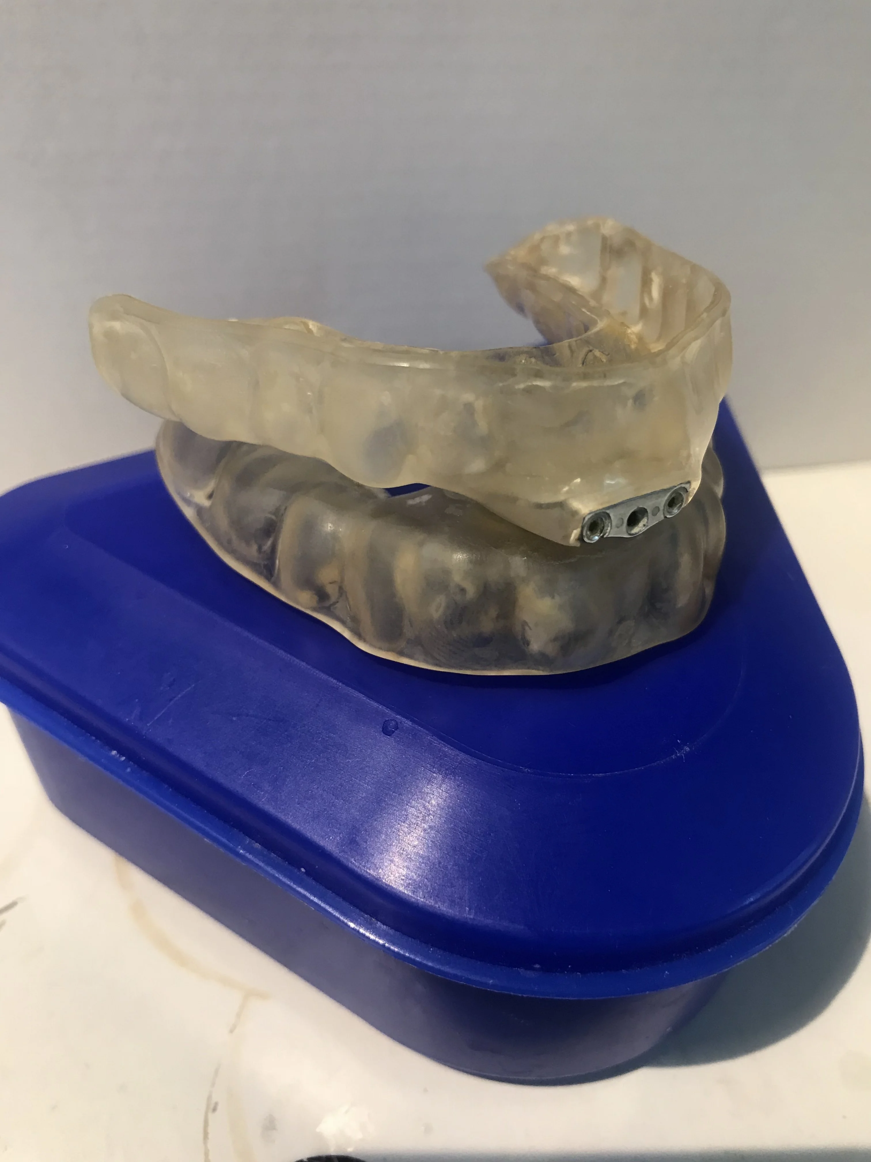

This suggestion is probably not helpful, since you already have the cpap, but something to consider once it wears out. I have a mandibular device that does not require batteries and works by holding the jaw forward to keep the airway open. Works for me. Without it I would be a sick puppy and not be able to go RVing or backpacking. Basically gave me my life back!
Thanks! I've got one, too, but it isn't a real solution for me, it seems. But I keep it around to use in an emergency as it may provide some help.

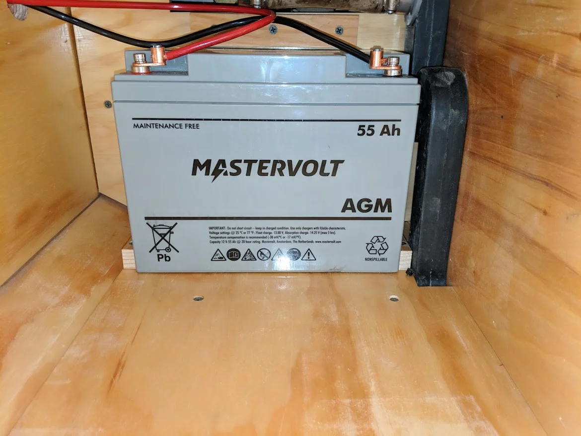

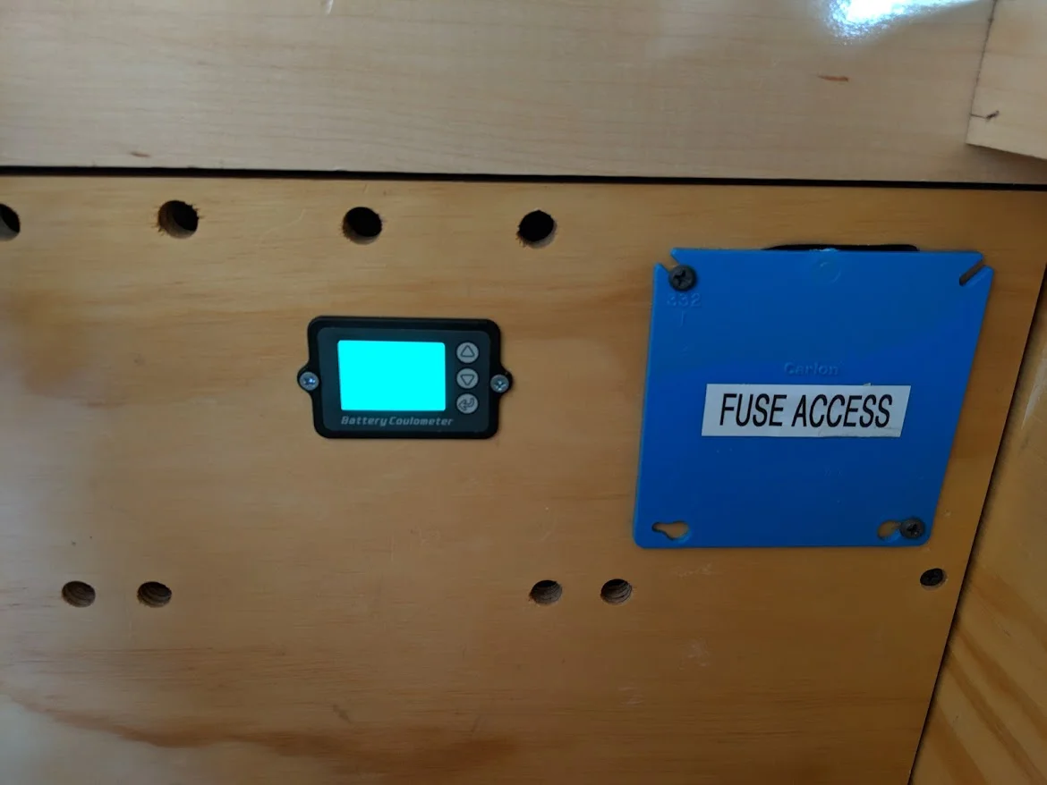

I recently installed a 2nd battery under the sink (and bought a matching battery for the battery bay). I now have two 55ah AGM batteries running in parallel. We have an aux battery setup in the TV and rarely pull the fridge out and plug it into the TD, so 80+ usable AH's should last us quite a while. I also added the coulometer that rotus8 profiled a few months ago. I installed it near the fuse box cover on the removable battery panel/cover.
You could easily add a larger AGM dual battery setup (or LiFePO), leveraging the space under the sink. 110ah is all we needed.
