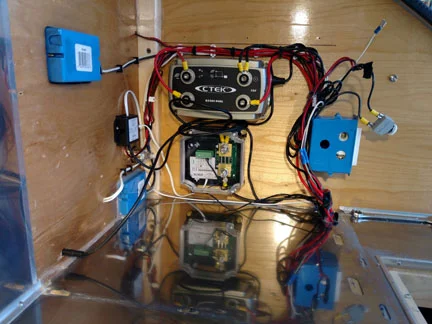

Here is the final wiring before the cabinet goes back on:

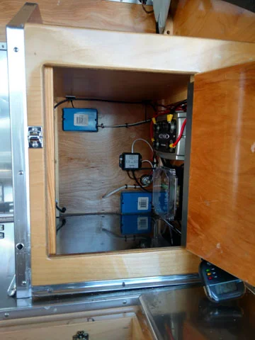

Cabinet installed and a view looking in:

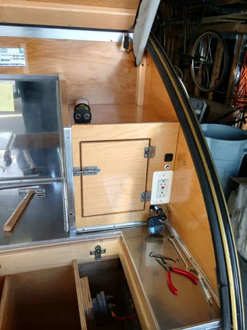

Outside of cabinet with the old battery/tank monitor removed and a switch installed for the pump:

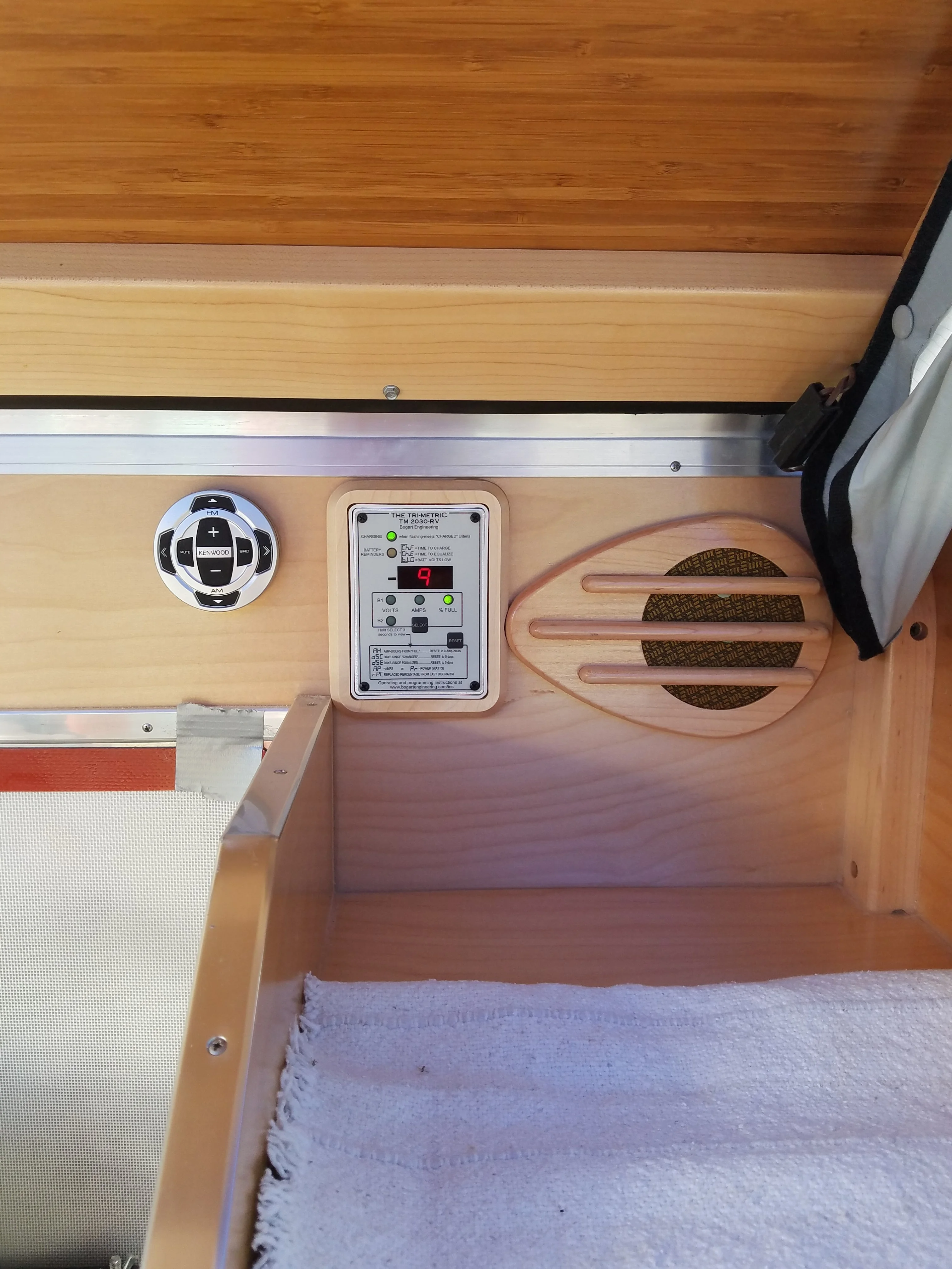

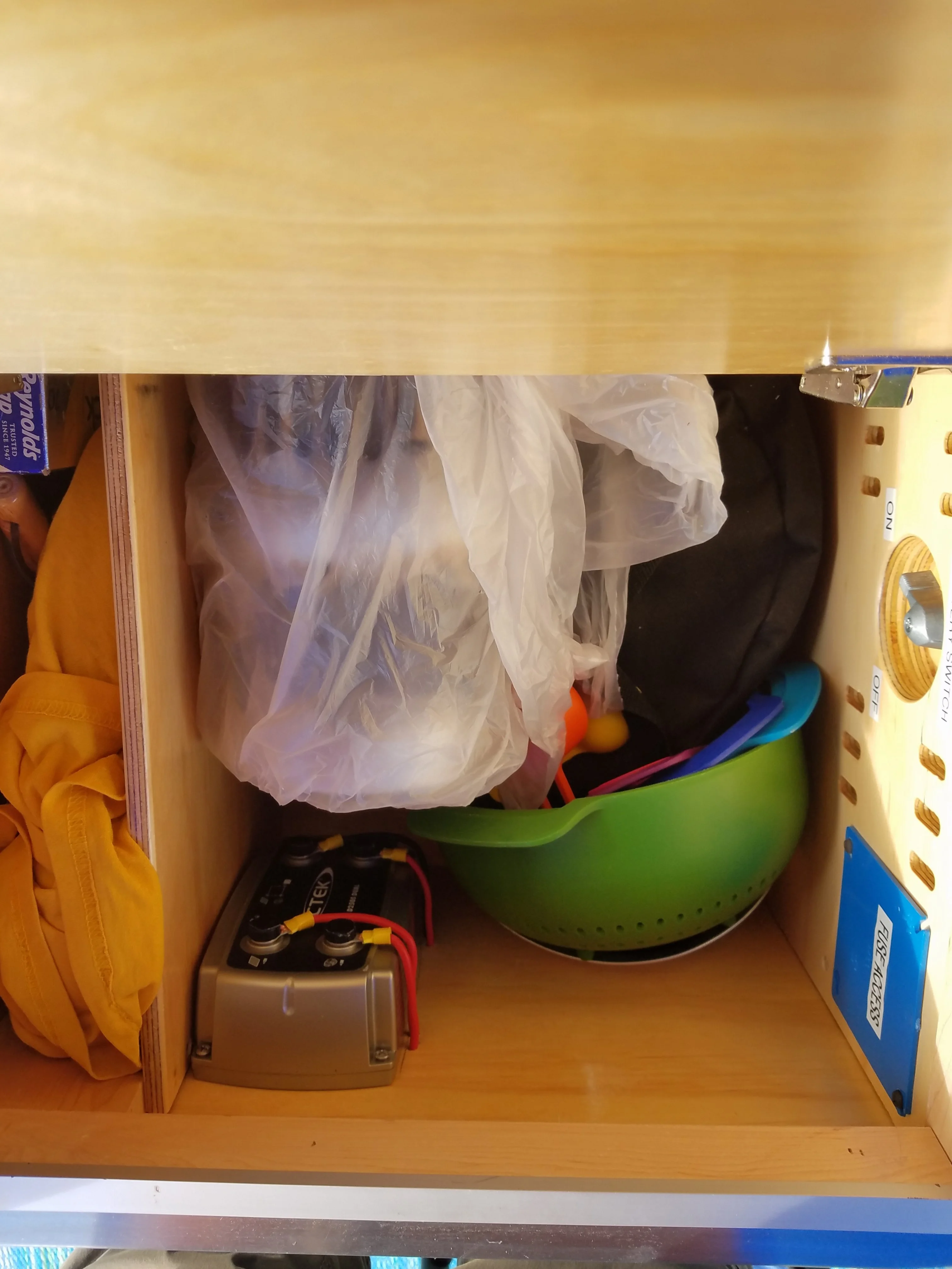

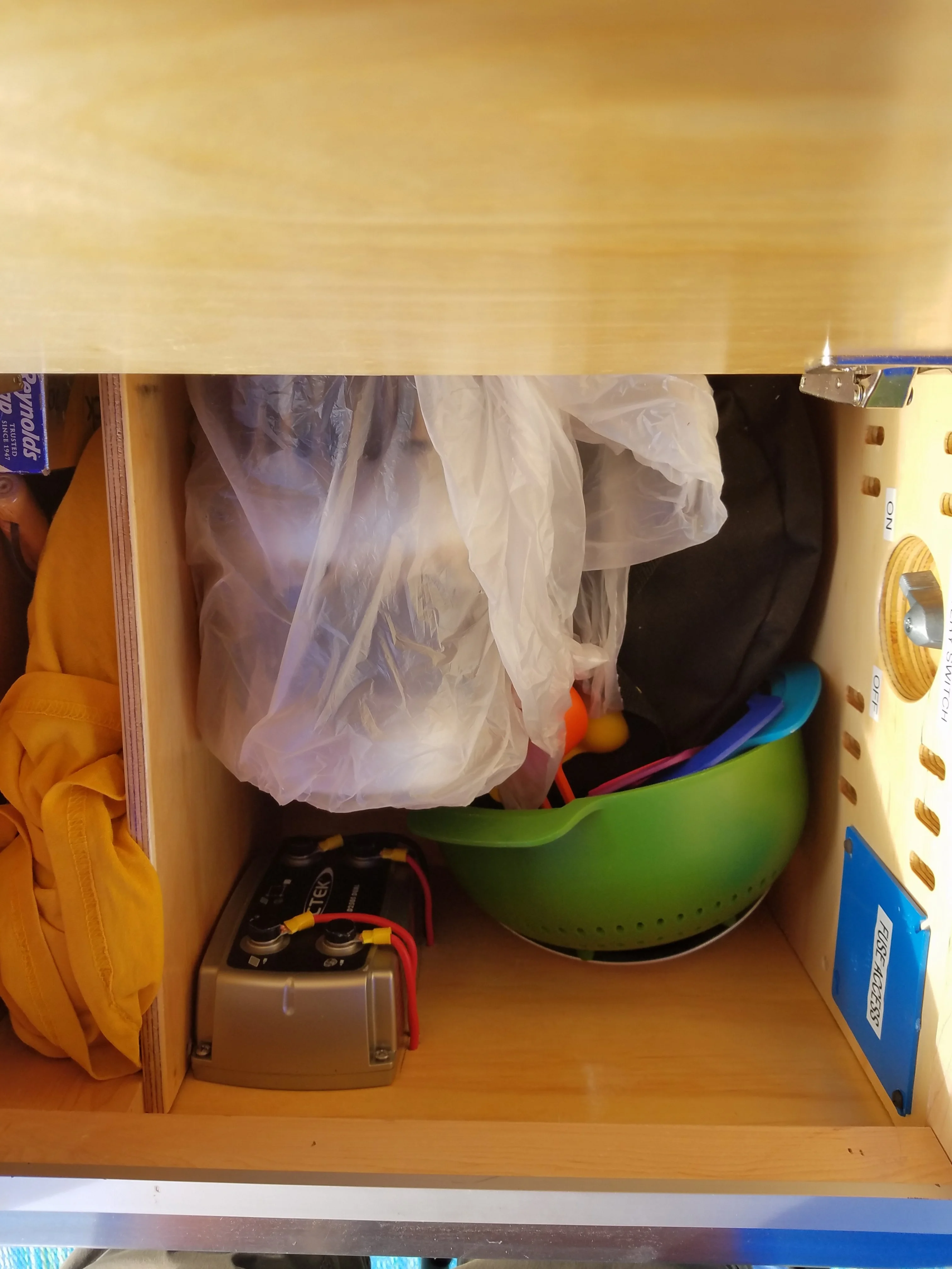

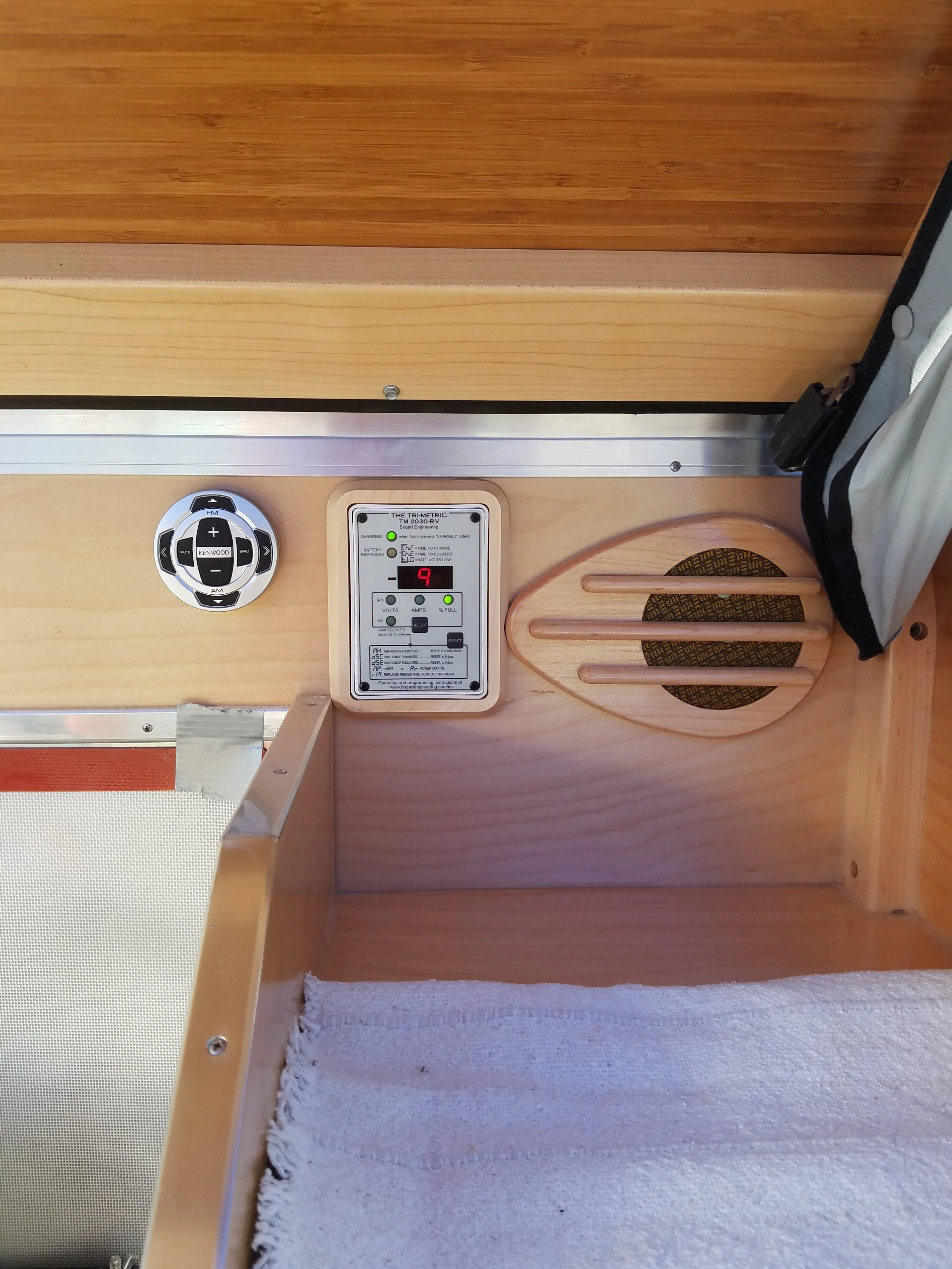

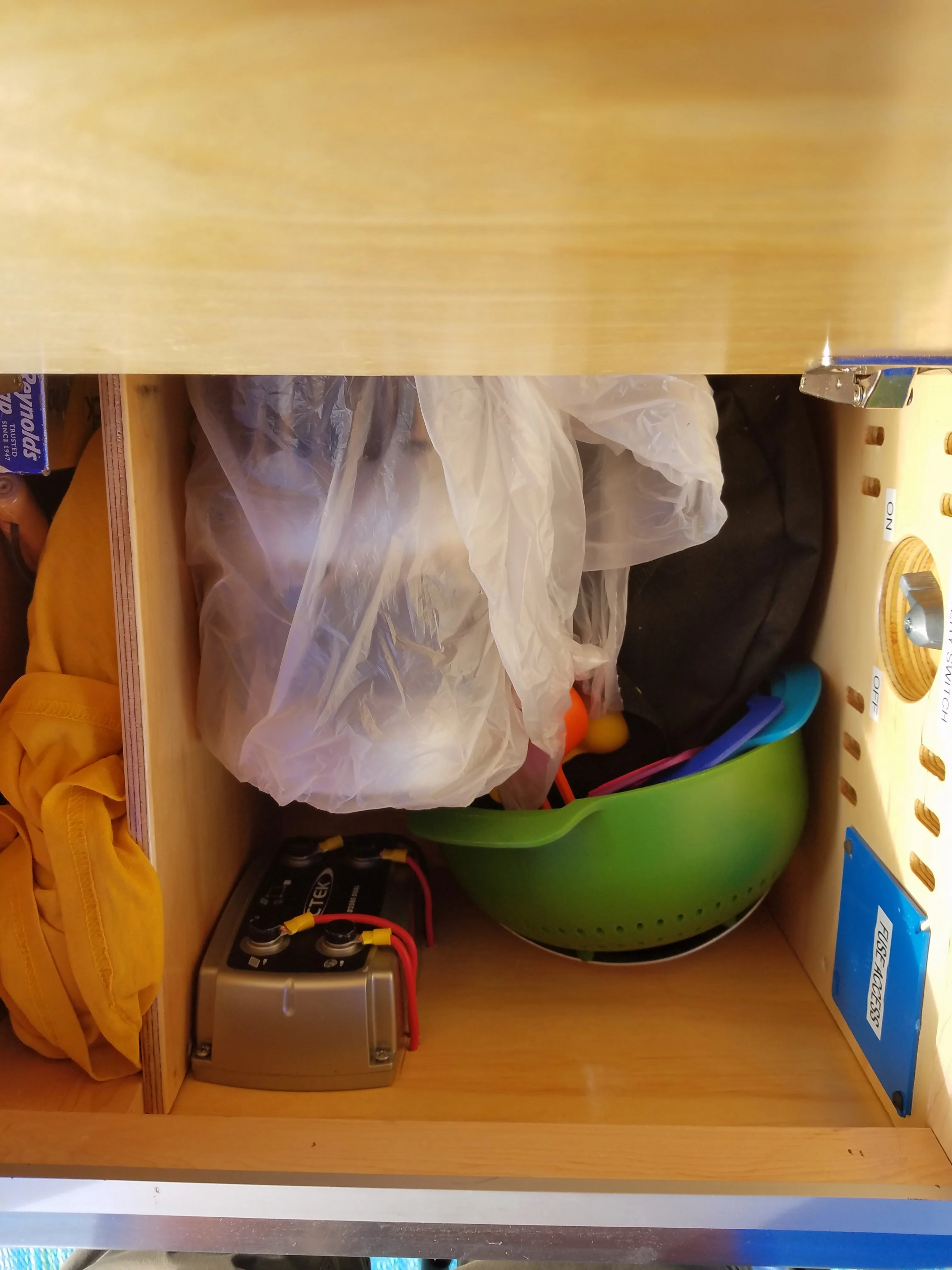

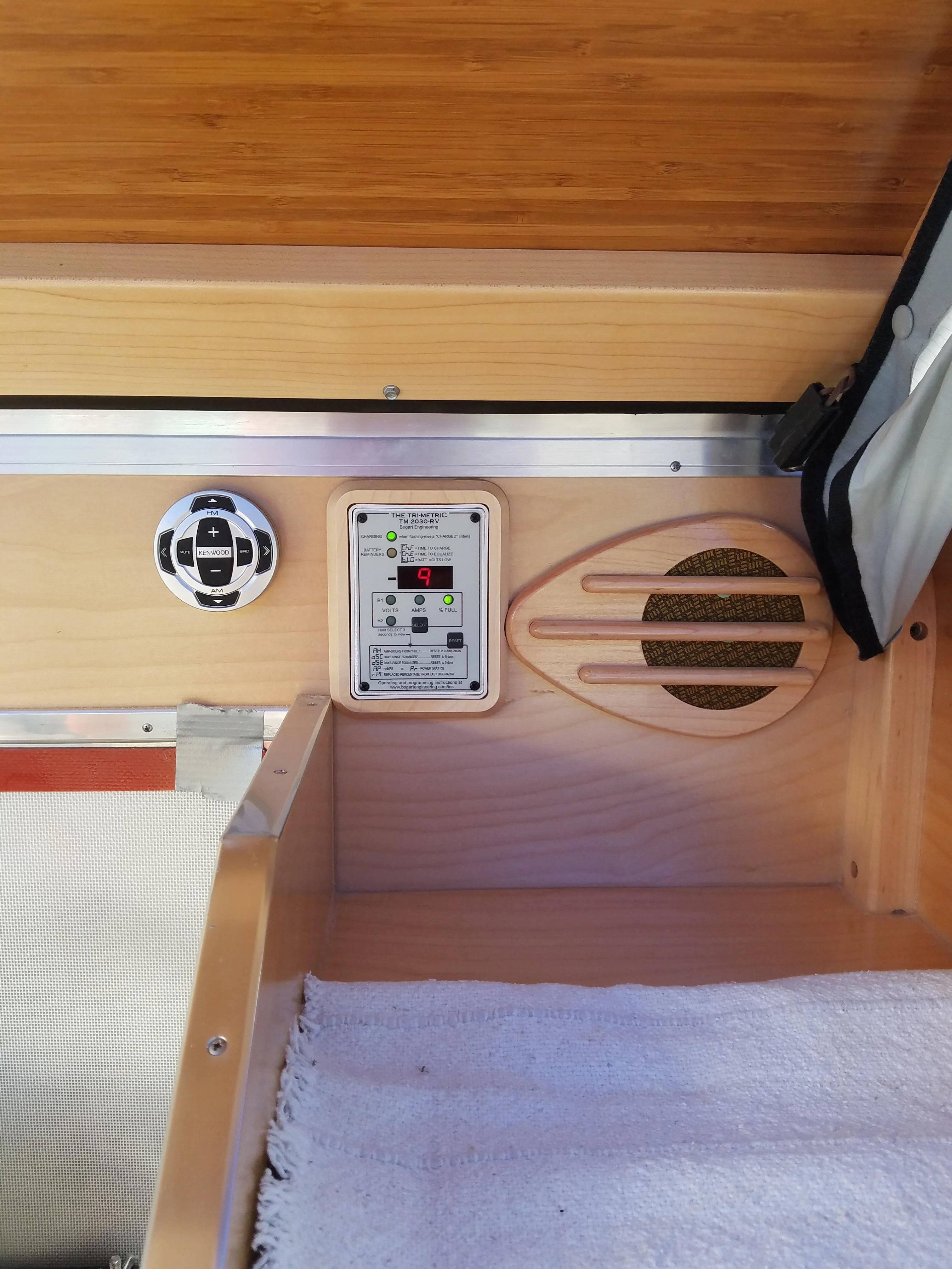

CampInn, primarily Craig and Mike recently competed a few upgrades on our 560, WALL-E. They added a TRIMETRIC Battery Monitor and the CTEK charger. Did a great job on both. Also added a new battery, switched out our 1.25" hitch for a 2". As always their craftsmanship and customer service was excellent. They even shared their rapidly expanding mosquito population as camped at the factory the night before.....15274617601681798521293.webp 1527461860156377998969.webp

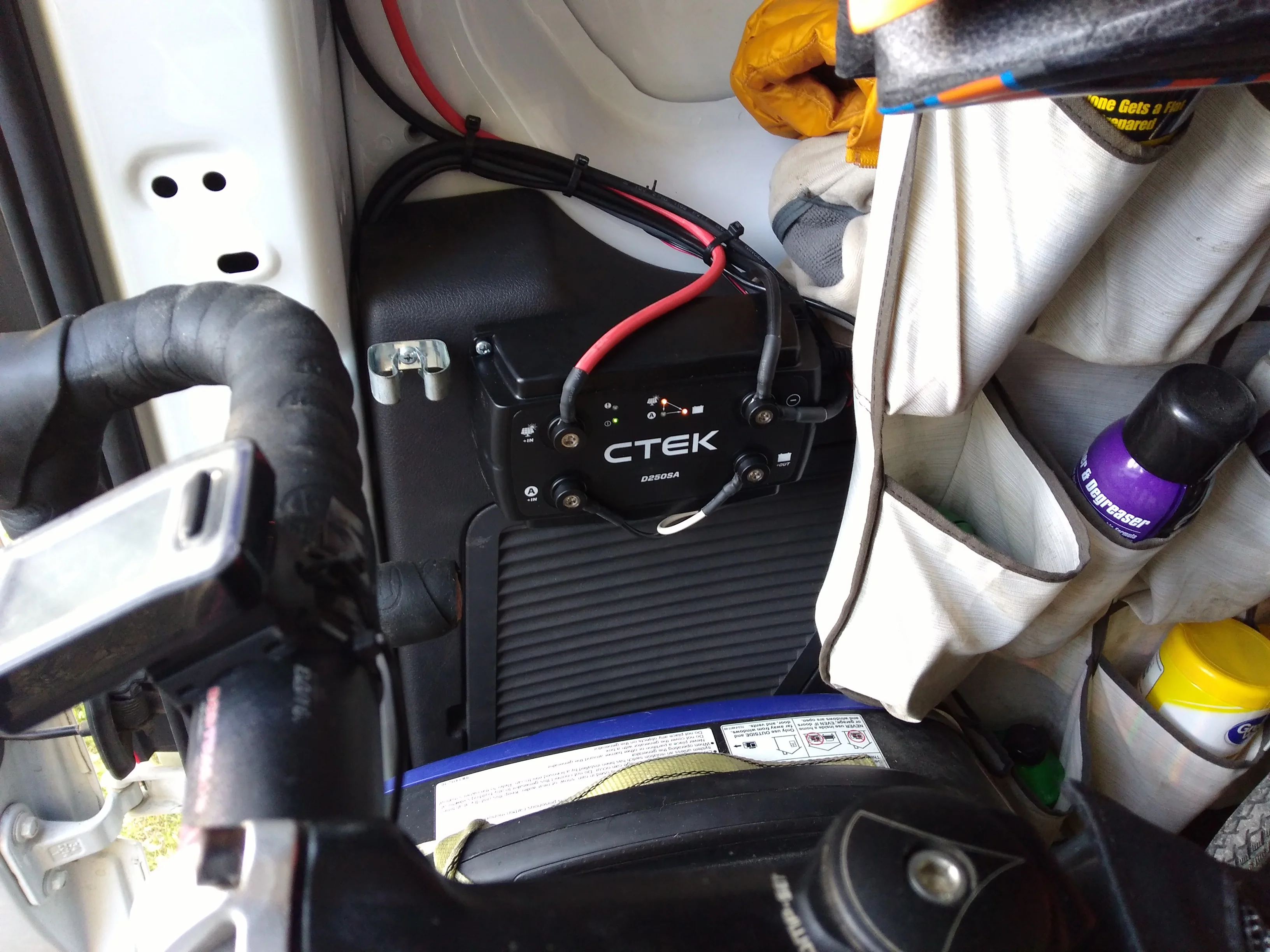

Randy, if you look closely at Ron & Missy's second photo, that's the CTEK D250 DC/DC charger. It will use the alternator output of the TV, but instead of just whatever the alternator puts out, it will vary voltage and current to the CI battery to a proper charging profile.
Just like the stock CI charger does... only with alternator/TV as the source when you're on the road. So, it doesn't replace the stock CI charger, which would still be used when near a 110v AC source at camp or home.

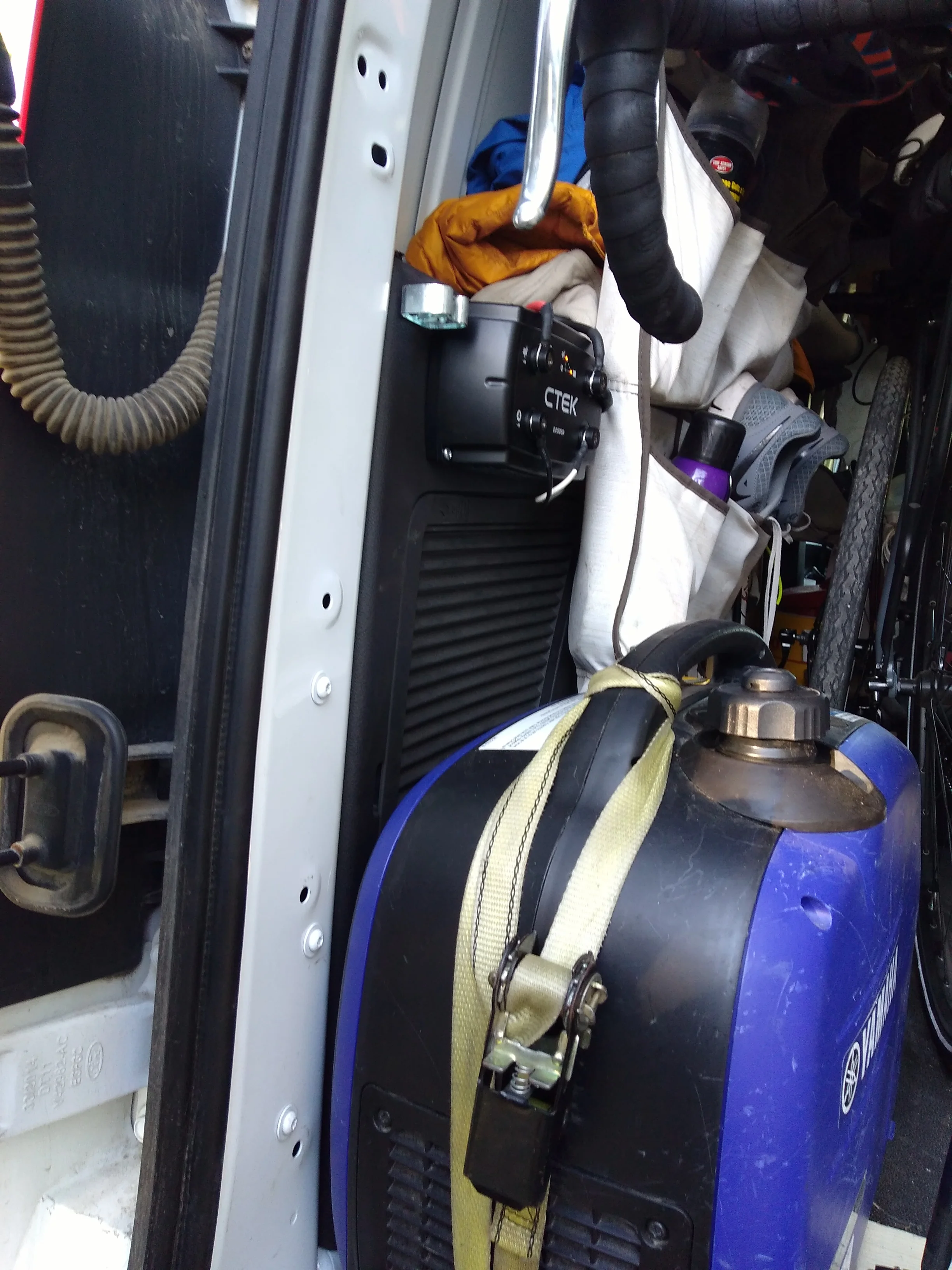

Here are a couple of pictures of of the CTEK installed in the rear of our van:

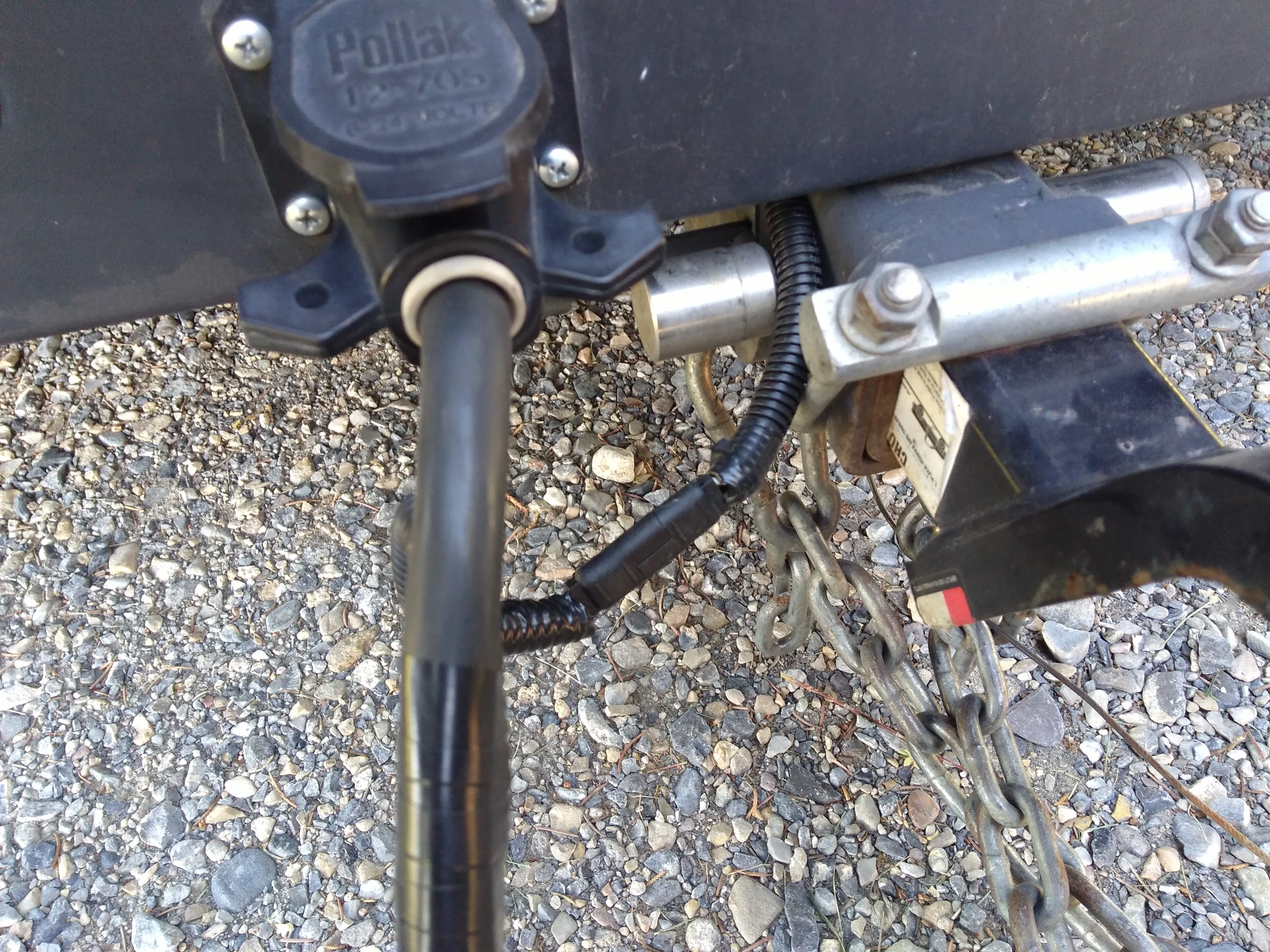

We had thought about using the back-up light wiring to extend the temperature sensor wiring to the battery compartment, but the guys at Major Tire & Hitch recommended a separate two-pin connection, which is piggybacked on the 7-pin pigtail:
The mess of wiring that cluttered our engine compartment (solar wiring, battery isolator, relay switch and a tangled mess of fuses) has all be removed. All that is left is the charge line and its fuse. I love the simplicity of this setup!
