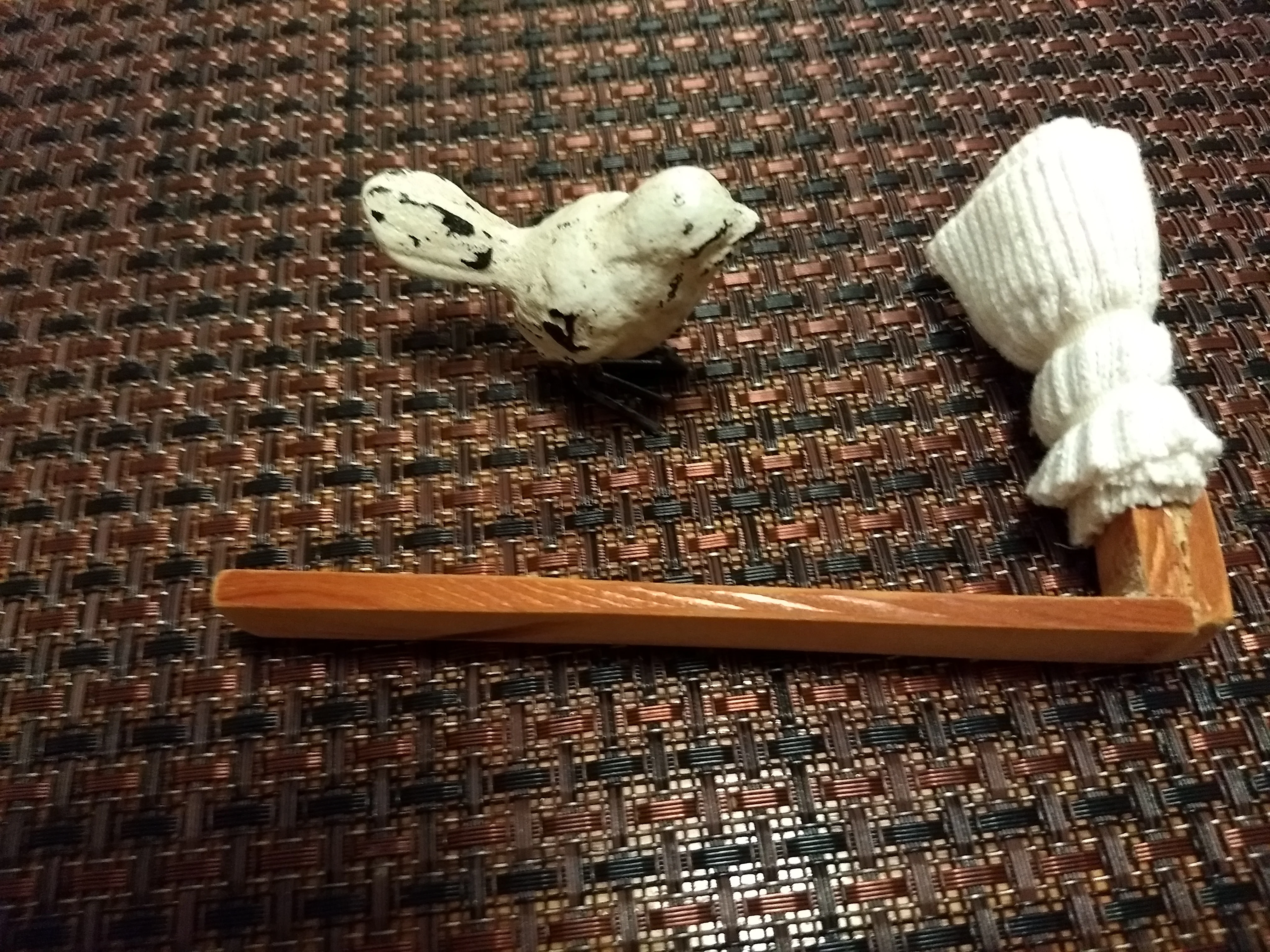

During the hot humid FL nights the AC is a blessing but as the evening cools I would like to turn off the AC and run the Fantastic Fan. Problems is the AC results in enough condensation forming on the rain sensor that it will not open. Those muggy nights of Florida! My fan does not have a sensor override switch and the only solution I can think of is fashioning a tool to dry the sensor from inside the TD after removing the screen or hitting the sensor with a hair drying blast. Do not wish to engineer an override switch as I wish to use the sensor as designed. Any other suggestions?
After some thought I fabricated the pictured rain sensor dryer using an old sock top, some wooden shims, zip ties and gorilla glue. Remove the fan screen and reach through the fan blades to dry the sensor. The birds in the picture is just a metal bird and has nothing to do the the tool pictured.
