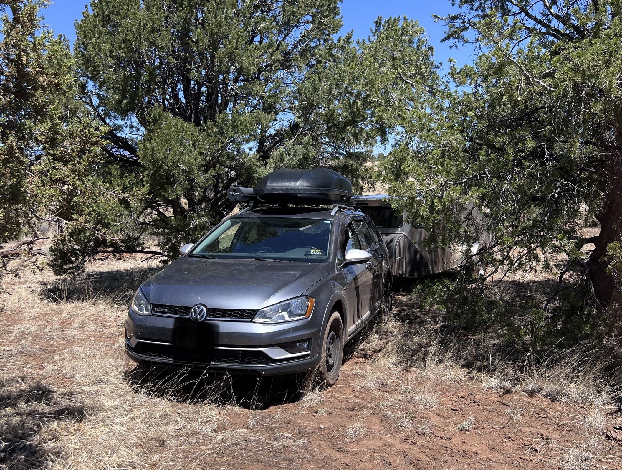

    and I'm about to try what you're doing: adding an external 100w panel with a 25' extension to where that panel can be propped up in the sun, while the trailer is parked in shade under a tarp, or desert trees that can be sparse or tricky to get under while boonbocked, (see pic)
    or in desert area campgrounds where the hosts insist you stay on the pad...in the sun, under tarp.
