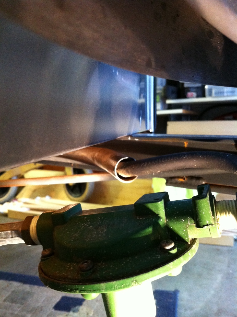

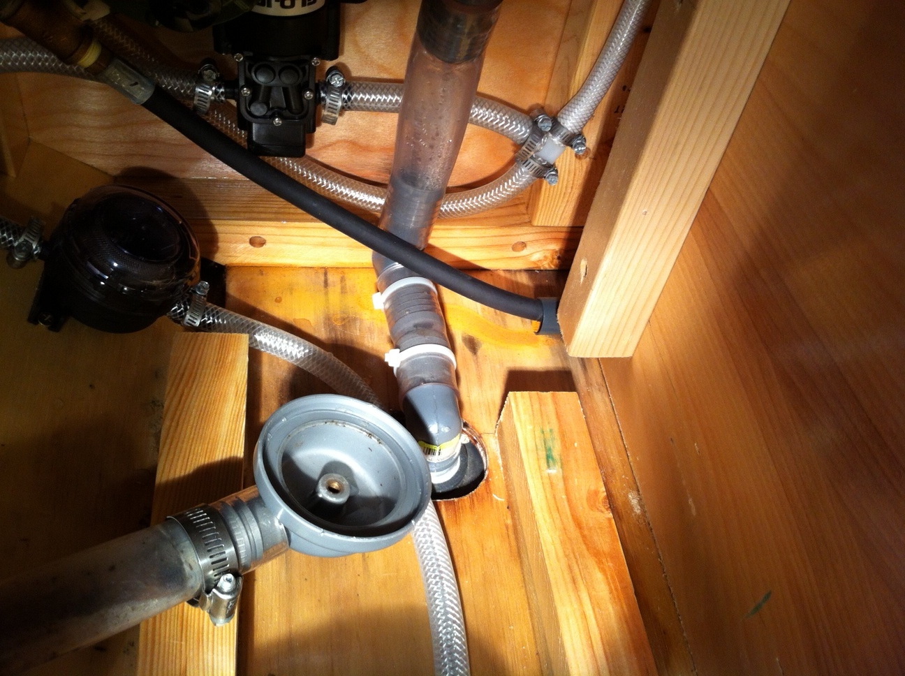

Just a little something we noticed today, while Mick was working on a project on Dottie. He had pulled up the false floor in the galley bin, under our sink. I noticed the wood had been wet. Upon further inspection, it seems the water is coming through the hard pipe the LP line runs through, and into the galley.
Here are a couple of pictures to show what we saw:
The pipe there, where the LP line runs in, is collecting the water, probably as we drive
It goes down the pipe, and empties into the bin under the sink
Has anyone else had a similar issue? Mick is planning to use some silicone to fill up the hole near the LP tank to keep the water out. Is this the recommended course of action?

The LP line is a flexible line, that they have placed inside a stiff metal pipe (I am guessing this is for protection and to keep it up against the underside of the trailer). The LP line is slightly smaller than the pipe, as you can see best in the first picture. It looks like water has been working its way down the protective metal tube into the galley bin. In the second picture you can see a copper coloring that looks like it has run across the wood (and has stained the inside of the pipe as well), right where that metal pipe comes into the galley bin. This is where the most 'wet' was seen, but has spread a bit from there.

Jim says water could be entering the copper pipe near the tongue when the CI is towed in wet weather. The gap between the copper tube and the LP line allows water from the road to be forced through the gap by the air flow. The water pushes up the copper tube to flow the other end into the under galley storage area.
Possible solution: a little silicon sealer to fill in the gap. But Craig or Cary would have to check it out to see what the real cause of the water is for your CI. Jim is going to check on ours the next time it is out of storage...

Mick filled the external end (near the LP tank) with silicone to keep the water out. He thinks it has been doing this for a while, and it would explain why my barometer was always saying it was going to rain when I opened the hatch to the galley (I keep it on a shelf there...and there was a lot of condensation on that side as well). But then, we live in Oregon and we are always in the rain! We get to camp in the rain this next weekend, in fact (I am just jonesing to get back out...I am missing my little camper after being out with her for two weeks straight...having a hard time adjusting to being home!).
