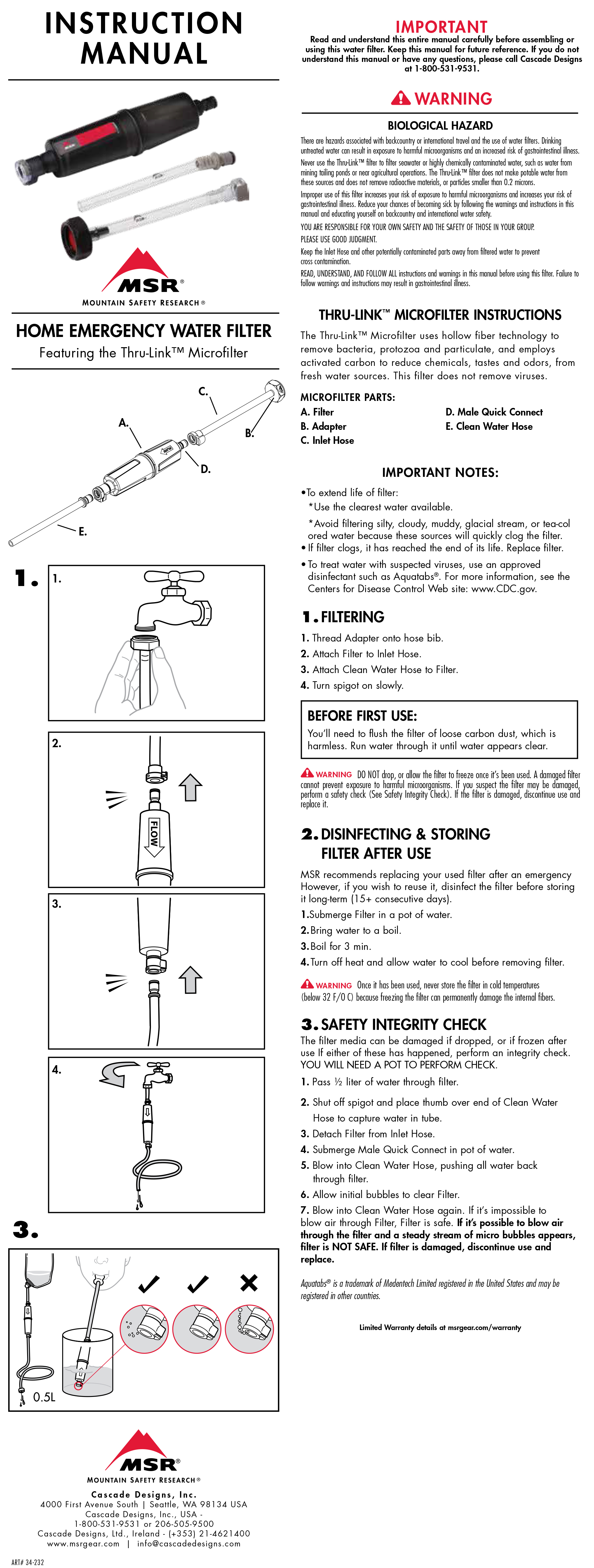

  1. I found a single in-line 2-stage filter that would remove pathogens at the 0.2 micron level (i.e most things that could start growing or living in the tank) coupled with a carbon filter that removes chemicals and improves taste:
    MSR Emergency Home Water Filtration System | MEC
    Good for 1000 litres of clean water filtration, which translates to about 30 tank refills, or... lots. This would also remove any doubt about whether or not your tank sanitation was good enough in the first place, or that the water quality hasn't degraded since that time, but you still wish to (or have to) drink from the faucet.
    Since it's a compression fitting plug-and-play connection at the filter ends, switching out to a new one is easy, as long as you have already solidly tapped into the trailer plumbing like Dave and Linda have. Regular removal for winterizing or non-use for 15 days is necessary. Sterilize by boiling for 3 minutes. Won't play well with antifreeze. There's more here:
    This would certainly eliminate the pesky storage and transport of containers dedicated strictly to drinking quality water. (I had a jug blow out on me recently and soak the galley and the bed.) The only downside I can see is that it may require topping up the trailer tank a little more often, and of course, the maintenance routine; it's not an install-and-forget device. Removing it without draining a small amount of water from the lines into the bin could take some practice.
    Since this is meant for home water system pressures, I can't speak to what sort of back pressure this may put on our tiny RV water pump and if it may overly tax it. I may give the project a go in the spring. If it's not a good fit with the trailer from a pressure or maintenance standpoint, I'll have a home backup unit for an emergency. I have no doubts about the 0.2 micron filter making even a pretty nasty tank drinkable again since that is the industry threshold for almost all backcountry filters, though many devices do go smaller than 0.2. However, I still won't abandon my semi-regular tank-cleaning regimen. Starting with the cleanest source, whether it is a stream or the tank, is always the best and makes the filter last the longest.
    If you need more clarification or assurances about the difference in pore size and what they filter out, this explains things fairly succinctly: Backpacking Water Filter vs. Water Purifier: What’s the Difference? | MSR
