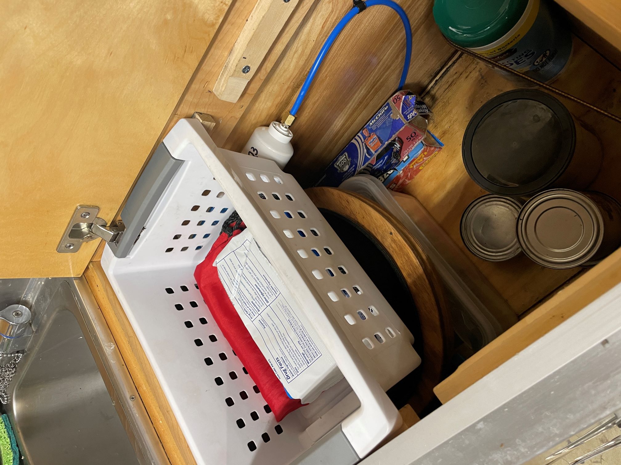

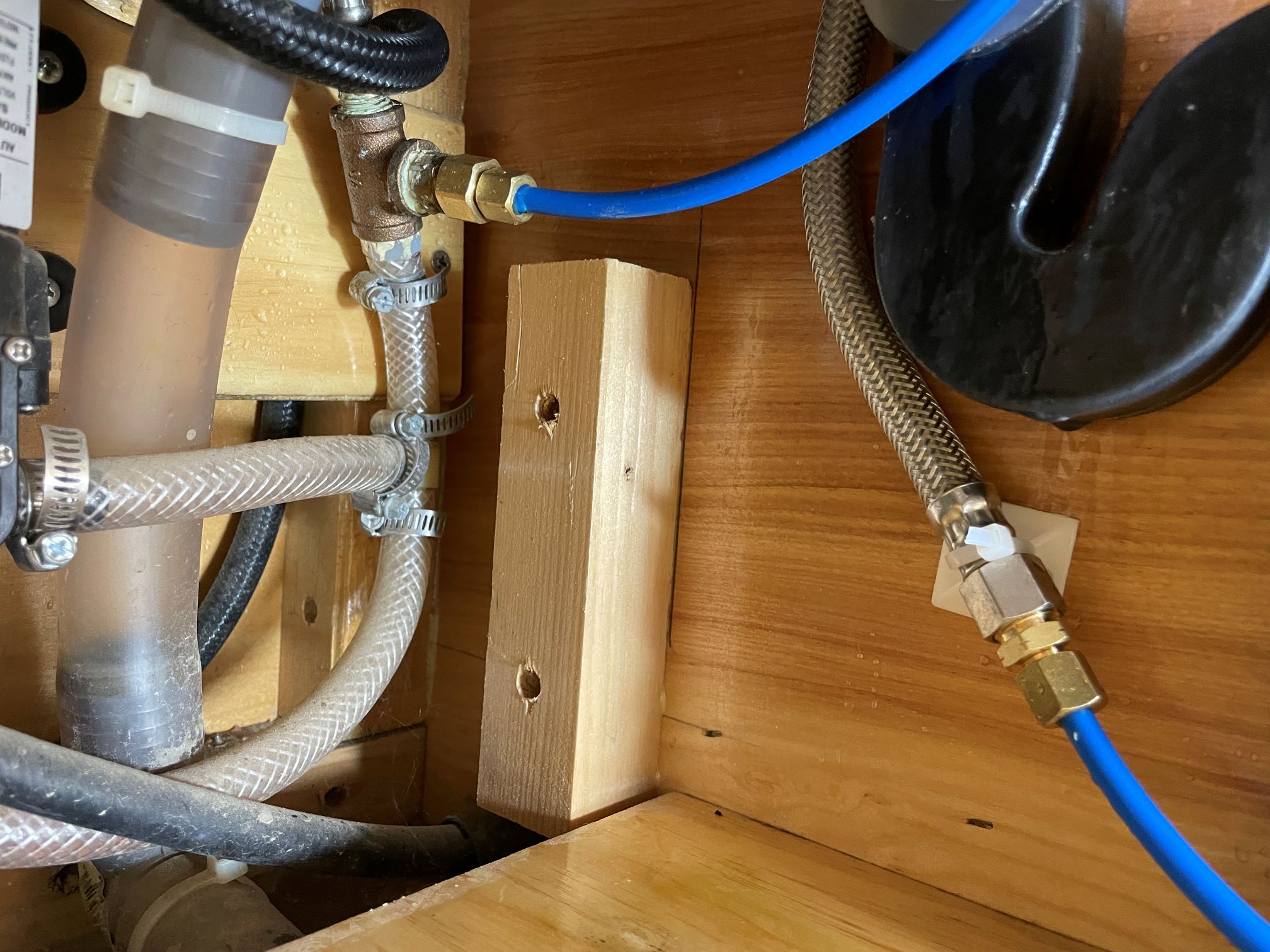

    Looked to see if there was a thread on this yet and couldn't find one. This is my second installation - the supplier for my first changed the way their filters all hooked to the water lines and only had the vertical mounts available now. So I switched to this configuration. Basically I only filter the water to the faucet - not the spray nozzle - so connected to the brass tee that goes to the faucet and they used refrigerator type lines and connectors for connecting the filter. I mounted the filter low enough on the back wall that my accessory baskets still fit. See photos for more details. I know most all water is safe but this just adds a bit of assurance as we travel around the country to different spots.

    this is awesome info. I've thought about a water filter for years, mainly for taste. What do you do when you winterize the water system?

  3. Dave and Linda: What are you trying to filter for? Taste, particulate, or pathogens? Of which there can be many, with a variety of solutions and resultant efficacy.
    If I read your post correctly, you are sourcing clean water, adding it to the clean tank and drinking it after it passes through the single filter. If so, this can be problematic for a variety of reasons.
    Sanitizing RV clean water tanks to the point where they can reliably counted on for drinking and not making you ill can be difficult, or at least, overly time-consuming and/or require frequent sessions. When water leaves the tank, air replaces it and can bring with it a host of new tenants, from bacteria and mold to Legionella. A sanitized tank and potable water can stay that way for only so long. Heat from the road and environment can supercharge this concoction. I haven't proofread this one thoroughly but it is among a plethora of sites that warn against drinking RV tank water:
    The RV Dilemma -Drinking Water on the Road
    Removing those pathogens from the tank to make it potable requires a complex system not unlike our home well-water system, which uses a particulate filter, UV light, and finally an RO system. This is something that can not be accomplished with one in-line filter, and is a system that would be impractical to install with our trailer set-up.
    I couldn't get the specs on your particular filter but it would have to be a 0.2 micron to offer any sort of practical pathogen protection. That is the standard for backcountry water filters. 0.1 is better. I even have a 0.02 for third world travel, whose viruses are different from North American viruses and even trickier to filter out. From what I can tell, your filter is commonly used for an in-line fridge ice-maker which will remove fluoride and improve taste only. The water needs to be potable first for it to improve the water in any capacity.
    Many, if not most on the forum, keep their drinking water separate from the tank water, and use the tank water for clean-up and doing dishes. Which under most circumstances wouldn't require a filter of any type or purpose if you routinely empty, sanitize and fill with clean.
    I hope I didn't misinterpret your post. If I did, and you don't consume the tank water, hopefully this will dissuade others from partaking in the potentially evil brew.

    You are correct, I only use potable water in the TD. I am careful about sanitizing the tank and we have always used the water for drinking. The filter is a .5 micron carbon block type and handles PFAS, PFOA/PFOS, rust, some chlorine... but not pathogens. I carry a .
