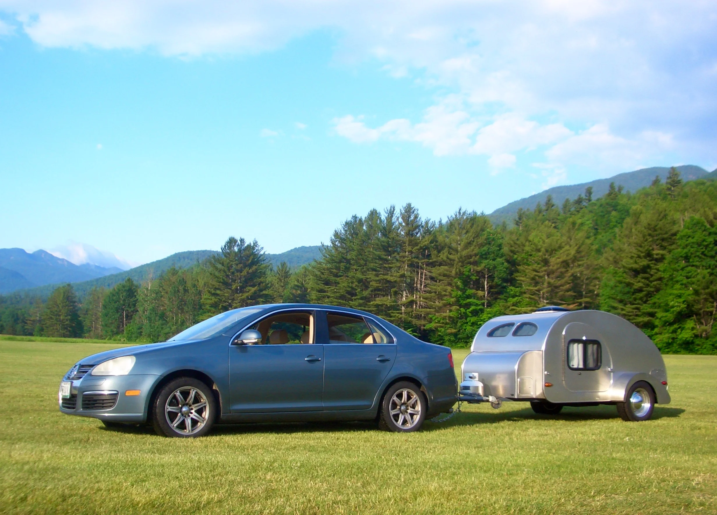

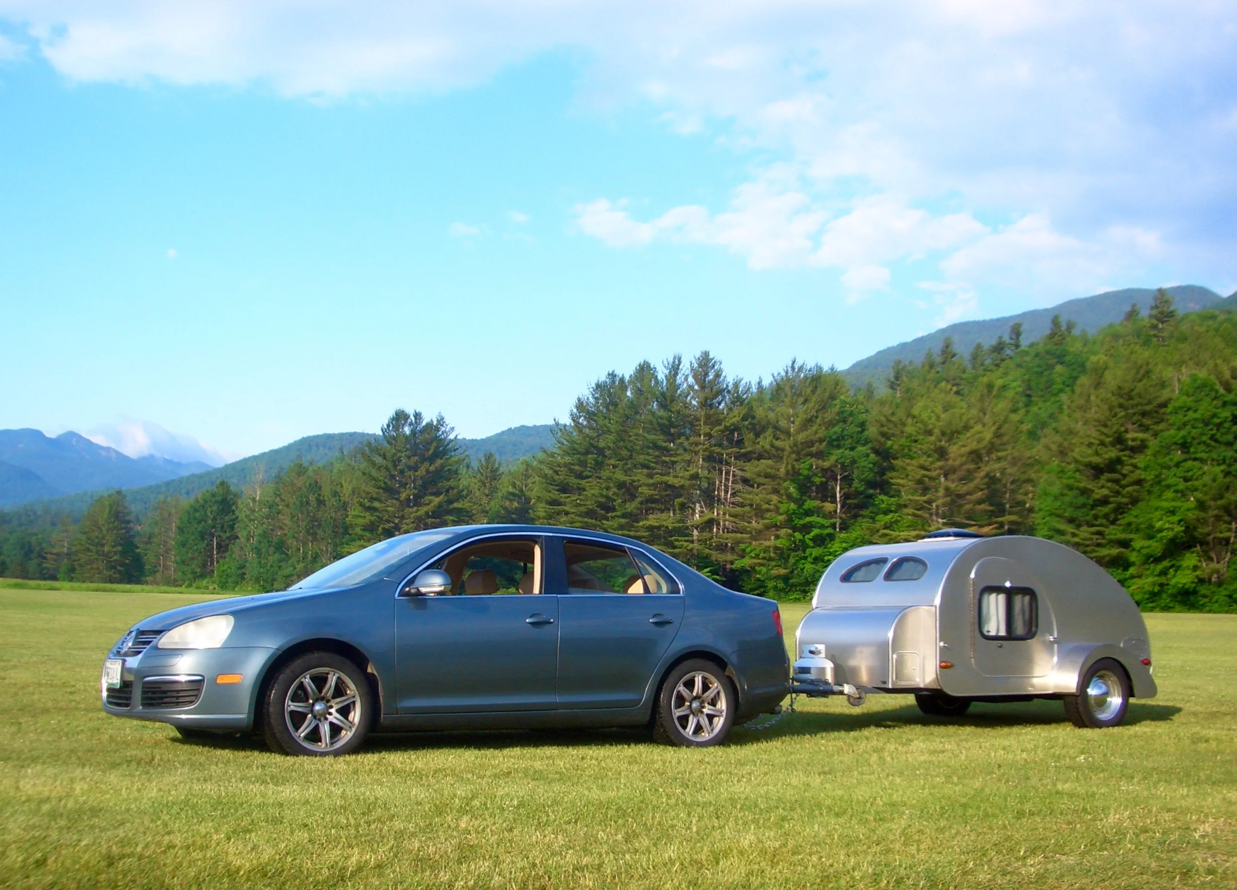

    My vehicle is a manual shift 2006 Volkswagen Jetta 2.5 PZEV 4dr Sedan. I bought it used at 160,000 miles, therefore, it was not under warranty - have had no towing problems whatsoever. Riding so low to the ground is not great for off-road use, however, this drawback is made up for by how the tiers do not spit up mud and grit at the cabin, plus one gets pretty good miles per gallon on CIMG3467.jpg unleaded fuel.

    Clearly you've got it pegged, Dave. My contribution was simply to clarify a fact which is that sedans can do the job well - this topic was not clear when first I started out.
