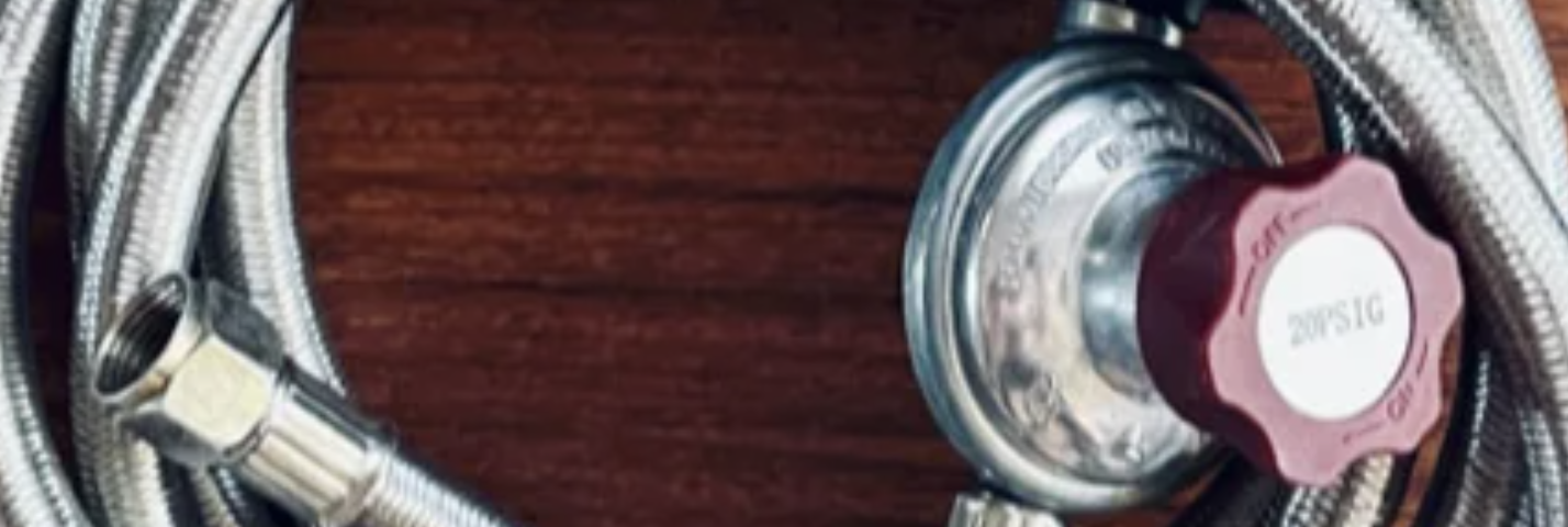

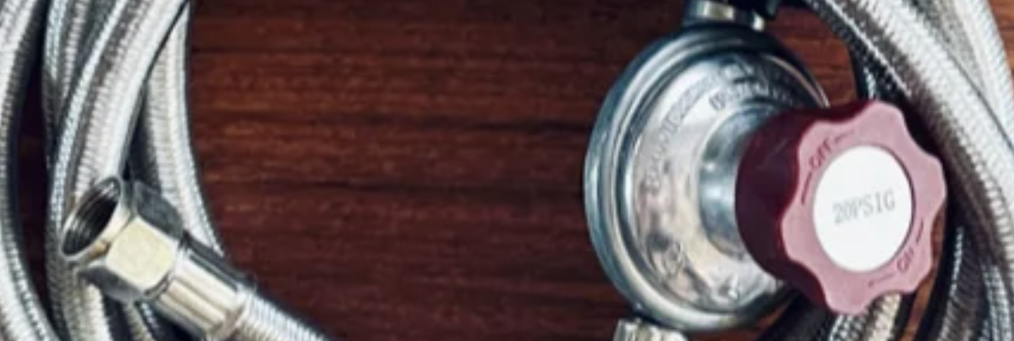

    I found a video or photo that showed the regulator, the sticker clearly shows 20PSIG.
    This suggests to me that a straight-through quick connect (20 PSI from the QD port) would be a problem due to the double-regulator effect. But, perhaps more than I want to take on at this point....

    It appears that their regulator adjusts the flame. As to “the double regulator principle” it seems to me that you treat these devices as a series. You would not want a 10 psi regulator on the tank side feeding an appliance that has a 20 psi regulator, you would only get 10 psi. Two regulators of the same output should give you the same output. A 20 psi regulator on the tank side with a 10 psi regulator on the appliance side would give 10 psi at the appliance.

    Thats what I am thinking a swell. But this was a concern in a previous lengthy conversation that 2 equivalents in the series were still lower and not able to achieve 100% pressure.
    Guess I know who to blame if I DO buy it and it doesn't work :D
