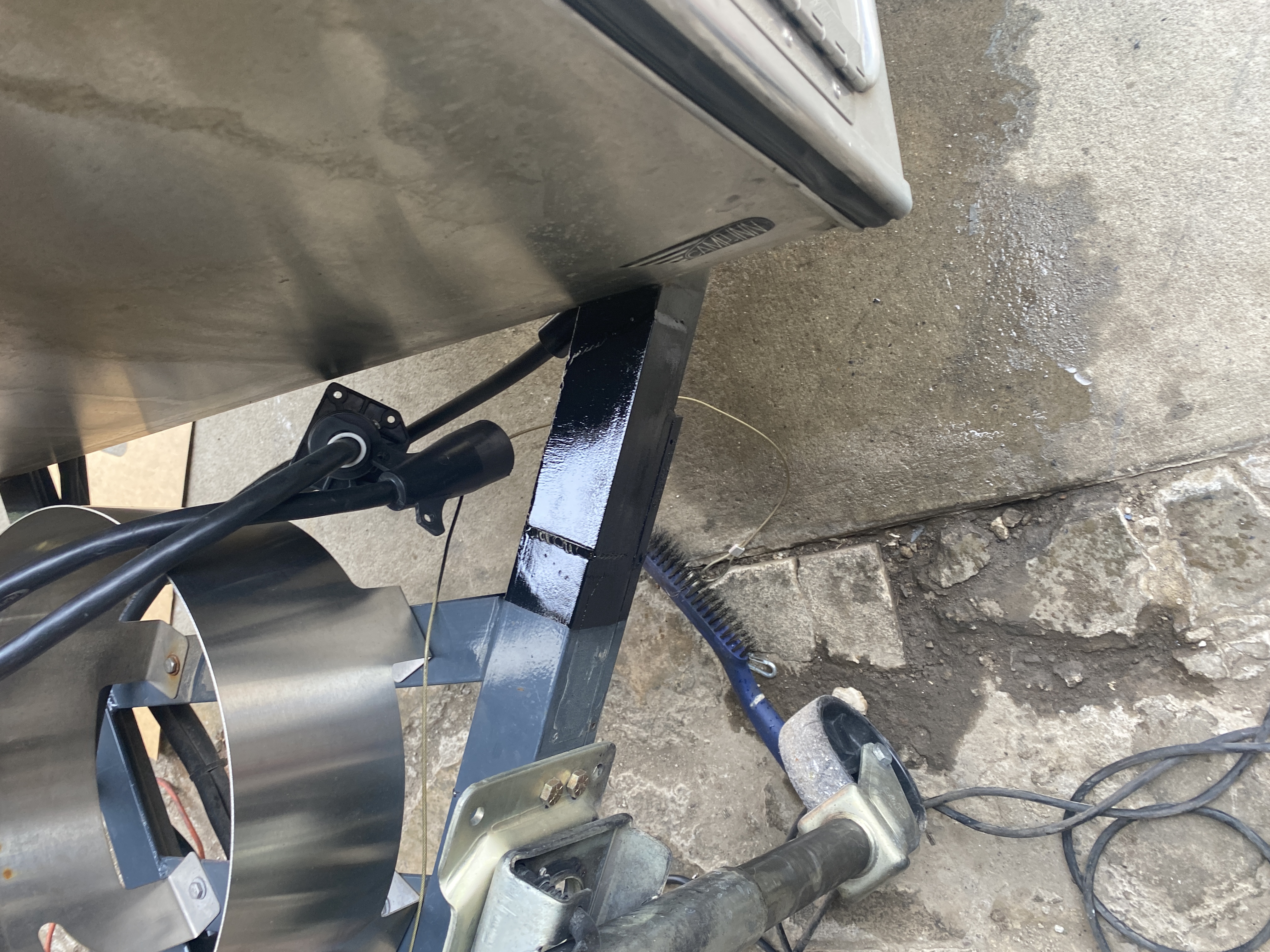

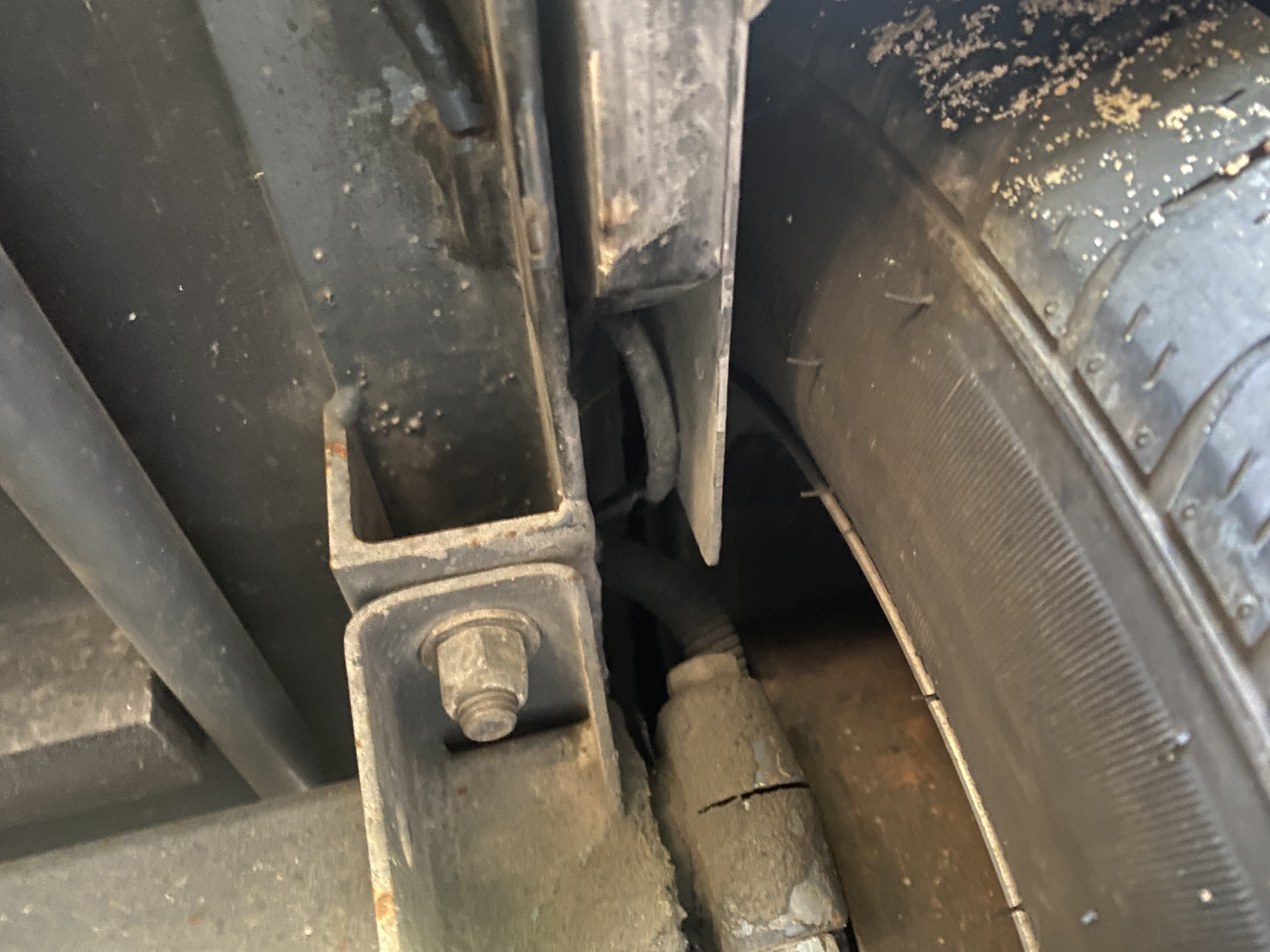

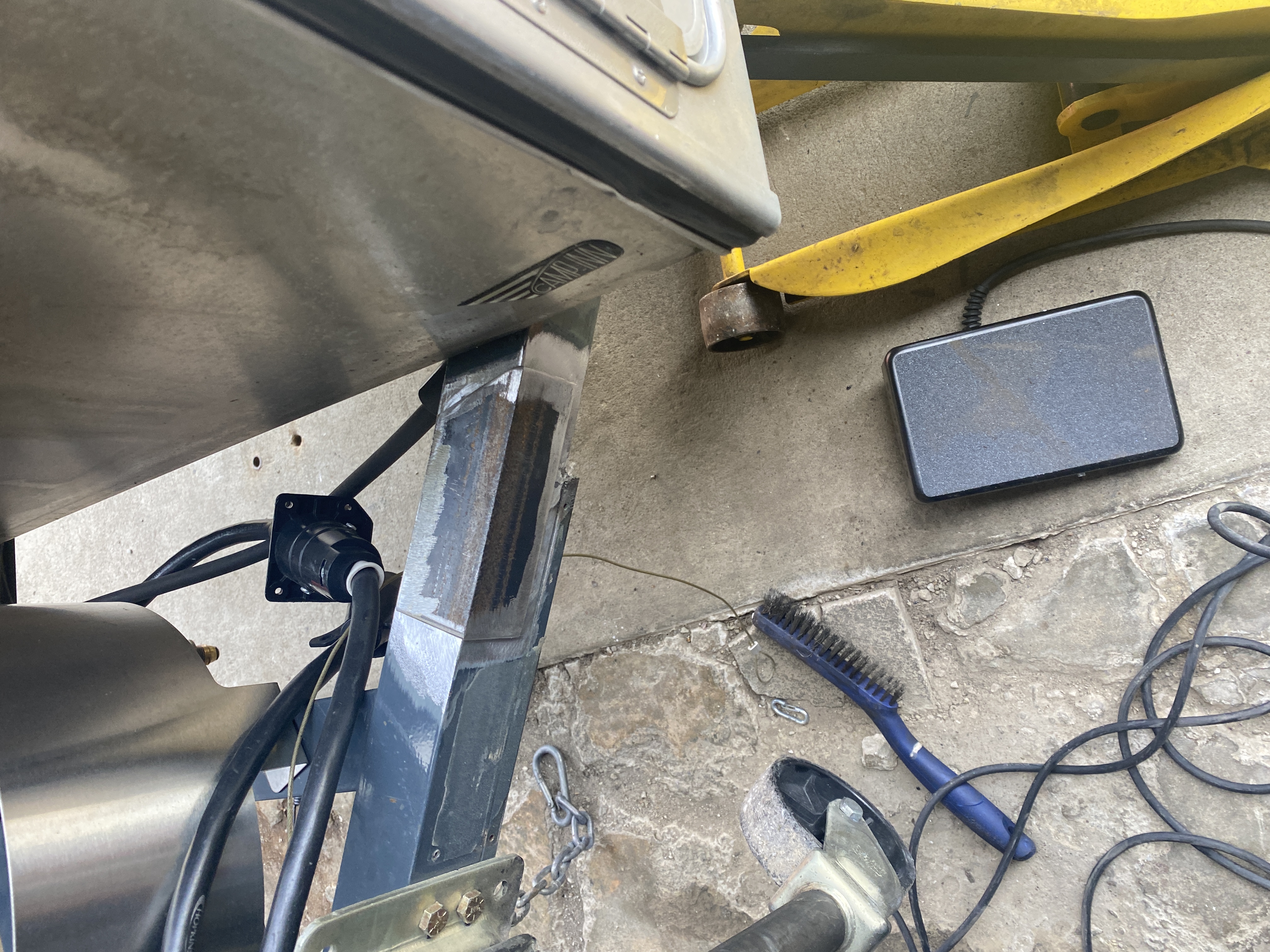

I have now had my frame welded 5 times. The first break was along the bolt holes that hold on the front wheel jack. I had a local shop (Idaho) weld the frame and he moved the wheel jack up onto a plate he welded on. He did a bad job and Cary re-welded it.
The second crack was along the holes holding on the Mfg info plate. I found a welder in the middle of nowhere who welded the frame and welded a bar across the break. My Mfg info plate now lives in the galley drawer.
The next two breaks were at the end of bars which were welded over the breaks. Each time the old bar was removed and replaced.
The last weld job was local and I left the tear and let him know I did not want it back until it was bullet proof. He removed everyone else's stopgap measures. He then welded heavy angle iron (just like the tear frame but heavier) from as far front as he could get to as far back as he could. It sits right over the existing frame.
I do almost all my camping off grid and do MANY miles of washboard (and worse) dirt roads. It is very punishing on the frame obviously. Back when I camped in campgrounds I had no problems so I attribute my frame issues to my camping choices.
I have had no issues in about 70 nights since beefing up the frame. I still check it every time I set up camp. I simply run my fingers under the frame and do a quick visual.
By finding my cracks early I have always been able to limp into somewhere that has a welder. The cracks have been clear up the side but never through the top. If you notice your tear slanting down in the front stop and check your frame!
