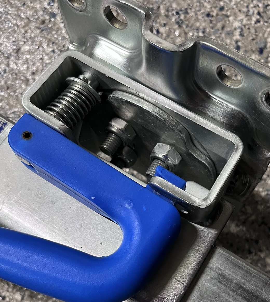

    For anyone thinking of trying this upgrade, I can confirm that the ARK 350 will fit without having to change the mounting hardware. Merely, remove the snap ring and swap them out. Easy peasy. It is a very nice upgrade as the ARK is MUCH more heavy-duty and it has dual wheels for reduced resistance.

    Here is a photo of it. I believe that the 350 fits the scale of the 560.

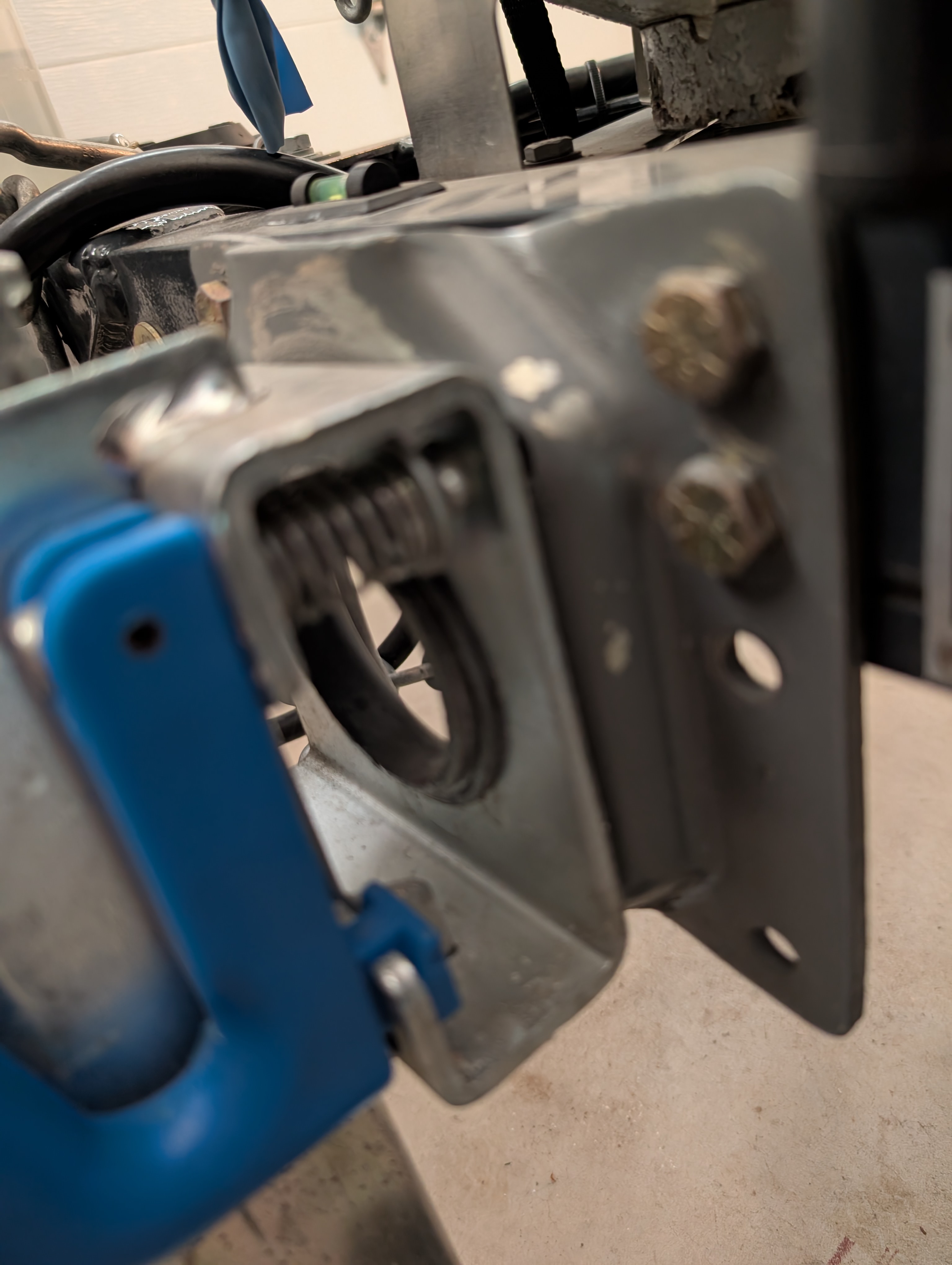

    For my TV, I found that using the upper sets of plate mounting holes gave me a better lift range.

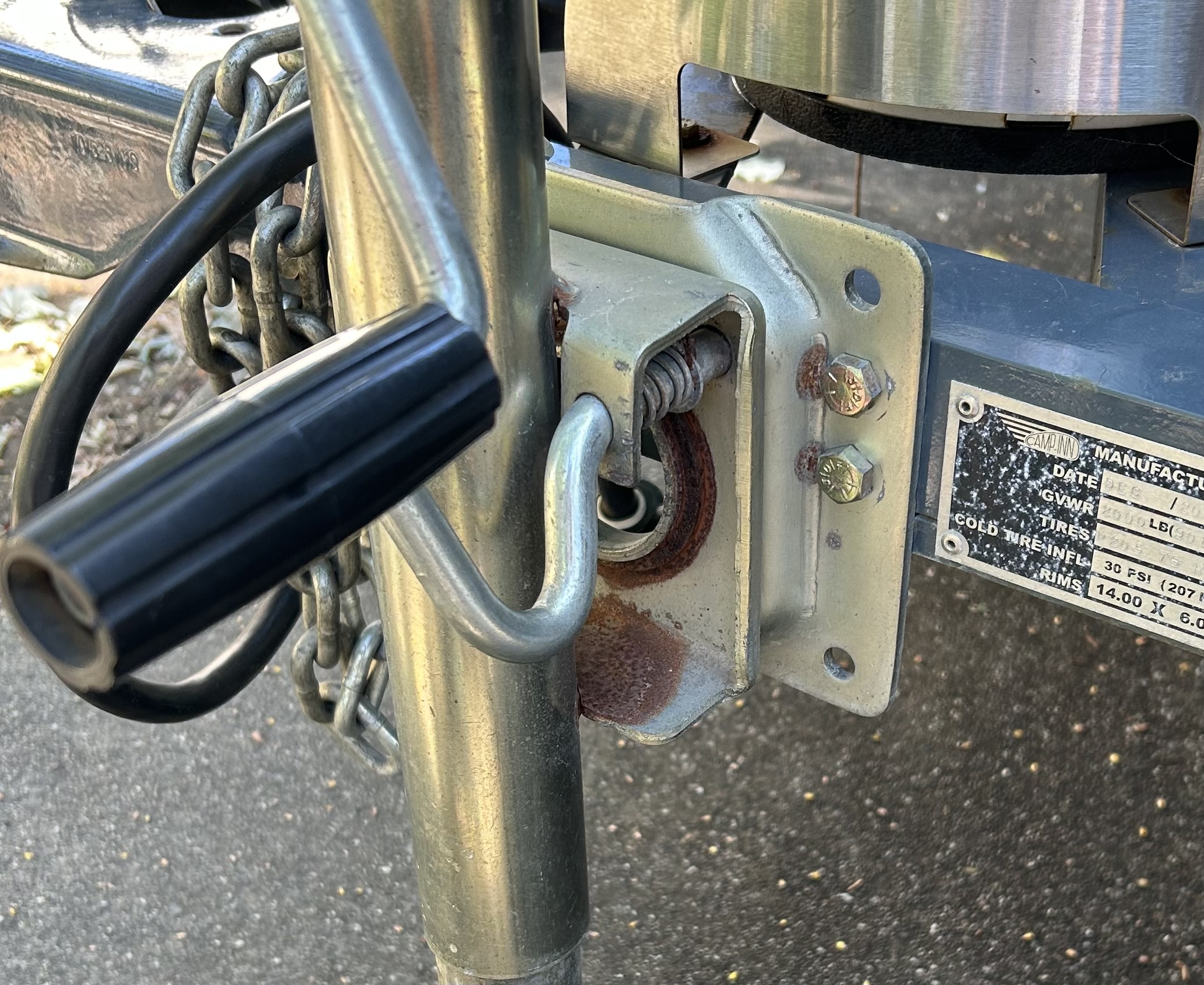

    I am a firm believer in the Fulton jack Randy posted about earlier. Ours now has The Fulton Double Wheel. My issue with the “stock jack” CI supplies with the 560 is it is too light. What changed my mind was the “snap ring” popped out and the tongue of the trailer crashed to the pavement narrowly missing my foot. Took my neighbor and I both to lift the tongue up to block it up…R
