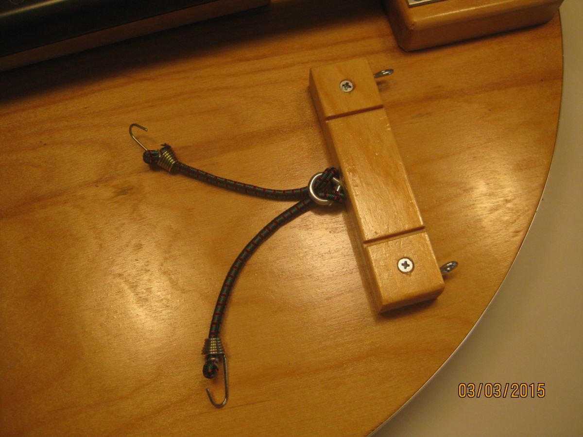

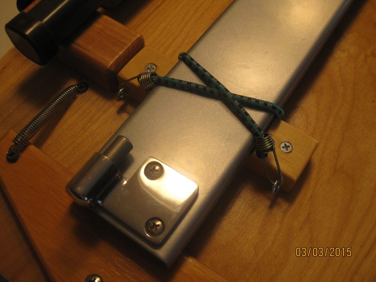

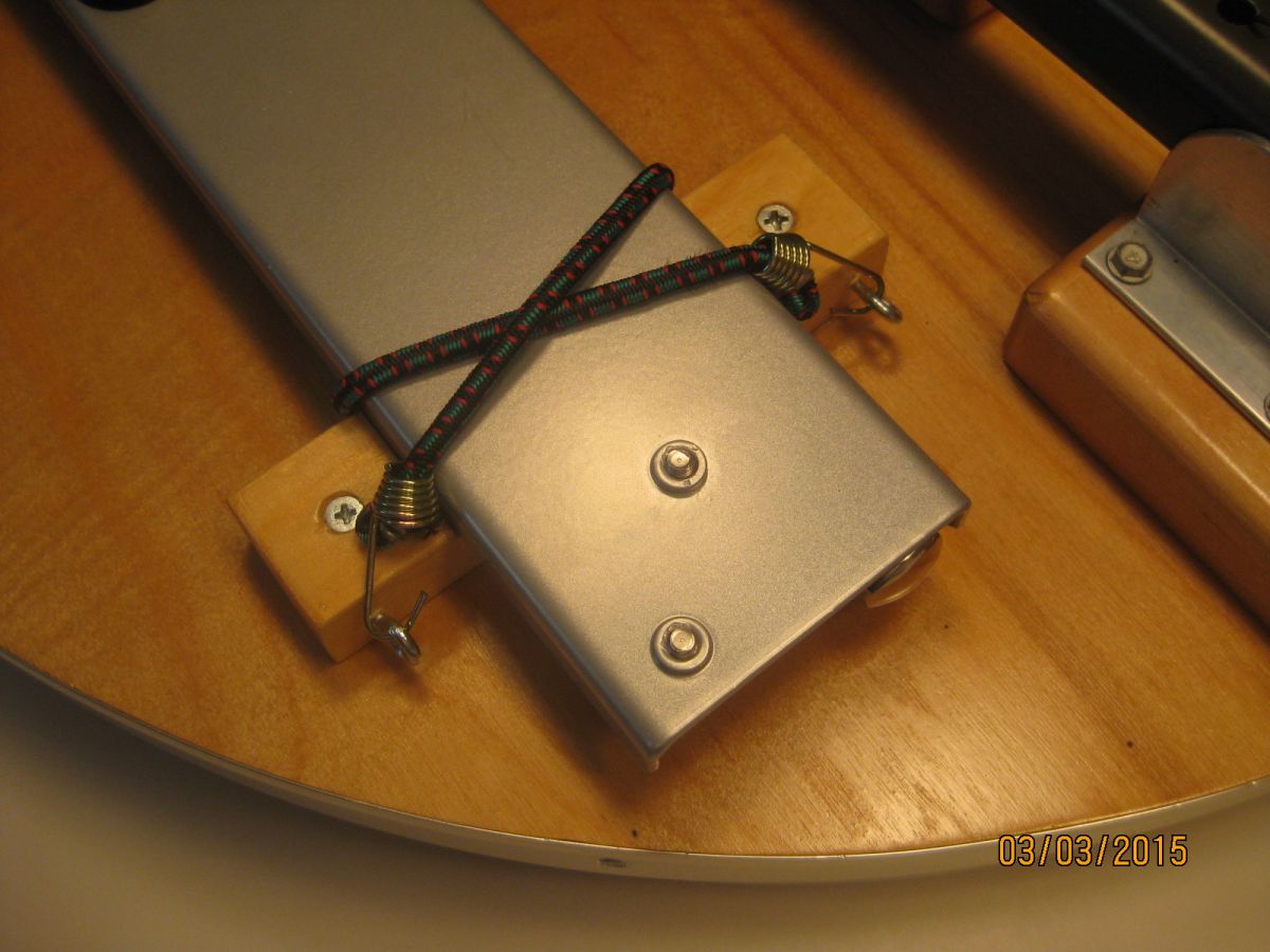

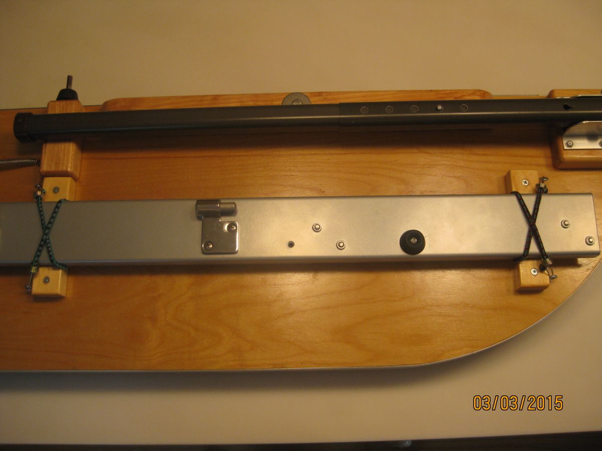

    Here are some pictures of a simple holder I made for the table extension for my 560 Raindrop. It holds it firmly in place and when removed, still provides clearance for the pivoting table leaf support. I used 2 wood blocks with shallow kerfs cut in, 4 screws, 6 screw eyes, and 2 small bungee cords. John Z. in PA

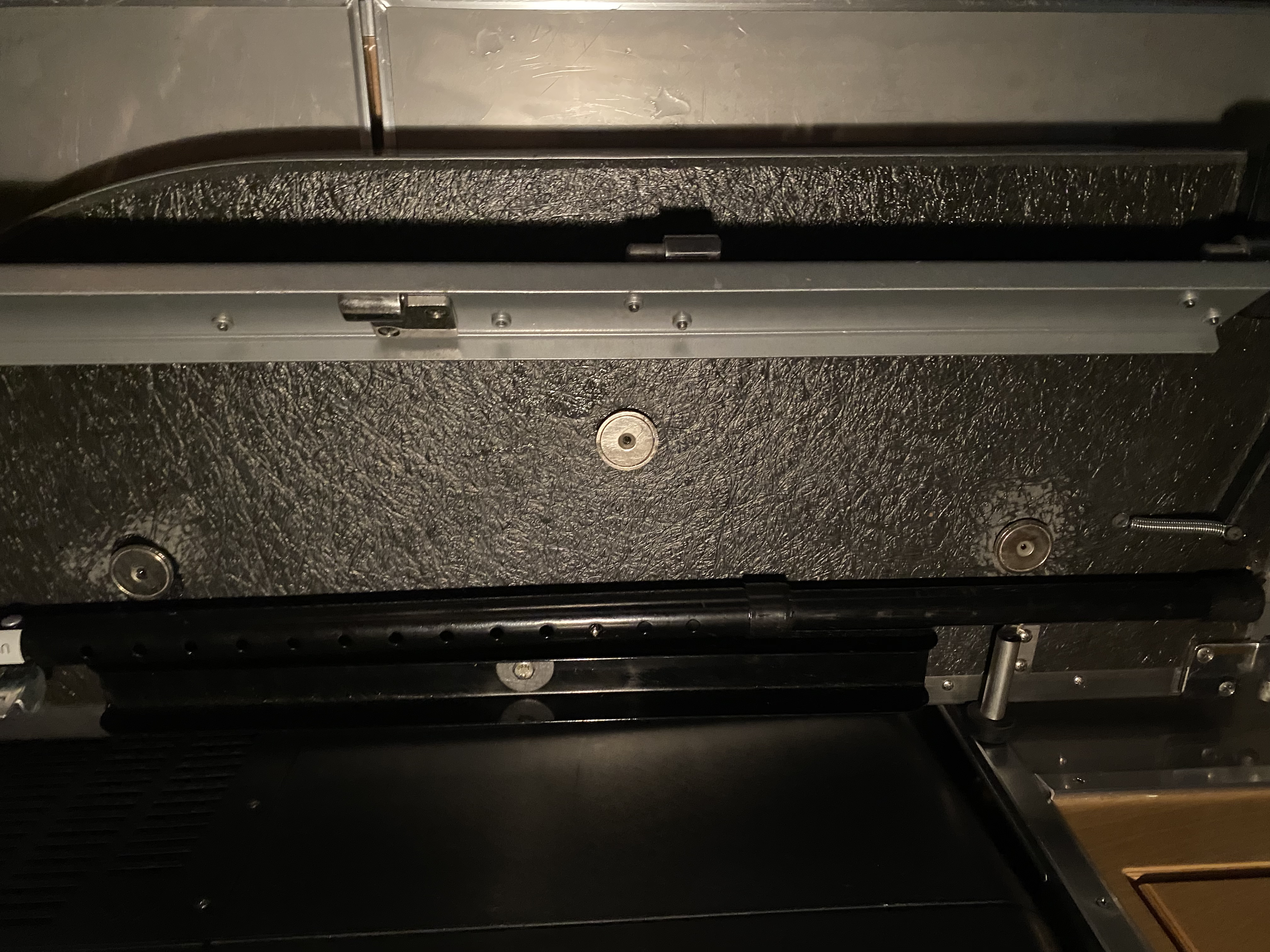

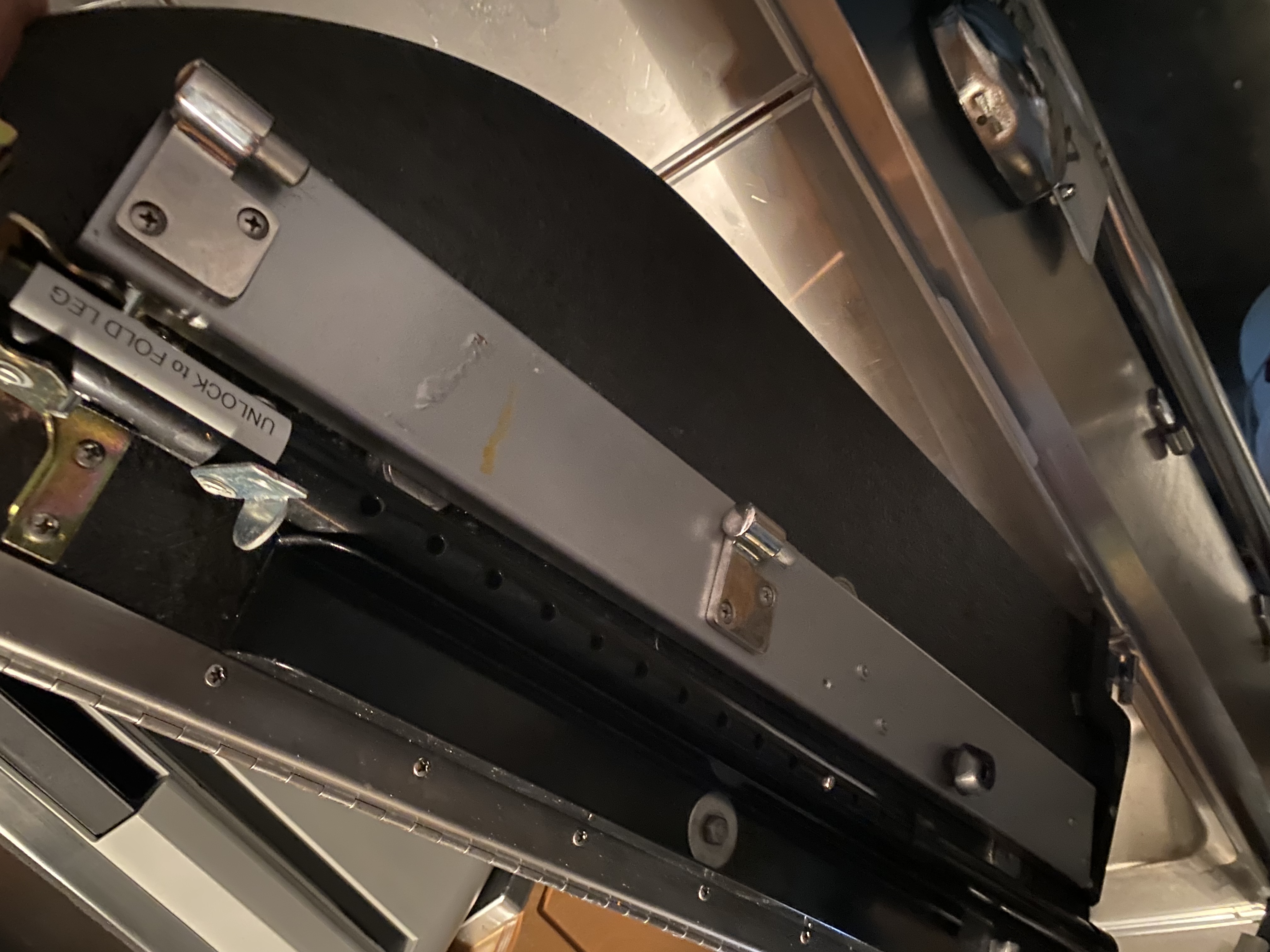

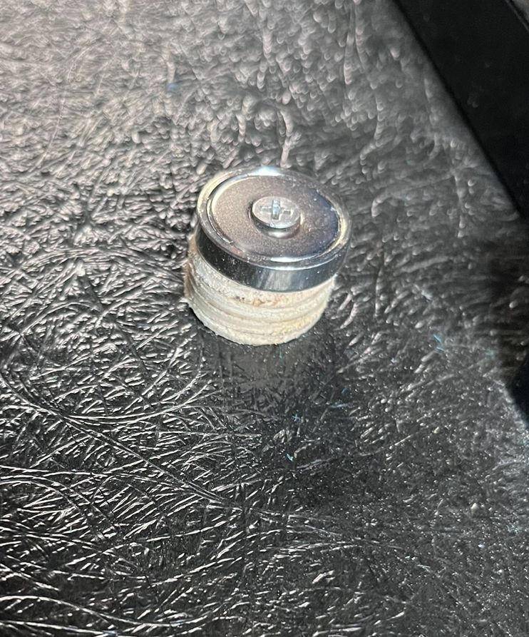

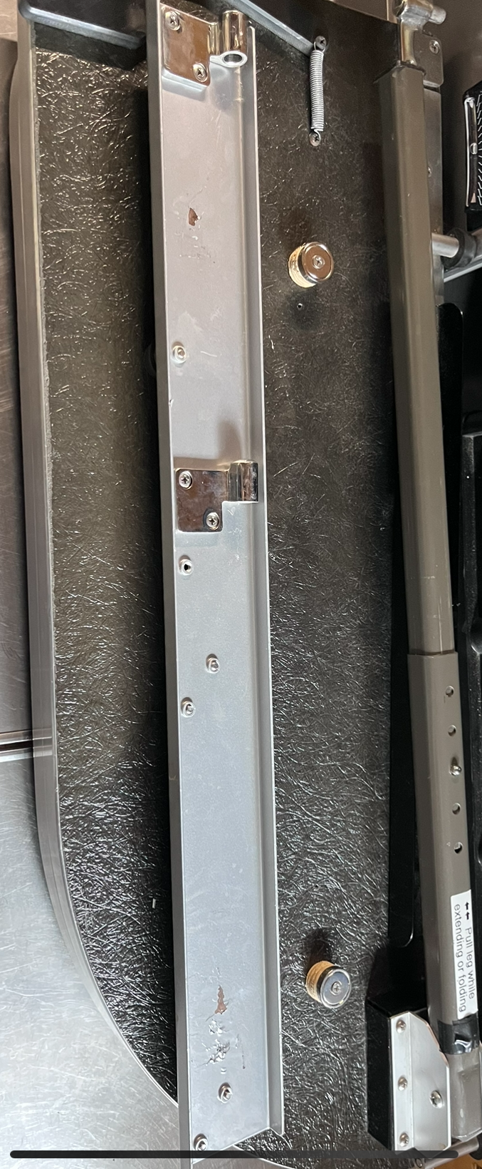

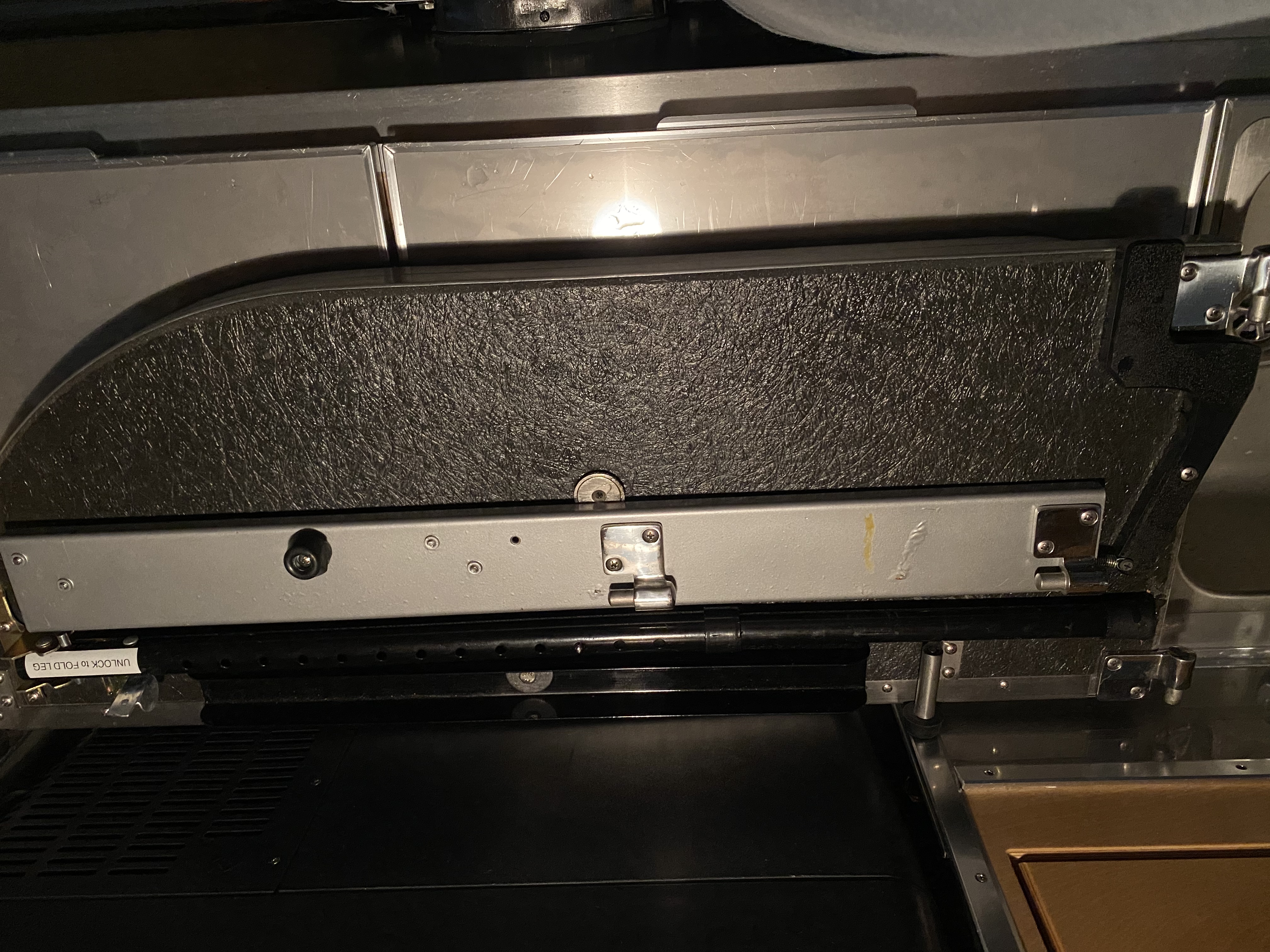

    I tried using Velcro straps to attach the table extension but it wasn’t a great option. I ended up using JB and 3 rare earth magnets attached to the underside of the table to secure the extension in transit. First, I located the spots I wanted to attach the magnets to the table. Second, I used 300 grit sandpaper to add texture to both the table bottom and the magnets. Third, I wiped away the debris. Finally a placed the magnets and let the JB weld cure overnight. The magnets are powerful enough that the extension holds in place under the table if I don’t decide to use it. NOTE: rare earth magnets are very strong so use extreme care and caution when working with them. I know these pictures are not great. Let me know if you would like additional photos.

    I did something similar to what Canoecrazy posted - I used two such magnets, screwed through them and a 1/2 or 5/8” spacer block of wood right into the composite on the underside of the table.
    The spacer blocks push the magnets up a half inch, allowing full contact with the inside of the “U” channel of the extension.

    More than enough. Here is the link to the ones i bought:
    MIKEDE 10 Pack Strong Neodymium Cup Magnets, 70Lbs+ Holding Force Heavy duty Round Base Cup Magnets with Countersunk Hole, Powerful Industrial Strength Rare Earth Magnets with Screws for Wall Mounting https://a.co/d/dRYArSL
    Something just clicked in my mind. I had seen paint damage on the extension before but it looked like it bubbled and not scratched so I hadn't connected it w the magnets. But I just checked and it does more or less line up with the magnets, or the screw if it sticks out a bit. So that is a disadvantage of this. I need to think about a solution. Some tape over the magnet should be enough but I need to verify that.

  17. Thanks. I have a bunch of those kicking (sticking) around. Was possibly even going to double them up for some extra holding power.
    Kevin likes this.
  18. Brilliant. Doubled up, they hold but don't touch. No marring.
