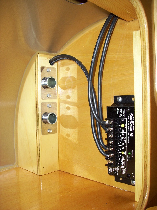

  5. Evan
    Sometimes I am so dumb I amaze myself... :)
    Look closely and you will see that my battery cables are not plugged into the terminals marked 'battery'.
    Oops.... I ran out and fixed that in a hurry - hope nothing bad happened. :confused:

  7. Nice work Evan...You are one brave soul for tackling a project like this. Glad to see everything has turned out well. Looks very nice and can't wait to see it in July. I'm in with everyone else and don't cover the wires inside, the curtain there makes it barely noticable. We will now sit back and await to read the continuing saga after your weekend outing. Have fun camping.

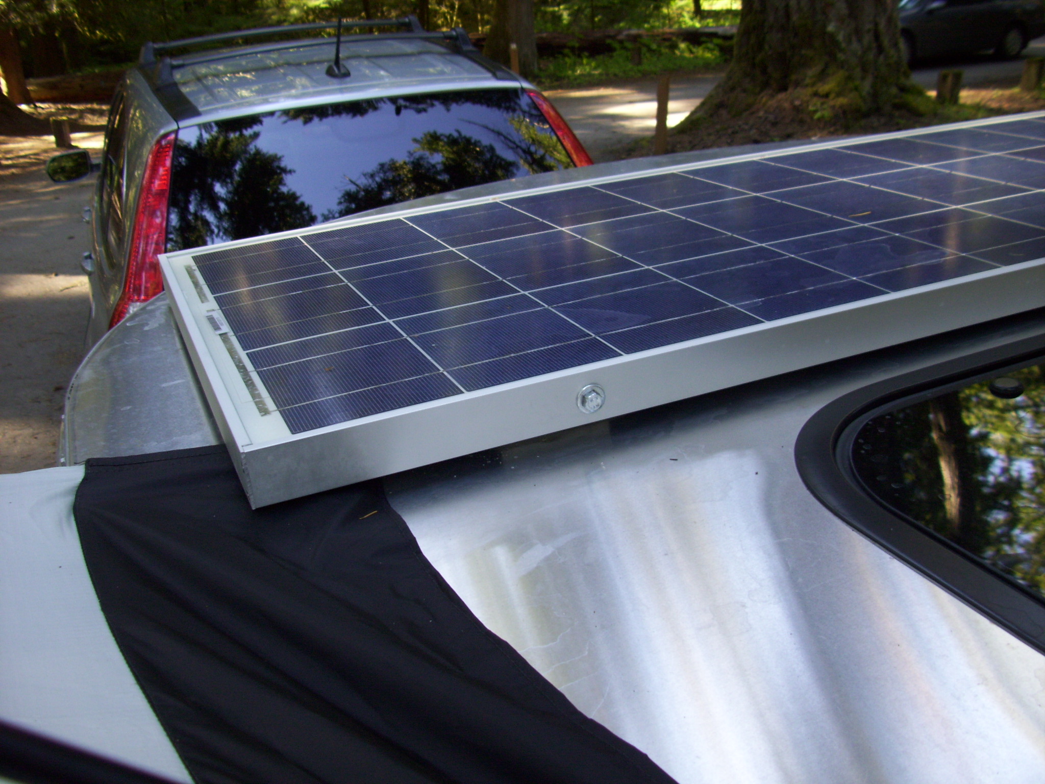

  8. Evan
    So, we're back - I'll post some pictures and stuff later. Regarding solar, I think it is working pretty well. We were camped in old growth forest and the sun never shone directly on the panel the whole weekend. We pumped all 8 gallons of water, ran lights off and on for 3 days, and even ran the stereo for about an hour. The volt meter never went below 12.2 - so that seems like a good scenario to me.

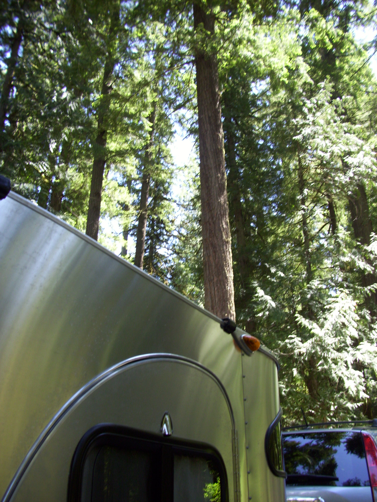

  14. Evan
    Here are a few pictures of the first outing with the new solar panel.
    I hadn't considered this before, but one of the straps for the side tent has to pass under the raised panel - very small clearance, and a bit difficult to do. I'm going to have to think of a better way to do this.
    Large old-growth trees kept the trailer and panel in shade all day. Even then, the power never went below 12.1
