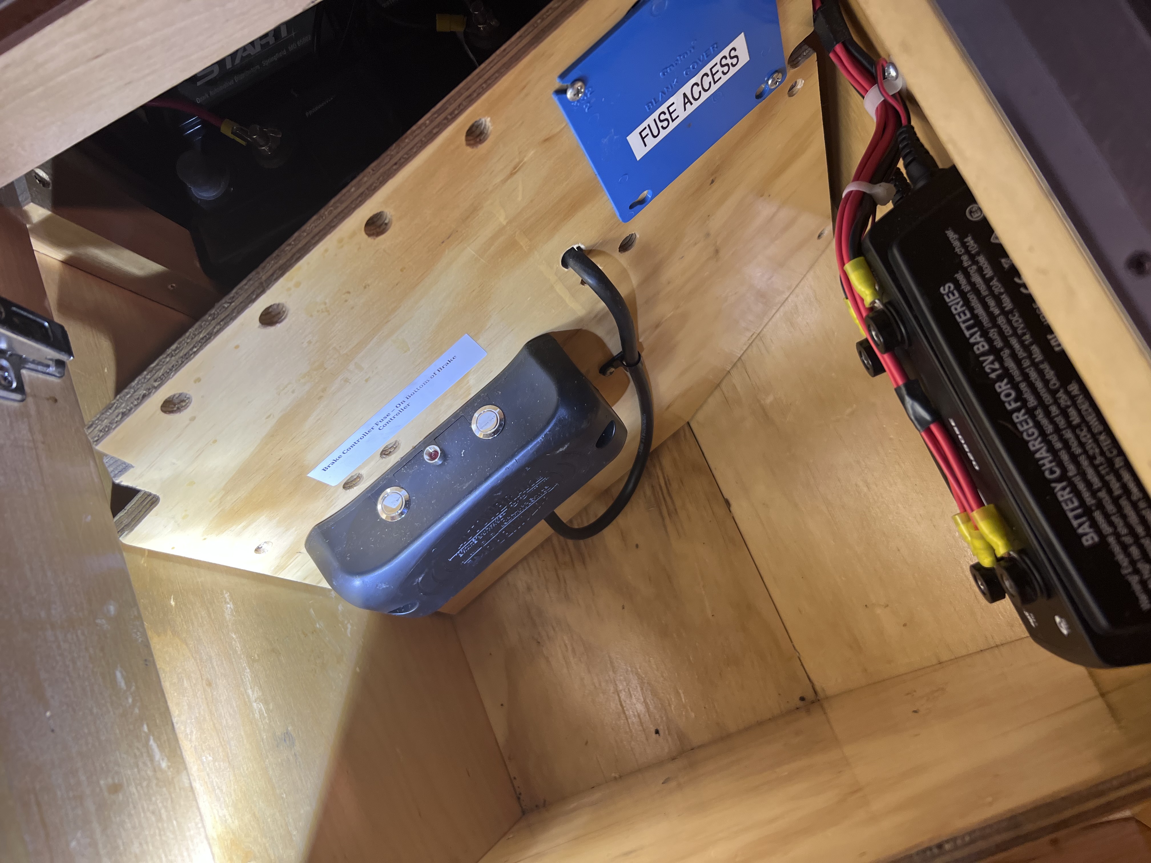

  8. Kevin S
    Kevin S Ranger
    Steve the Nest upgraded my used/new to me 560 with the AutoW and Ctek in the right hand galley bin.
    ( I later added the NOCO5 to same area when came time to replace the shore battery charger when it failed as it was just too hard to get at below especially with the added CI trailer hitch blocking access to the original location between water tanks spot).
    I just store soft stuff on that right side and heavy hard stuff in the left bin.
    Steve and Karen likes this.
  9. Kevin: I was just looking at the right side bin. The Renogy is 9 1/2" x 6 x 3, plus holes for the cables. That's pretty much the only place to mount it, with cables going to and from it entering the cabin at the foot of the mattress (hopefully out of sight) and being fed into the battery compartment at the same height.
    I just ordered yesterday a set of Magma nesting cookware to increase space in that bin (to replace my rag-tag collection of camping cookware) but that may not be enough. Further, I wouldn't want something like the Renogy taking a hit from something hard and heavy like my Dutch oven; I'll have to go with "soft" stuff as you suggest. I'm not hurting for gear space overall; just need to reimagine where everything goes now.
