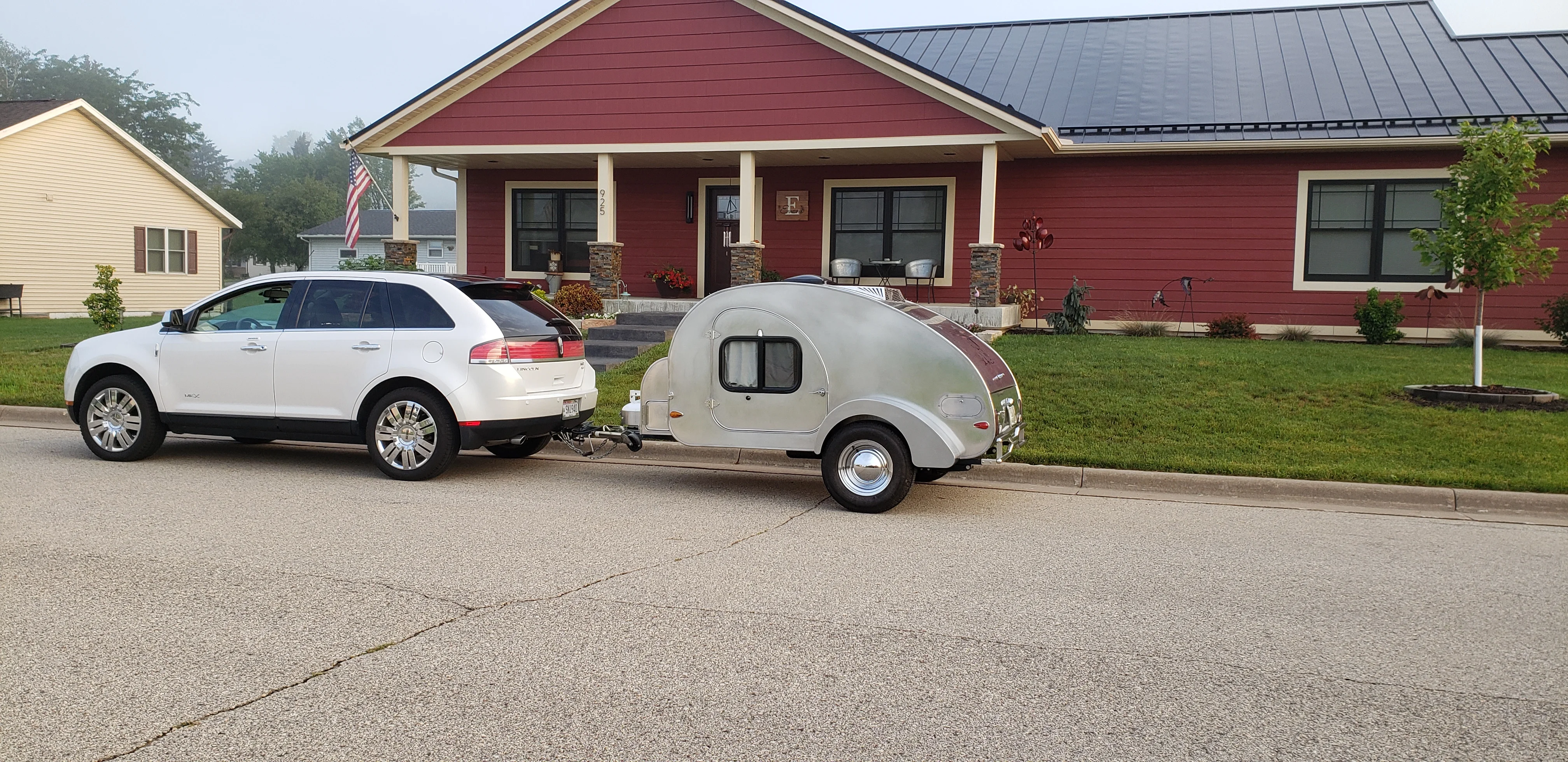

    Kevin Ranger
    Beautiful shine, Bill.

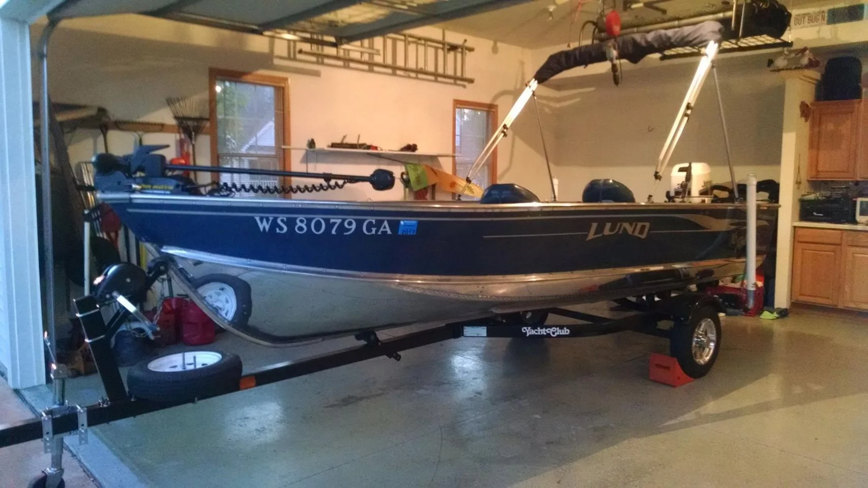

  18. campdude
    campdude Ranger
    Kevin, this was only a hand polish .
    I had a quote of $1,000 - $1,200 to "polish" my trailer to a mirror finish. I am going to purchase a variable speed polisher, the correct airway buffing wheels, rouge, and towels and try it my self over the winter. If I have it polished, I will need to have it done again so I might as well do it myself.
    Kevin likes this.

    campdude Ranger
    I am picking up a Makita polisher and supplies from Evan's polishing in Chilton WI. A few years back I borrowed a polisher and did my old boat bottom. It's a dirty job but rewarding to see it complete
