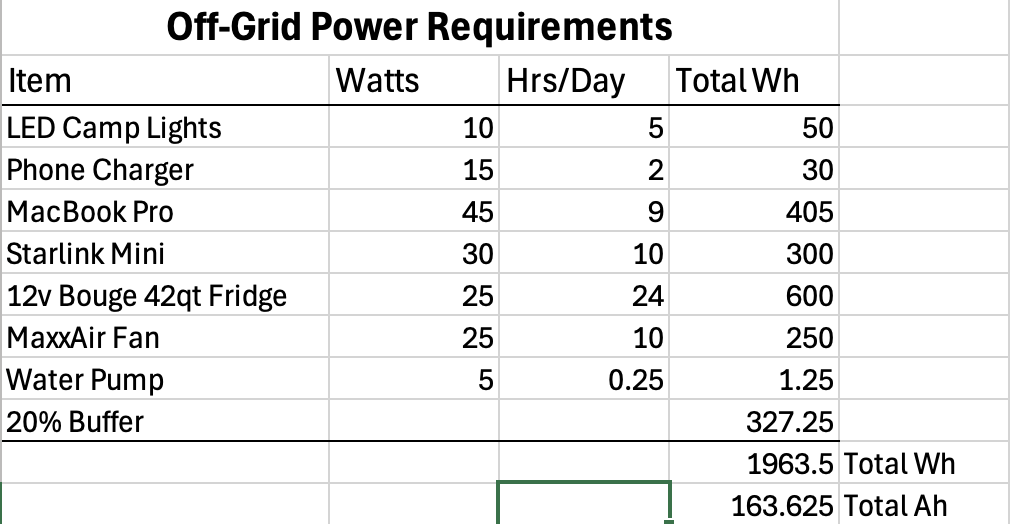

I reworked my power requirements table to exclude the air conditioning. Bluetti and EcoFlow both make power bank systems that can handle 2000 Wh, and I'll have an EU2200i charging it back up late afternoon or a decent pare of panels (700-800w+). I hate the sound of genny's as much as the next camper, and I'll be in camp working anyway with my dog present, so I don't mind babysitting panels so much.
I appreciate everyone chiming in, thank you. What you guys have posted confirms my online research. Aside from building a custom 48v DC system and installing it in my truck bed (I've thought about it!), the ROI for running the AC off-grid on a 12v system isn't there.
