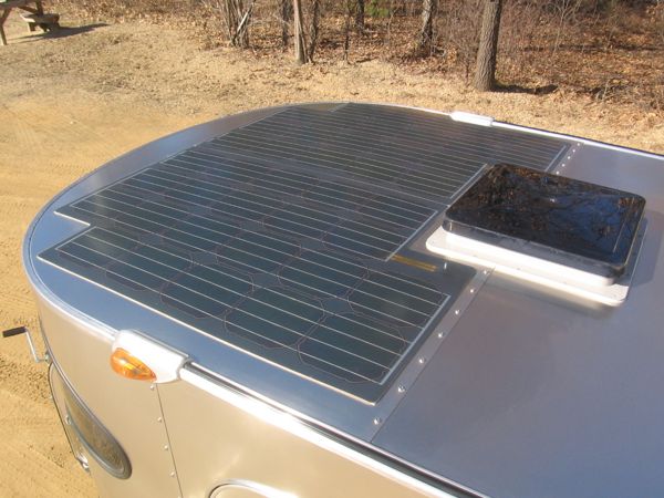

    This has been in the works for a long time and finally it is official! We now offer a roof top solar option for the 560 series of campers. We already have some customers who agreed to be early adopters of this and it is working great.

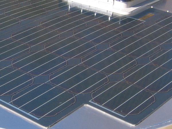

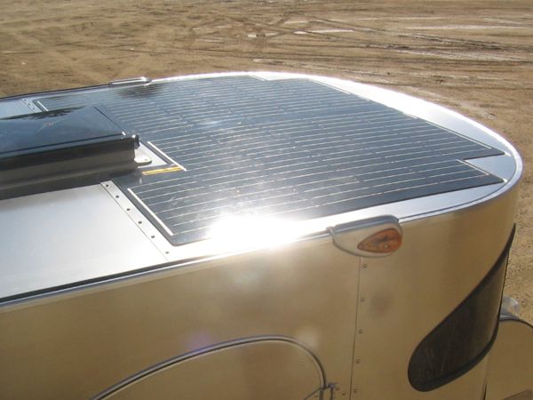

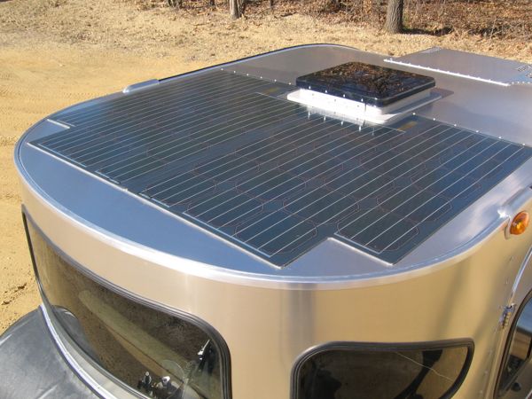

    Camp off-the-grid with a Custom-Designed Sunflare brand, roof top mounted, solar panel on your Raindrop 560. We designed this panel to optimize the space and maximize the power. With 126 watts of power, you can run your DC refrigerator, CPAP machine, and recharge your battery, even on overcast days. Mounting this thin flex-panel directly to the roof maintains the clean styling lines of the Raindrop body. This is the hassle-free way to do solar, no set-up or cables for you to run. This Solar option includes a CTEK solar controller (over $470 value) and an external connector for plugging in additional solar panels. *See the CTEK Option for more information.
    Check it out on our website. If you have a camper on order already and are interested in it please let us know, we would be able to add it to the order.
