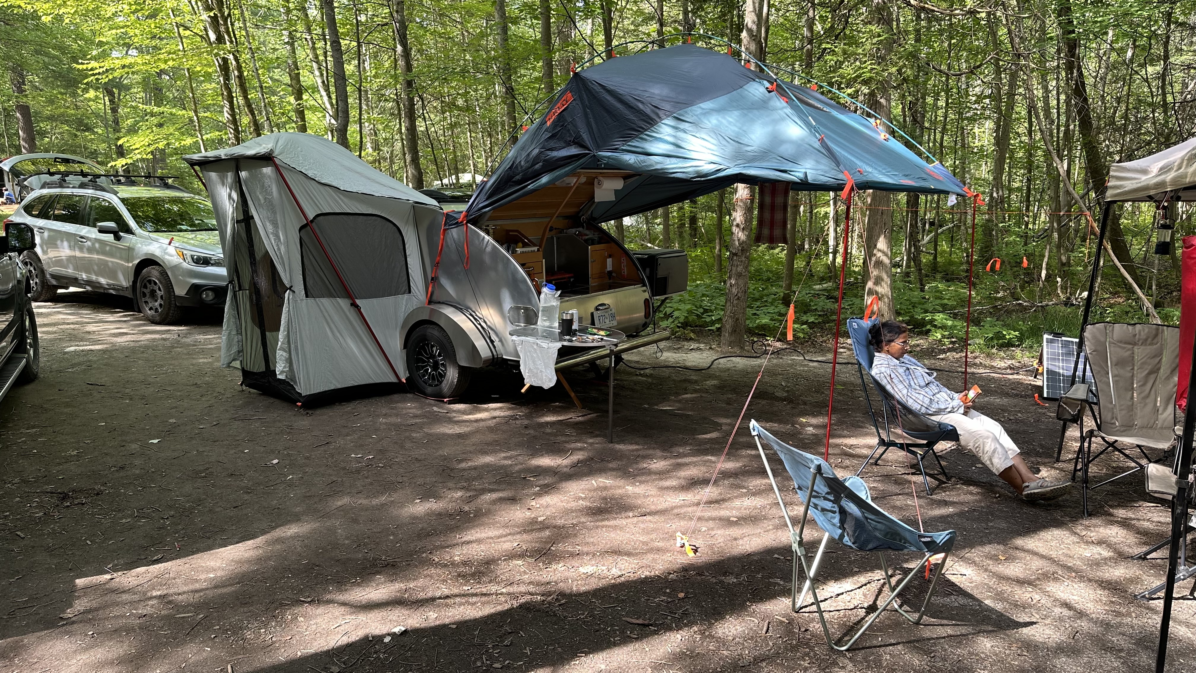

    We did a 4-day dry-camp last week and kept the Dometic going the entire time using the DC85 and my 34Ah portable lithium, with enough juice left in both batteries for at least another day of conservative dry-camping. We were in canopied forest with about an hour of unshaded sun each day, occasionally chasing the sun around with the panel to top up both the lithium and the trailer battery:
    The Victron shunt, I have found, has been less useful as an in-out "%age remaining" gauge than I had hoped. Which is mostly due to the difficulties it experiences in measuring, with multiple input sources, combined with a simultaneous draw. However, its ability to "describe" to me what each charger is doing in the moment (and when it is finished its job) is far more instructive and useful. Its open circuit reading allows me to compare and average with the Renogy's reading, and the Camp-Inn volt meter. I expect that I can get a good "ballpark" figure between the 3 volt meters and never risk going too far below 12.0V to cause any detriment to the battery.
    Also: Pretty happy with the Backroads shelter. Though it didn't need to keep any rain off us this time. I played around with various configurations (side-up, side-down, back on the ground, back on poles, cut off extraneous webbing, added tie-downs) and found it to be a pretty good Swiss-Army knife os a shelter.
