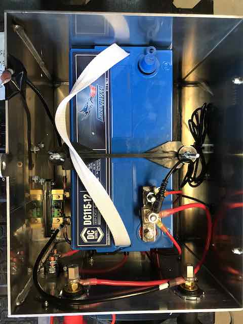

  15. Battery was installed yesterday. Good fit, with some modifications. The brass terminals need to come off (easy) cuz with them on, it's 1/8" too tall. With the terminals removed, there still are two female threads you can attach the leads to, making it a very low profile installation. Also had to modify C-I's wood "L" bracket that is on the inside of ply panel battery "door" by taking 1/2" off the top section; the case is 1/2" taller than the OEM.
    Seems to play well with the Marinco charger.
    Going to give it a test drive on the Blue Ridge this coming week at some non-electrical sites.
