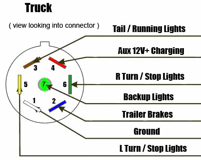

    EDIT: I identified the wrong pinout originally --- Updated to hide my shame :)
    If the battery tests OK, then the charge pin is your next logical only choice. If you start the car, you should see 13.8+ volts coming off the alternator....what battery isolated are you using? Mine is the ctek 205...it takes a few minutes to realize the voltage is high enough to charge before it starts...but you should see charge voltage (13.8+) on the battery shortly after the car starts...if you aren't seeing an charging voltage then the charge pin is the logical choice.
    You can check this with a volt meter; just look for 12 volt+ on the on the tow vehicle side of harness on the charging pin. (EDIT: See @SethB update below for details on which pin that is). If you have to charge voltage there, check for voltage at the battery isolator...in my case the CTEK 205....which isolator do you have in yours?
    SethB likes this.
  14. SethB
    SethB Ranger
    Great test procedure Sweeney, but I think that’s the wrong diagram in the attached image. The 6 pins are a dead giveaway! I think that on the TV side one finds +12v upper right on Pin 4, and ground lower left on Pin 1.

  15. Sweeney
    Sweeney Ranger
    WOOPS! What I get for 'working' while goofing off :) Thanks for the catch!
