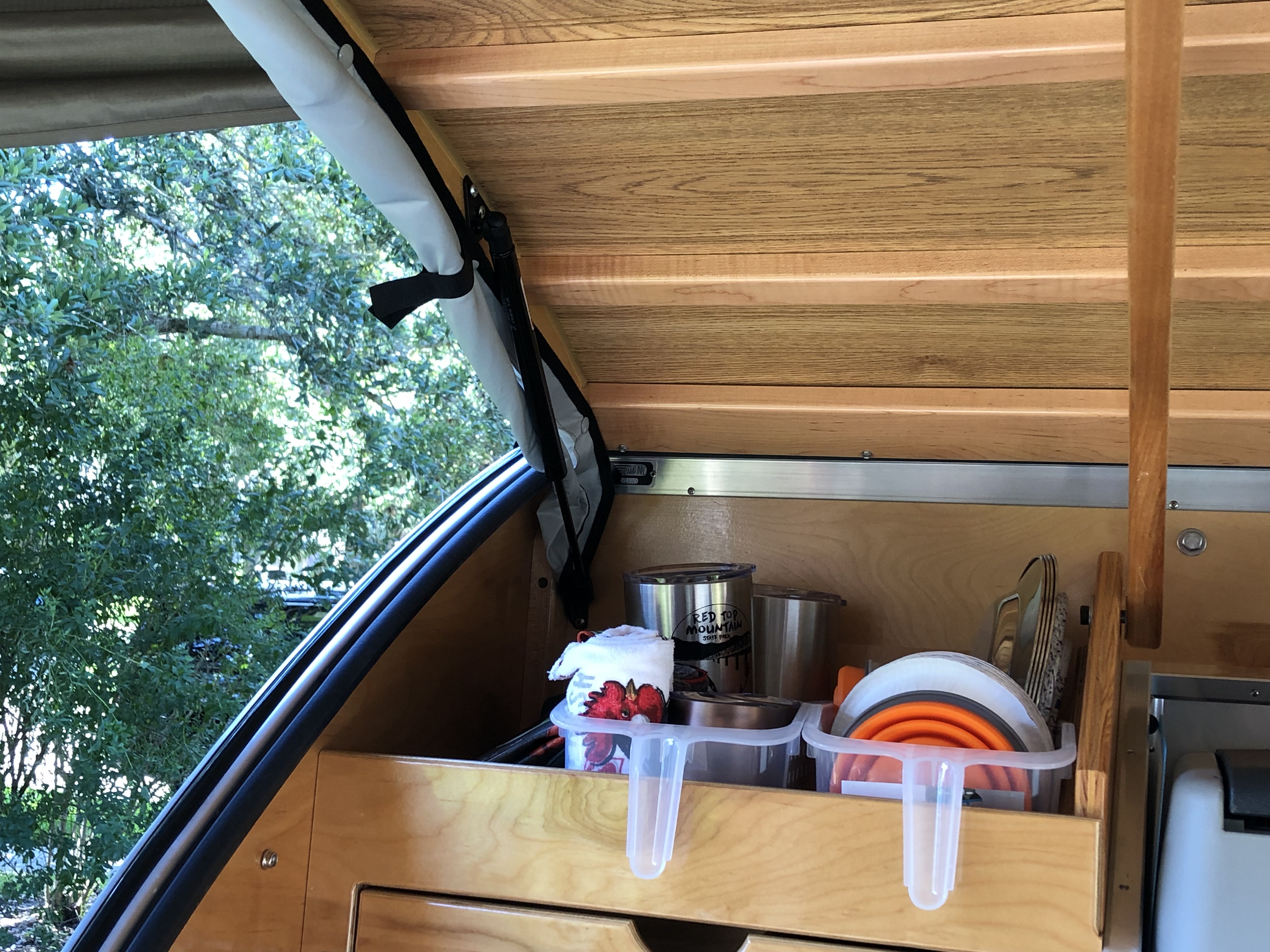

    Thank you. Yes Faux explained to me he screwed then in sideways but the pics look like they are screwed to the wall. He said he sold his unit so he could not go out and verify it for me and as you said the only pics he had were not the clear but I certainly appreciated his time with the instructions firsthand and replying to my questions. He was very helpful. I would say if your mounts were like mine they were multipurpose, could be screwed either way. If I had to do it over I would do it like you propose. HOWEVER, I do not know if your proposed 45# or 60# struts are the same length as the ones I ordered to replicate Fauxs install. So lookup the specs of the 80# he describes and compare it to the length of yours. If they are not the same, do not use the measurements in pics or what I quoted because it will not line up if that makes sense. If they are not the same length then my non professional approach would be to mount at his described rear point at the top and then see where the mounts line up on the hatch. Seems like that would work, hopefully without much trial and error right? I hope to follow up with pics when I’m all done with my galley setup.

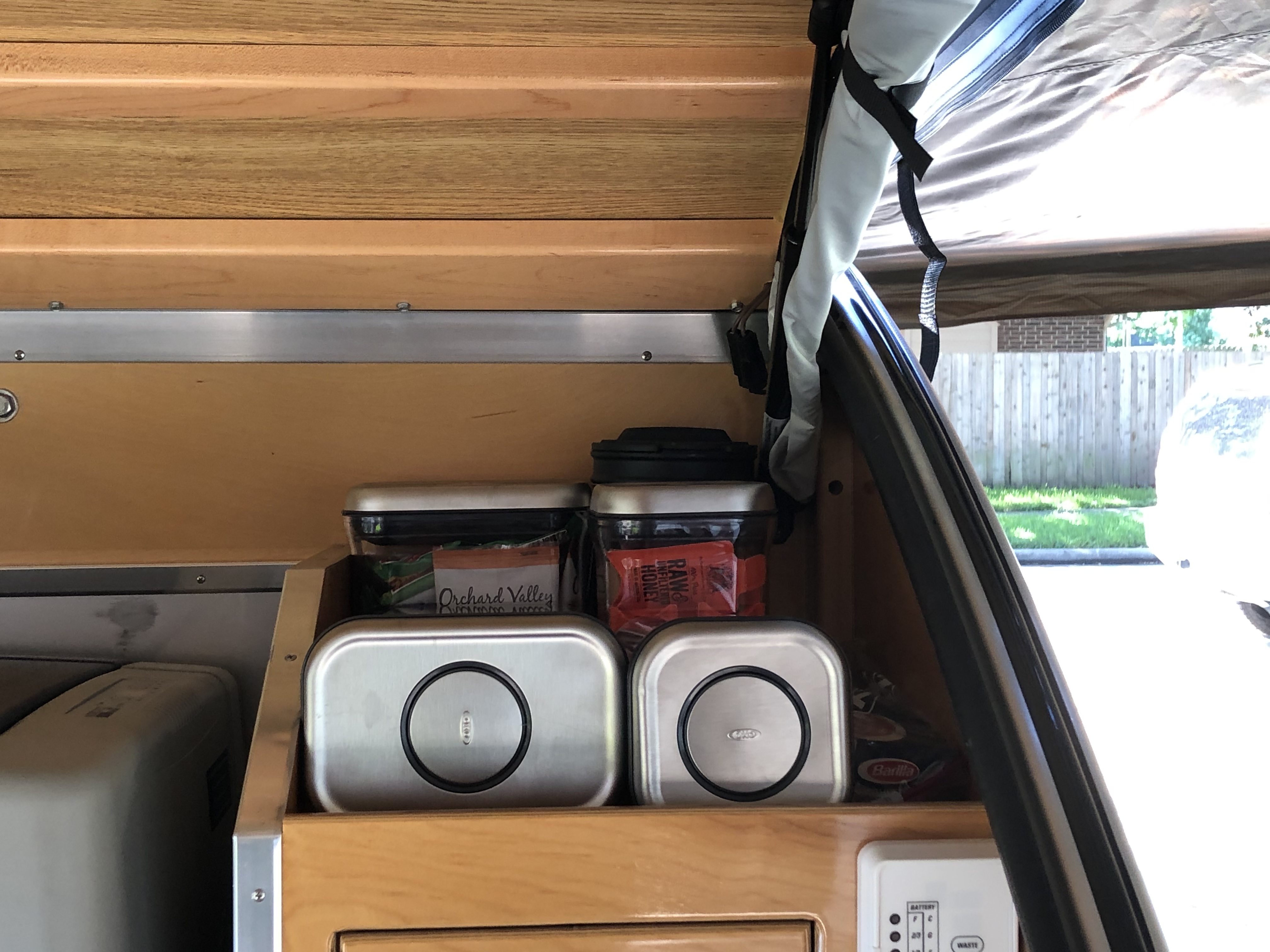

    Just wanted to add that you will lose about an inch and a half of shelf space on each side. Flexible items like silicone or flat items like a box of spagetti fits in this lost space though so not all is list.
