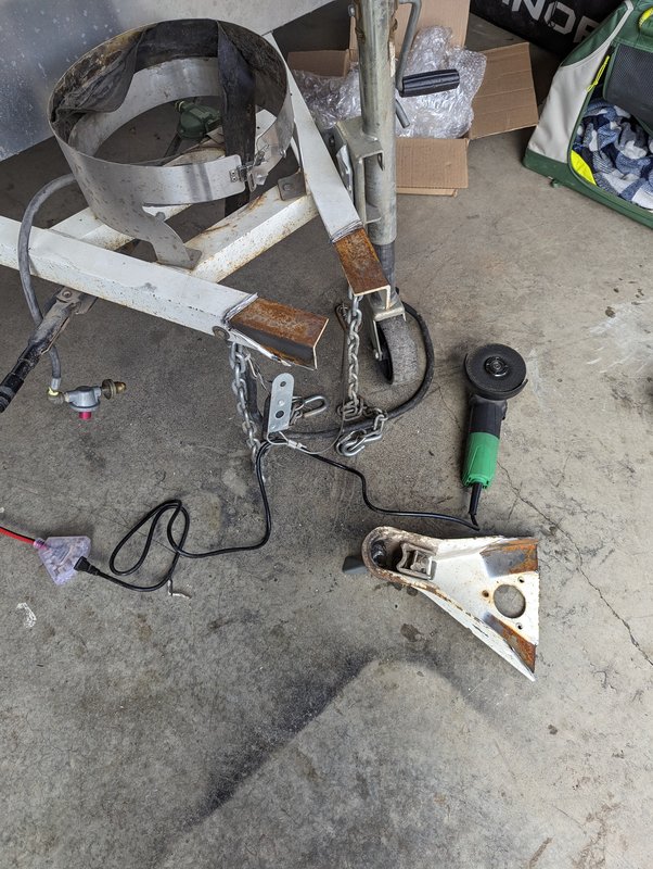

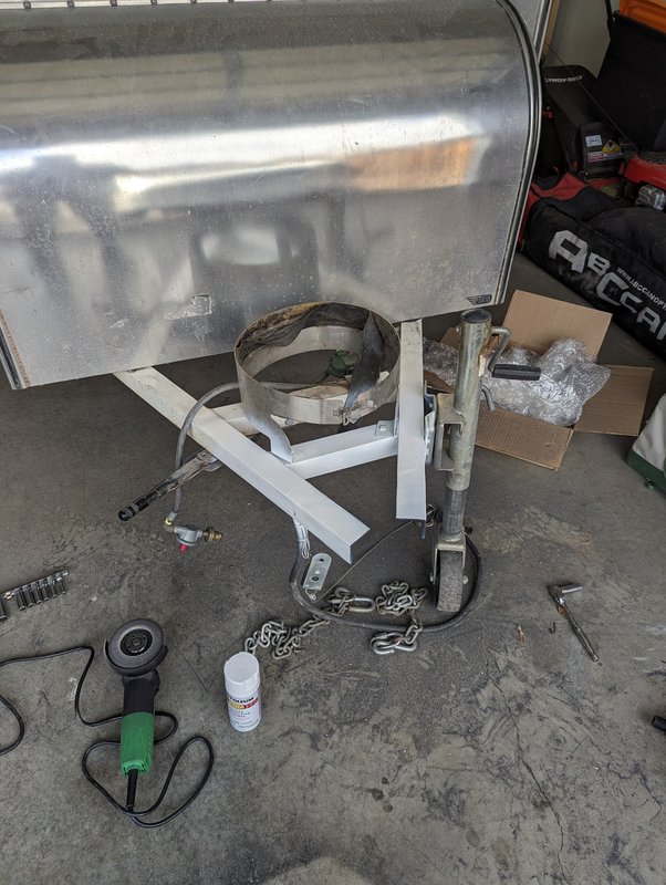

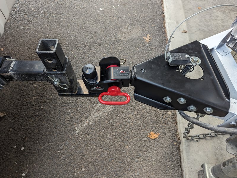

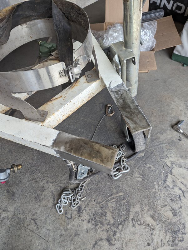

    Decided to just go ahead and put the Max Coupler today! Turned out awesome. Very happy with it. Bit of a pain grinding through the welds to get the stock ball mount off, but made it work.

    In process:
    Cutting through the old welds
    Grinding smooth and removing rust
    Cleaned up and some paint for rust protection
    Max Coupler mounted up
    Connected to the 4Runner with the new receiving end on my hitch (replaces the ball)

    Hitch worked great! Could not tell any difference and towed beautifully. Much more quiet actually as well since you do not have the metal on metal ball / coupler squeeking noises anymore.
