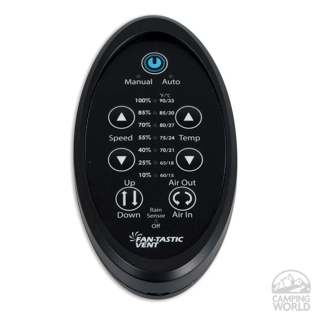

    The big advantage that everyone talks about is the availability of slower speeds/lower amp draw. Here is a pic of the remote:
  7. Van_and_Terri
    Van_and_Terri Ranger
    We had this fan in another Camper, and I must admit it was nice. Maybe a remote would be nice in a 560 if you were reading on the sofa. Not sure if you would need one in a 550.
