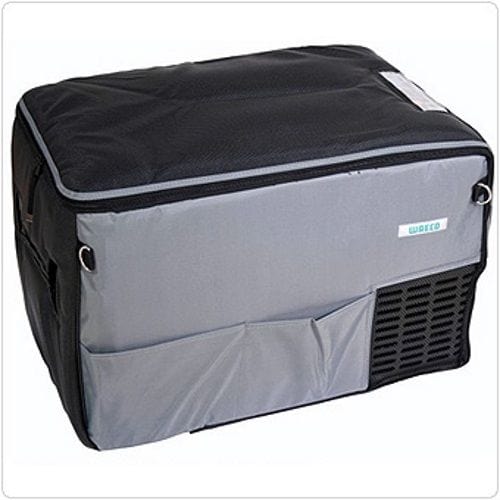

You mention a cover for the Dometic…. I am having trouble finding one that I am sure will fit the CFF35 model. Recommendations?
I just did a search- you'd want to confirm fit and inventorry, but here's the first one that popped up.
Appears to the the same as ours on our Dometic which was purchased prior to 2013 and still going strong. The protective cover is of good quality with thicker padding on top which helps with insulation.
