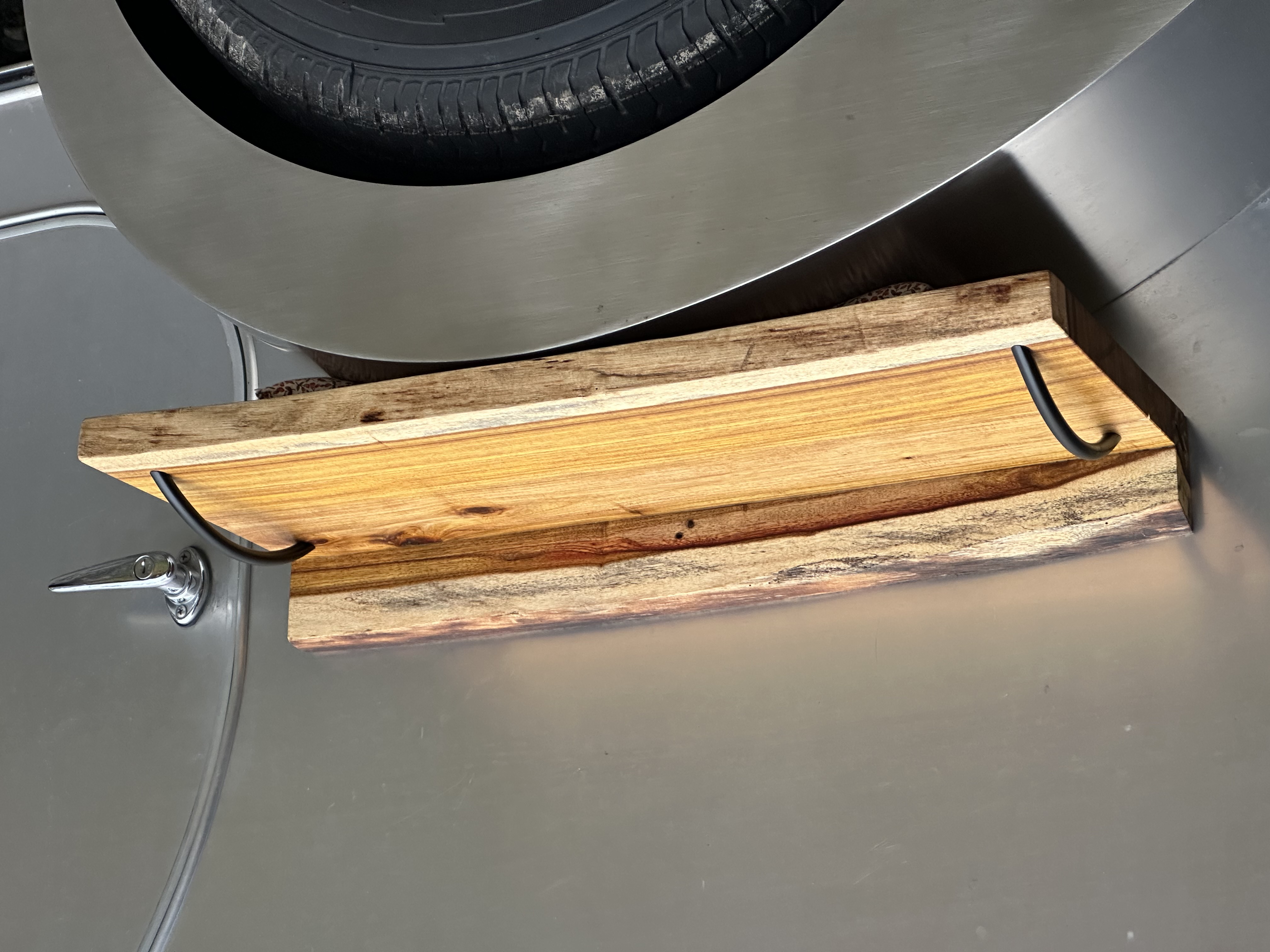

  1. Some other forum members have contributed their versions of fender shelves. Each had their own reason for the shelf and their own solution to the "curved fender" problem. I thought I'd throw my own out there.

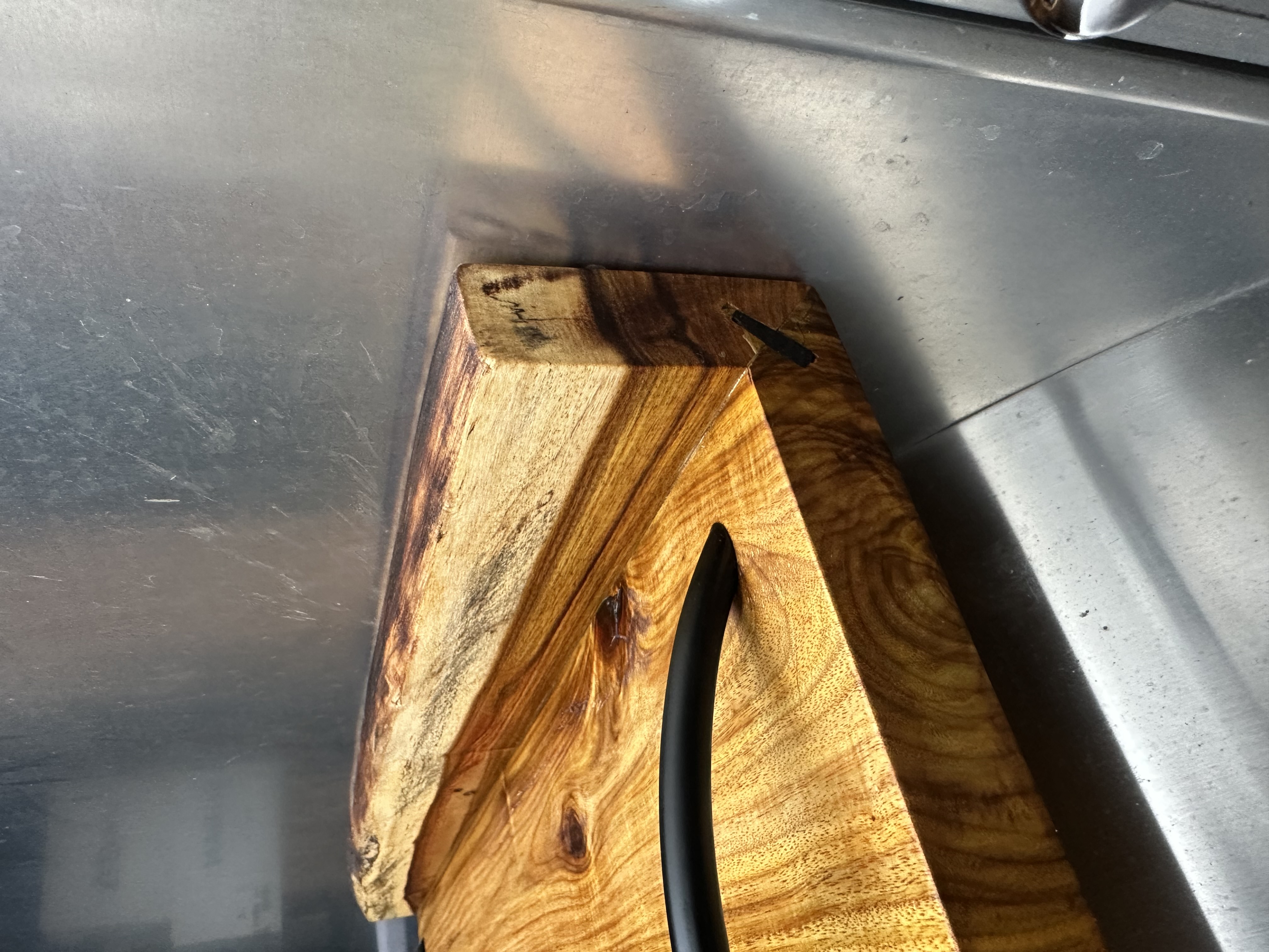

    This is a piece of double-live edge Yellow Tarara, or Canarywood. Instead of ripping it flush to the trailer side, I kept the other live edge for a "back-stop".
    Since I don't have a biscuit jointer, I splined the double 45 butt joint along a full-length table saw kerf cut for extra strength:

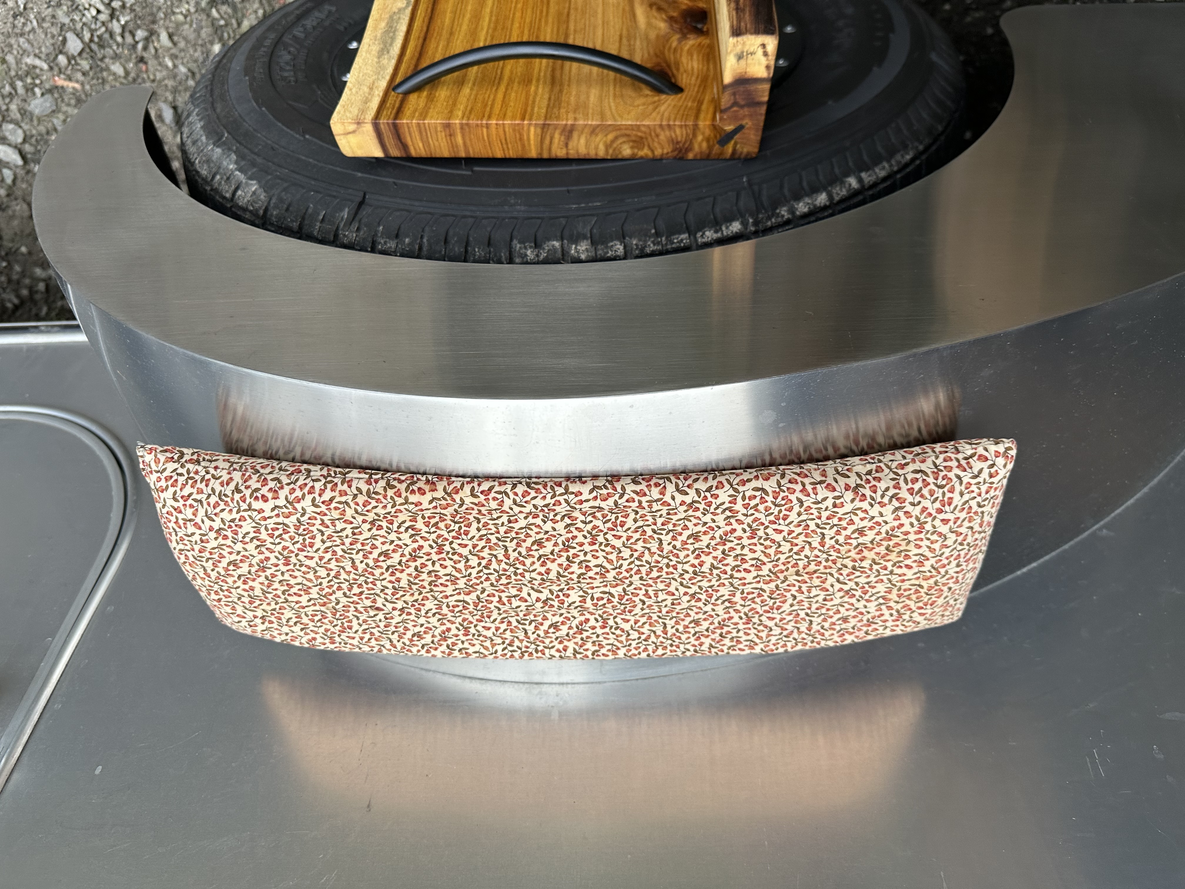

    I laboured over how to make some legs for it so that it would be useful off the trailer as well, and settled on a flaxseed hot-pack that you heat in the microwave, so... no strangely-shaped or angled legs:
    It's surprisingly stable; you don't need a large bag to pull this off. And you wouldn't necessarily need to use it for just a charcuterie board; a seed or bean bag would work for any type of fender shelf. Which is nice if you already have a charcuterie board and wish to entertain and serve at a tailgate party. Or simply need another level surface off the ground for shoes.
    The finish is food-safe Danish Oil and the handles are 6 inch drawer pulls.
    A word of caution: Live Edge can be surprisingly "live". In getting down to the final dimensions, some splits opened up that I had to close with glue and clamps. The handles also help keep it together. As with any wide board, there was a slight twist to it, which would have made fixed legs problematic because it would have rocked on a completely flat surface, or the fender. This is where the bags are nice. I'll be putting 3 small rubber feet on the bottom to create a self-levelling "tripod" for placing it on tables and kitchen counters.
