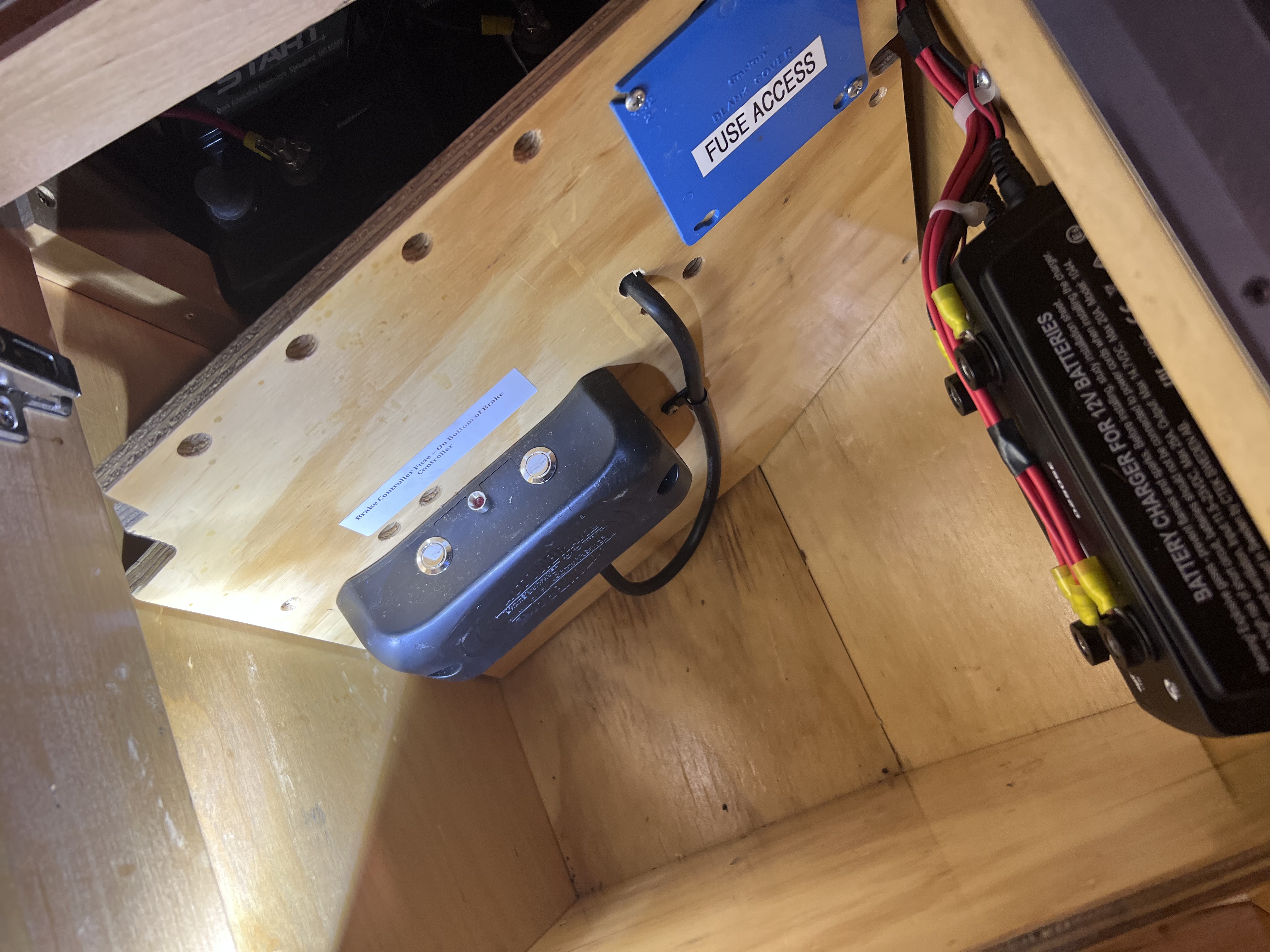

The brake controller does have a good drain on the battery. I just remove the fuse on the bottom of the brake controller when in storage. My parasite drain is down to 1 % with the brake controller disabled.I installed my autowbrake controller on the back of the storage compartment. I feel the is a better option for me as removing the battery controller is annoying enough without another big clunky thing with wires attached to it.
First I removed the right hand brake light, it is held in place by a rubber ring and easy to remove. I verified that the area behind the compartment back panel had clearance and drilled a 1/2" hole for the cable. I then threaded the cable through the hole and mounted the controller to the panel. The screws that came with the controller are too short to get a good purchase in wood so I found some longer ones. Connecting the wiring up is made much easier by having the tail light out, the brake/turn signal wires are easily found back there.
I also removed the battery and hooked up the controller power wires in there. The ground wire is hooked to one of the ground studs. The power wire should go to the power feed from the 7-pin; I connected it to the input+ terminal on my DC-to-DC converter. I am not sure if connecting the power to the trailer battery will be OK as it will be powered up all the time. It might impose a small drain on the battery all the time, and it will use power from the battery to activate the brakes.
I tested the functions and did the calibration steps in my driveway, I haven't taken it on a test drive yet.
