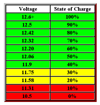

You should get a digital voltmeter that plugs into the cigarette lighter receptacle in the galley and ensure that you don't run the battery down below 50% or about 12 volts. Doing so is hard on the battery
Amazon.com: INNOVA 3721 Battery and Charging System Monitor: Automotive
full
Randy, thanks for the info. I have a voltmeter. Came with my trailer. I'll keep the attached
chart handy though. I'm sure there will be some trail and error over time.
