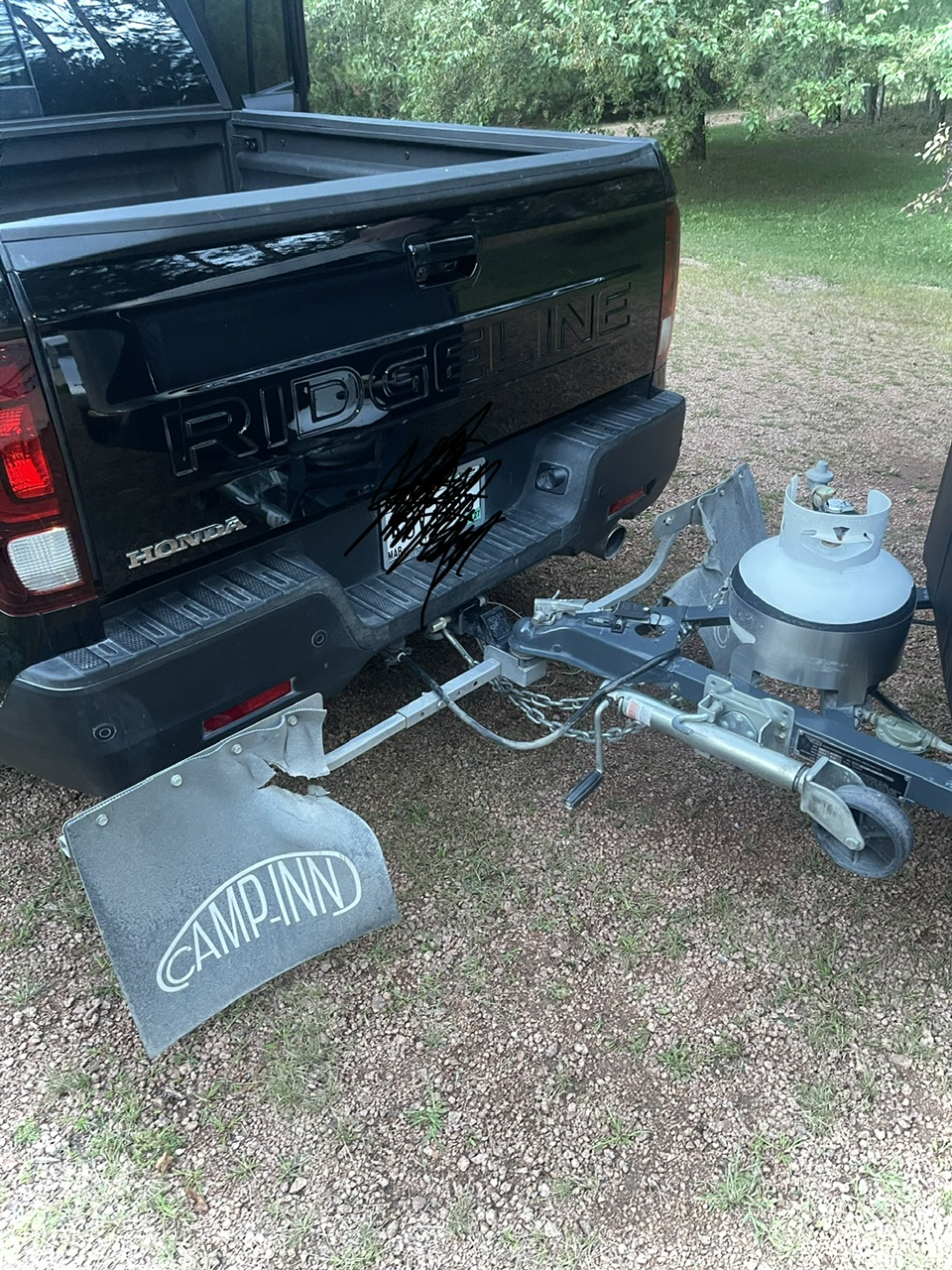

I needed a longer ball mount and bought a
Brophy Ball Mount - 3" Rise, 4" Drop - 14-5/8" Long - Aluminum - 8,000 lbs
(From etrailer) The Campinn mud flaps do not work with it though.
The mud flaps seem to help from poking any holes in the bumper. With the short hitch and small trailer it is easy to quickly get the trailer turning into a jackknife. I notice it takes a quick recovery turning the steering wheel to follow the trailer. I will agree forward turning radius is greatly reduced.
Dual exhaust poked some nice holes in the flaps but they still keep the rocks down …. Yep driving across South Dakota in 100 plus heat will melt them!
