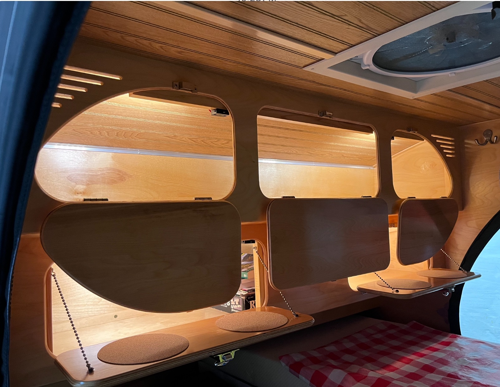

We often need a flashlight to find things in the cabinets, so I installed LED lights. Its been a great improvement!

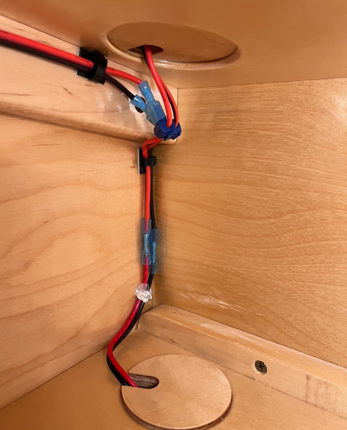

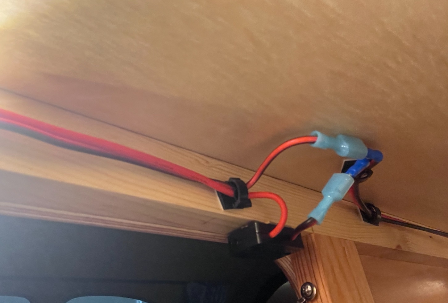

They turn on individually. There is a little door switch in each cabinet door corner. Short adhesive strip of 6 LEDs above each door. I powered them from the 12V socket under the cabinets. That way I can always unplug them and it avoided drilling through the wall. I used T-connectors, similar to what Campinn uses. And adhesive wire clips from Amazon (black ones in the picture). They have held for 12 months so far.
