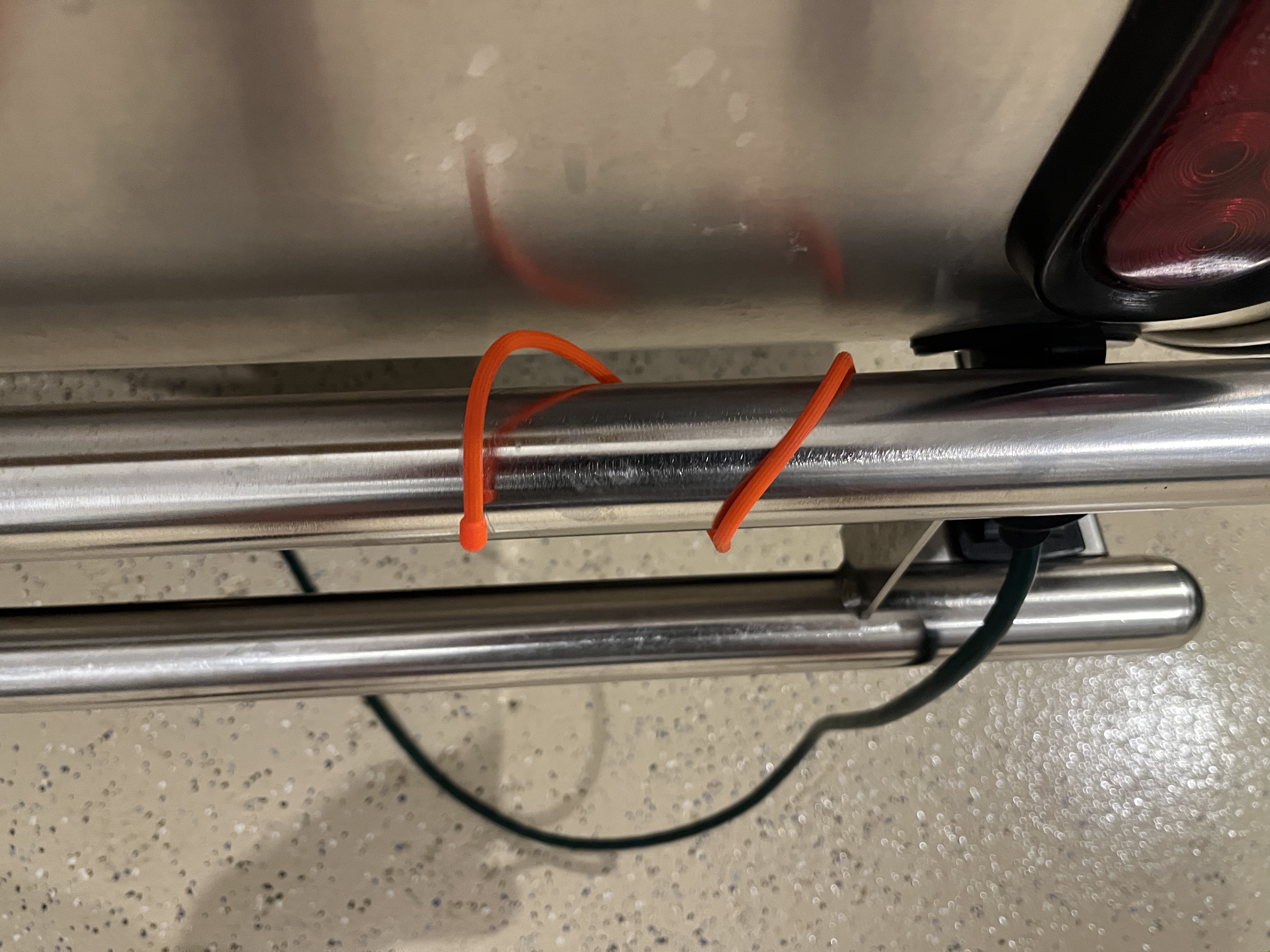

    We use an orange twisty tie (purchased at Home Depot, hitting blank on proper name) to wrap around the ratchet and extension shaft, which stores nicely in the front storage compartment.
    When we lower the Jack, we wrap the orange twisty tie around the bumper, on the side the jack is down, as a reminder not to forget the jack is down.

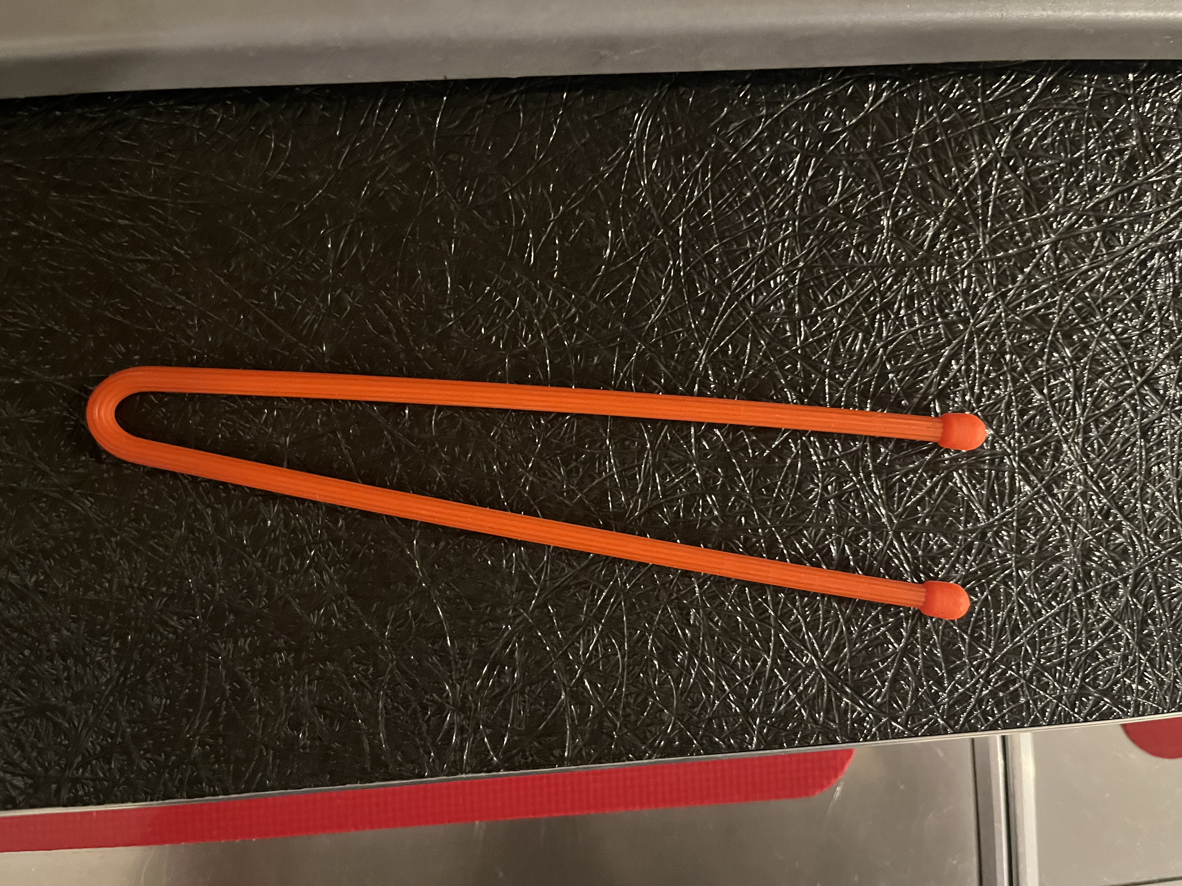

    Something like this? Have been given quite a few over the years.
  17. Steve & Betsy
    Steve & Betsy Novice
    Like these. They make different sizes and colors. Also work great for taking up excess Dometic cord, strapping garbage bag to bumper on a windy day, tying the Lucilight (sp?) to the propane tank, etc.
    Sweeney and Kevin like this.
  18. Lipster
    Lipster Junior Ranger
    I've seen these, but can't remember where. What are they called? Anyone know?
  19. SethB
    SethB Ranger
    Those are Nite Ize Gear Ties, available at Home Depot, Amazon, REI, many other retailers in various sizes
